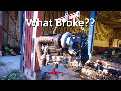

          Well. Spoiler alert!
          I already pulled the engine:
          And tore down the engine. Number 1 and 5 pistons had cracked ringlands. No signs of piston rings binding so rising the boost at max torque point was what killed the engine. Too much cylinder pressure for the stock pistons. The stock pistons seem to handle about 600nm of torque. The 1.1-1.2bar of boost is 700nm or more which was too much.
          Otherwise engine was mostly ok. No scratches on the bores and bearings looked normal. Only few had marks of some piston fragments going through the bearings.
          Should be easy rebuild and I have already started gathering parts, now that I know what I need to get.

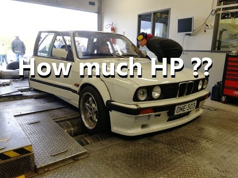

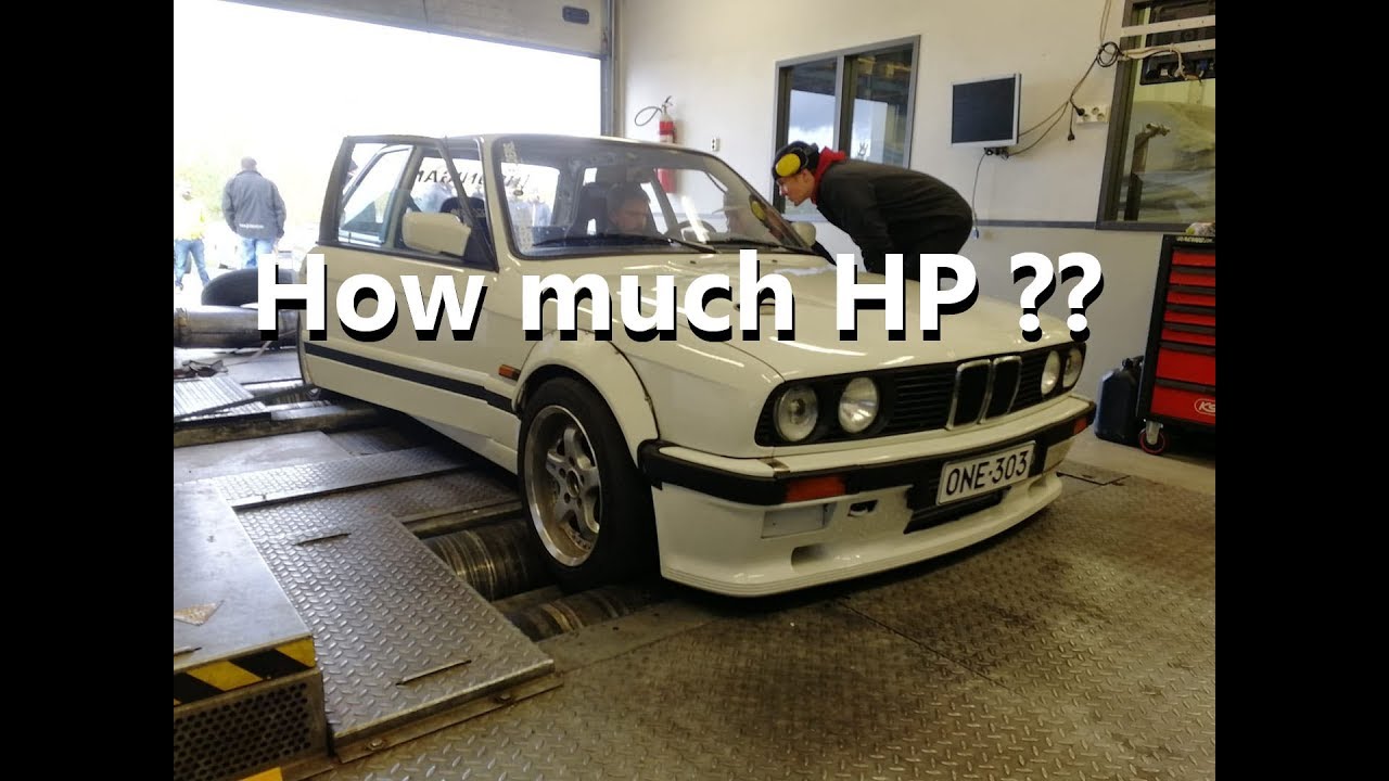

                We also took the ONE for dyno:
                https://www.youtube.com/watch?v=OD3zlwrN3B4

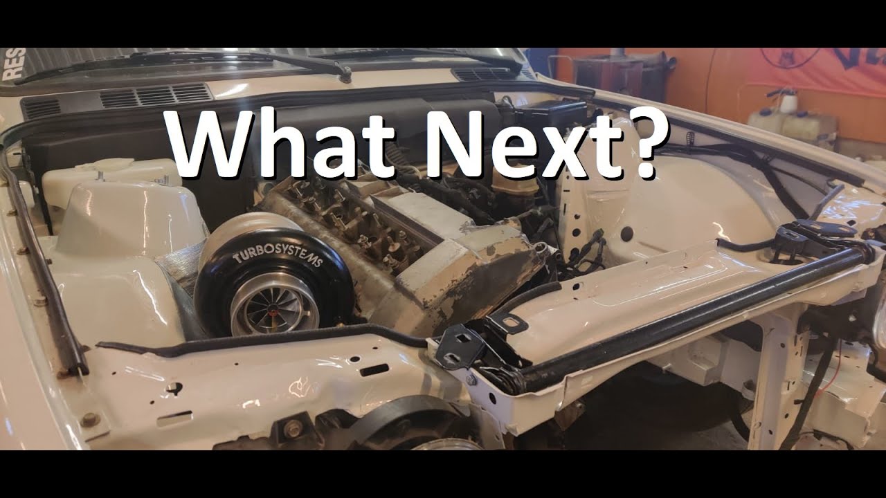

                          Then Petri also started making new exhaust manifold. With equal length primaries hoping for nicer sound.
                          And also to make the turbo sit lower and not peak through the hood:
                          Exhaust manifold getting finished:
                          Petri also decided to upgrade to this "Holset":
                          To be exact that's only made on Holset base, but has some nice features like extended tip billet compressor wheel, water cooled core, ceramic ball bearings and stainless steel twin scroll exhaust housing with V-band connection. Model: HTX4064B1.
