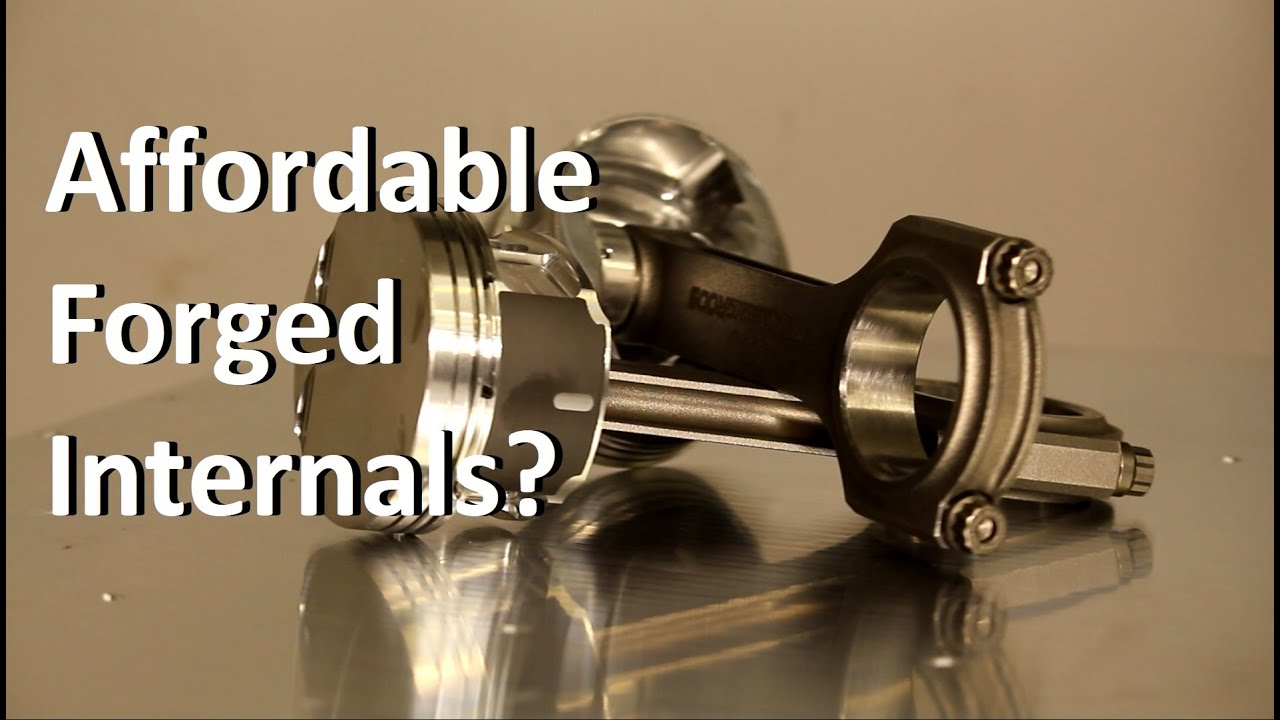

      Got myself new forged pistons from amp44:
      Main reason being that those are about half of the price of know brand ones. But after having those in hand, there doesn't seem to be any problems those being so cheap. And as you can see from the label, these are m54b30 pistons, because the manufacturer didn't have other m5x pistons available at the time of purchase. But if someone is interested, they should have m52b28 pistons soon and m50b25 ones bit later.
      And no I'm not going to upgrade to b30 crank, so I got those maxspeeding rods in 140mm size. Luckily those fit nicely to the pistons:
      This will give me better stroke to rod length ratio and less stress on cylinder walls than with 135mm connecting rod. And compression ratio will be about 12:1. Can sound high for turbo engine but, with only e85, it shouldn't be problem. But the pistons comes higher than normally, so I will probably need to make the valve reliefs bigger and that will reduce the compression ratio closer to 11:1
      And you might have noticed that those are oversize pistons. So I dug up my spare block that had corroded cylinder walls. And took that to machine shop to be bored to oversize and decked. Well that didn't go well...
      But some time later, it's fixed and pistons fit the bore:
      Time to take the stuff to our garage, and start cleaning the block. After few hours it's looking much better:
      Crank fitted with new bearings, clearances checked and new girdle installed:
      If someone needs, I have the cad files for alu and iron block girdles here: https://drive.google.com/open?id=0B2...DBnREFraHRDZ28
      And the pistons comes pretty much level with the block surface as I calculated:
      Time to measure valve clearances:
      And not good:
      So next up I need to make the valve reliefs deeper. In the meantime, here's video of those forged internals:
