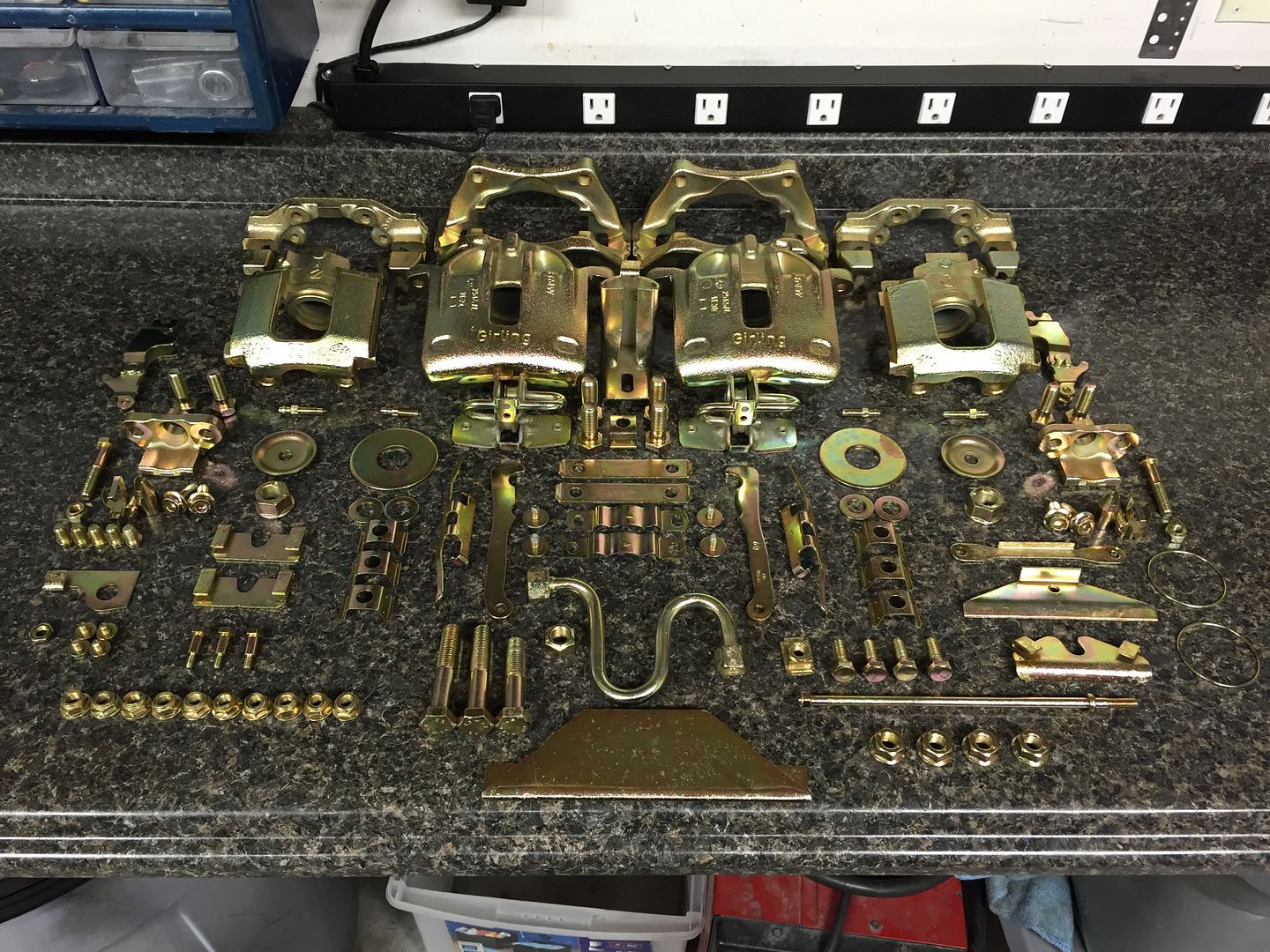

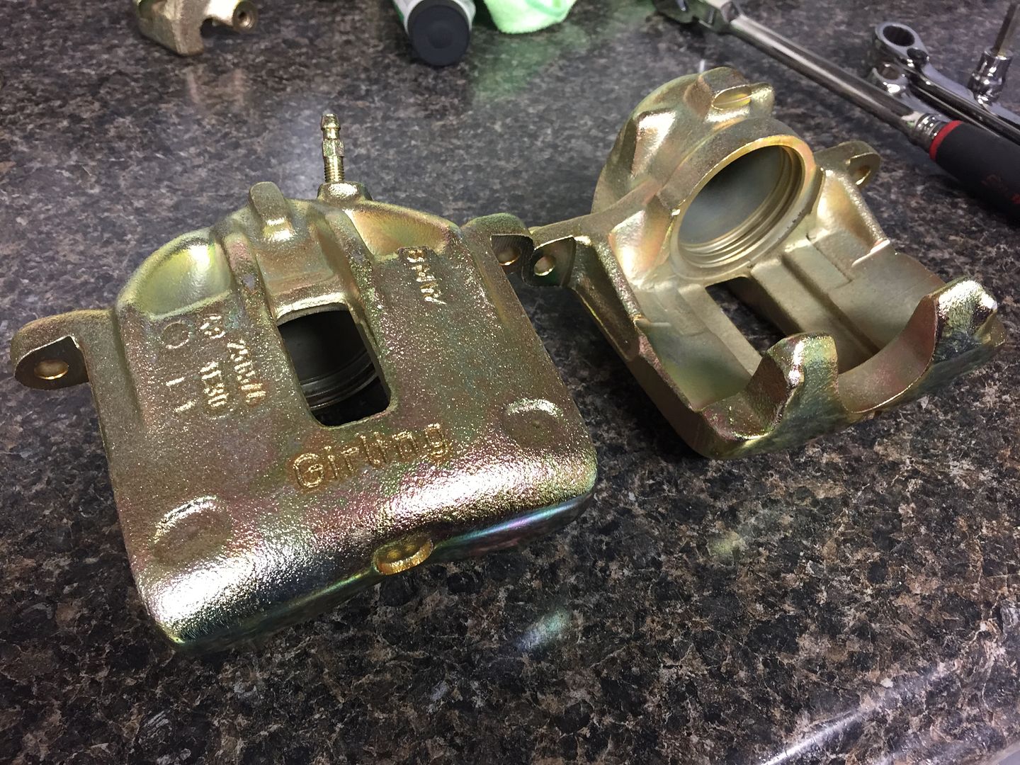

The plater called, all my parts are ready!!!!1111one.
I can't wait to get them this afternoon and see how they came out.Tenured Automotive Service Professional - Avid BMW Enthusiast
Vapor Honing & E30 ABS Pump Refurbishment Service
https://mtechniqueabs.com/
The parts look amazing, they turned out better than I had hoped. Truly a beautiful sight to see an assortment of hardware like this wearing fresh yellow zinc chromate. Almost a shame how much of it will be seldom or never seen once installed in their final locations. None the less worth every penny of the $60 it cost to have it all plated.

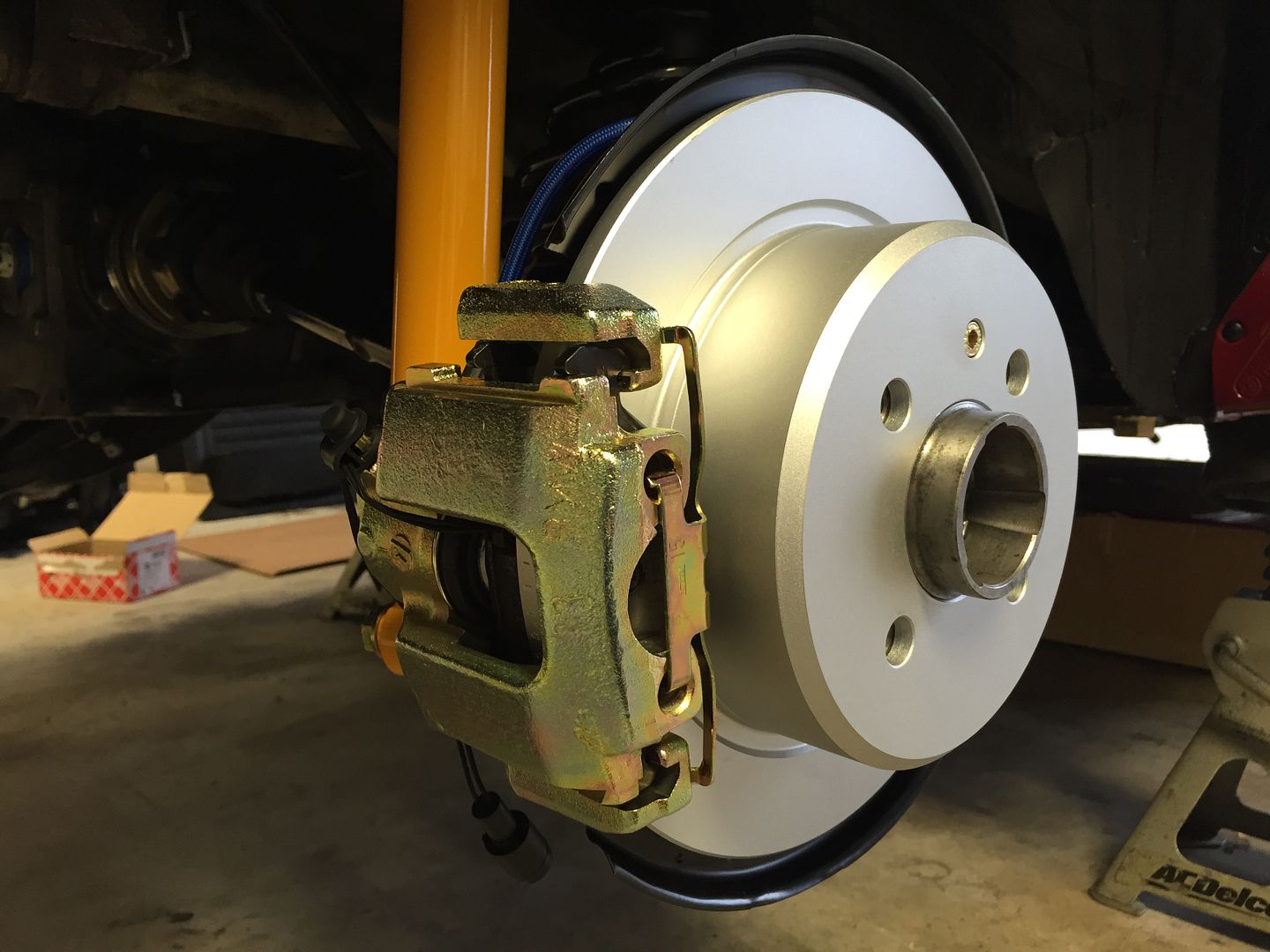

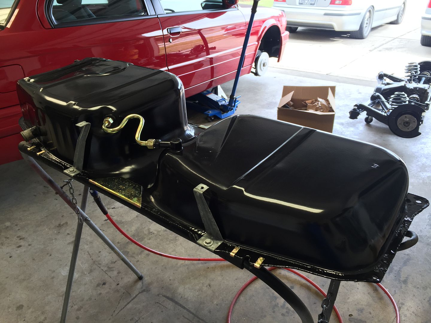

I got a late start today so I didn't get as much done as I wanted to... but plenty of progress none the less.
I installed the mounting reinforcement plates onto the fuel tank, the crossover pipe and both galvanized drop mounts for the heat shield before installing the assembly back up into the car.

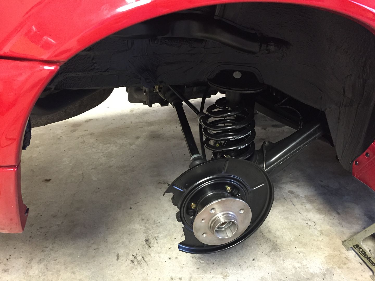

Next would be the rear suspension assembly, which installed really easily poised on the jack.

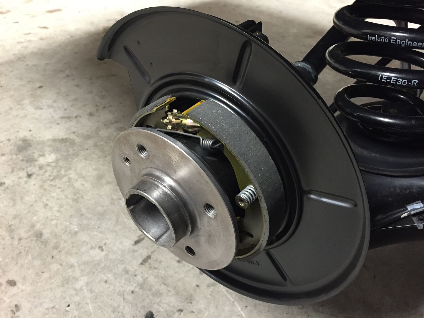

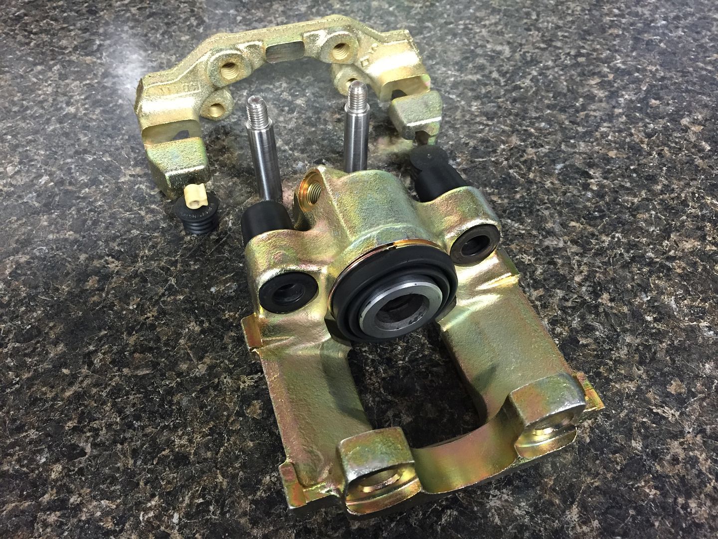

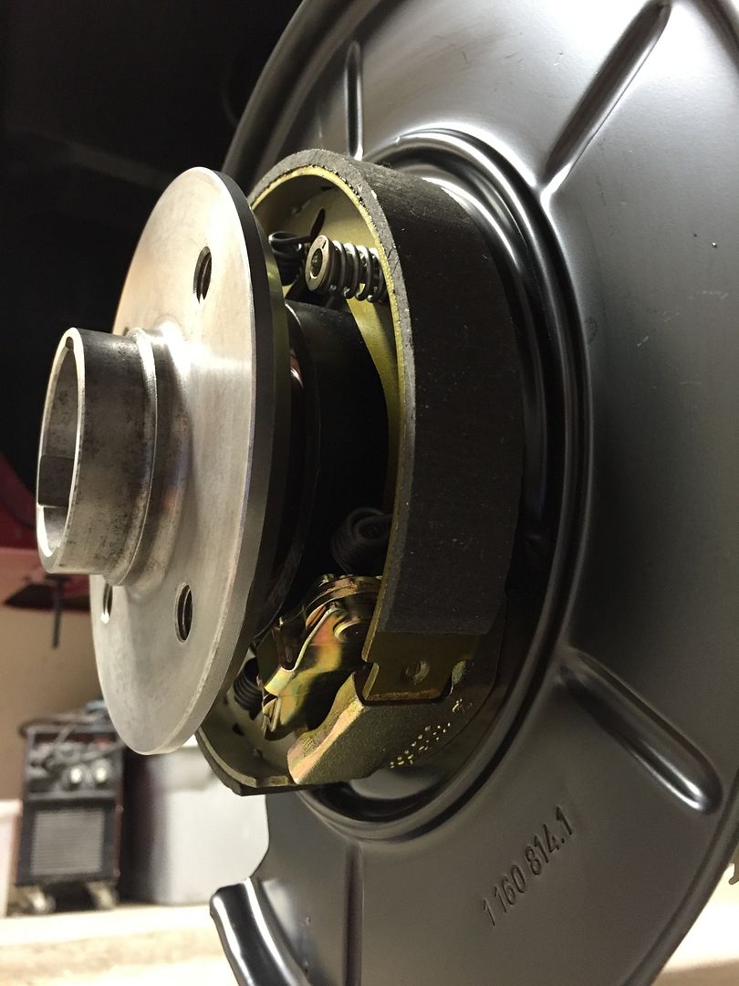

Lets get all that new parking brake hardware installed.

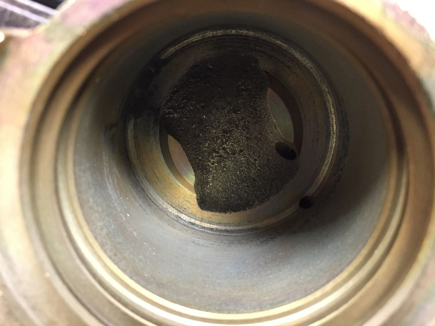

Reassemble a rear caliper
I wasn't able to finish the other rear as I slipped when installing the circlip and ripped the dust boot. I'll need to buy another.. oops.

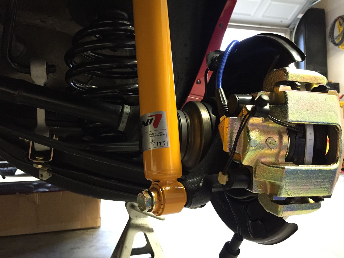

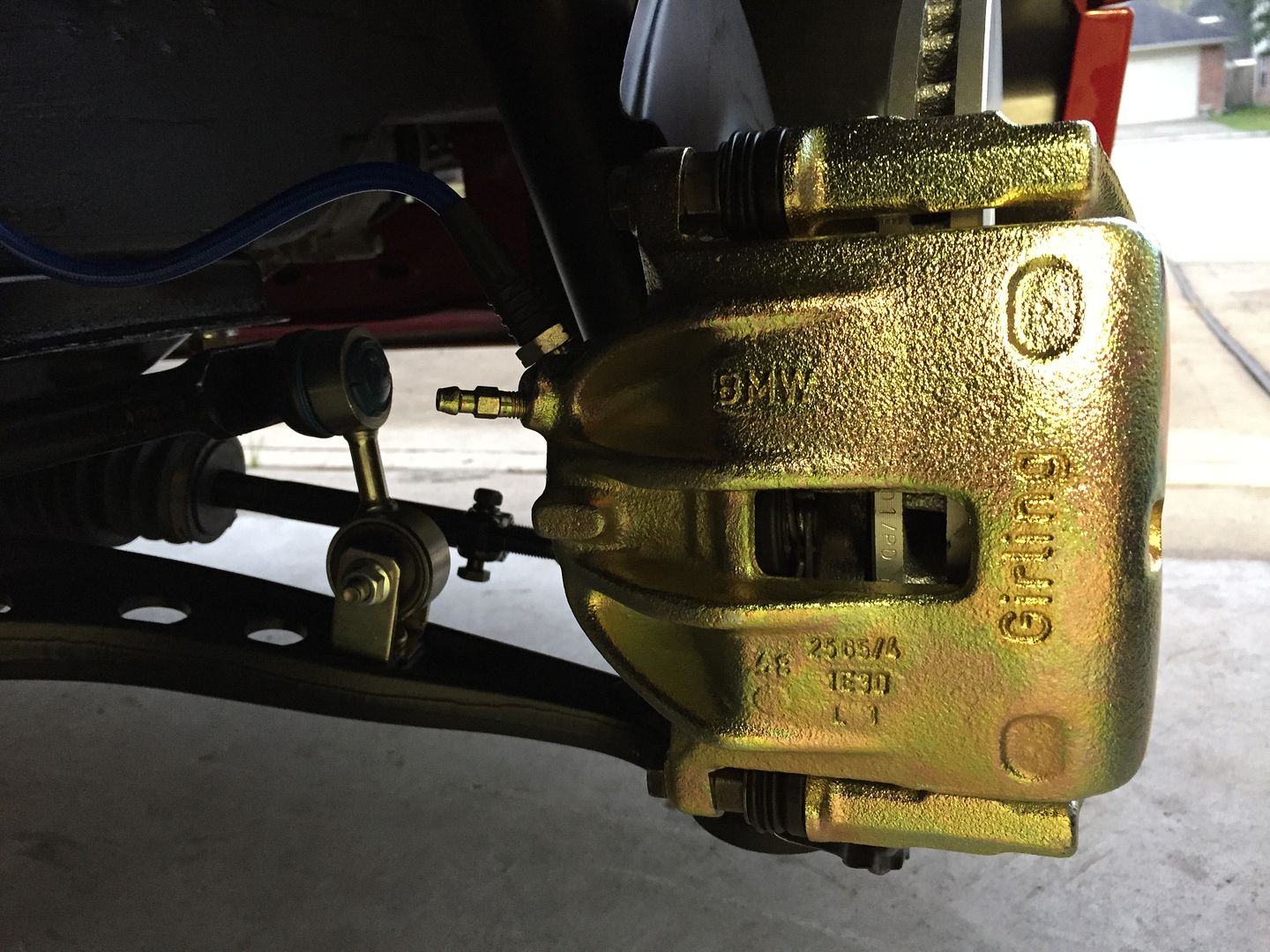

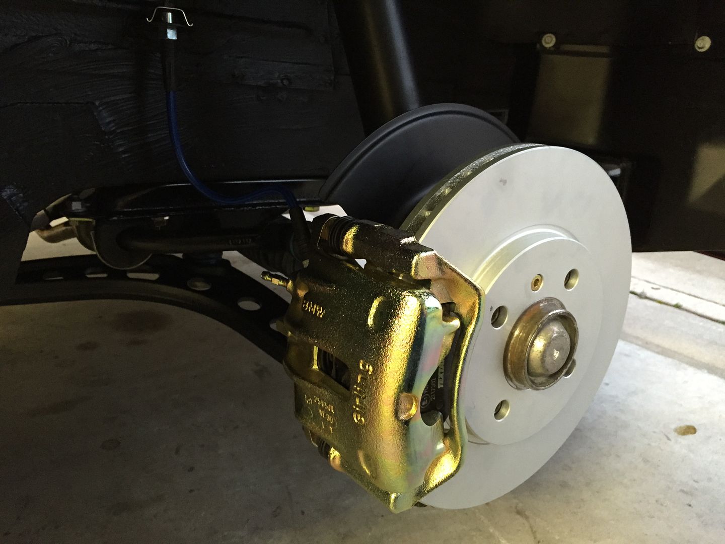

and then the fronts

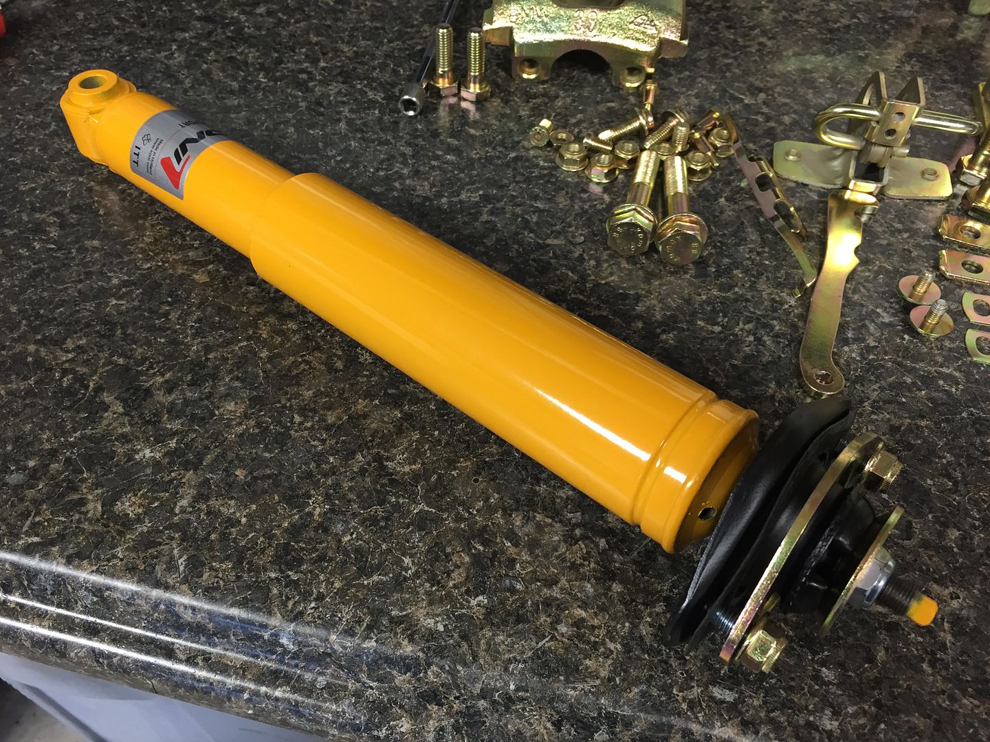

Koni SA with Meyle HD RSM, and Z3 reinforcement plate

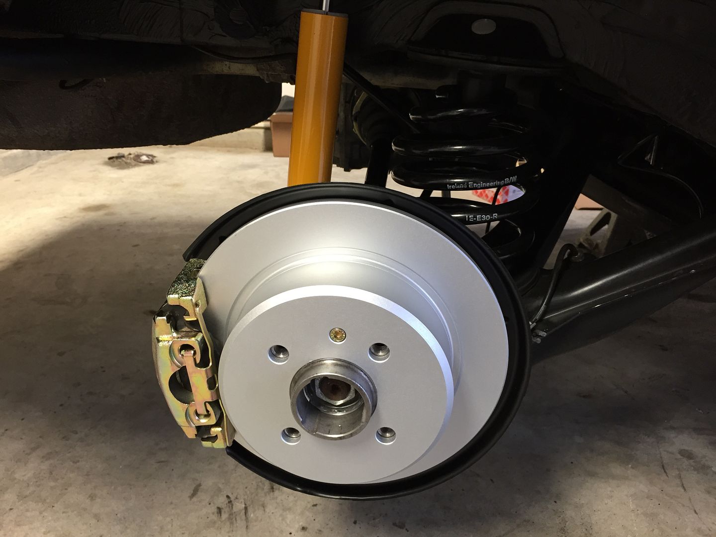

Right rear corner all done!
Right front all done!

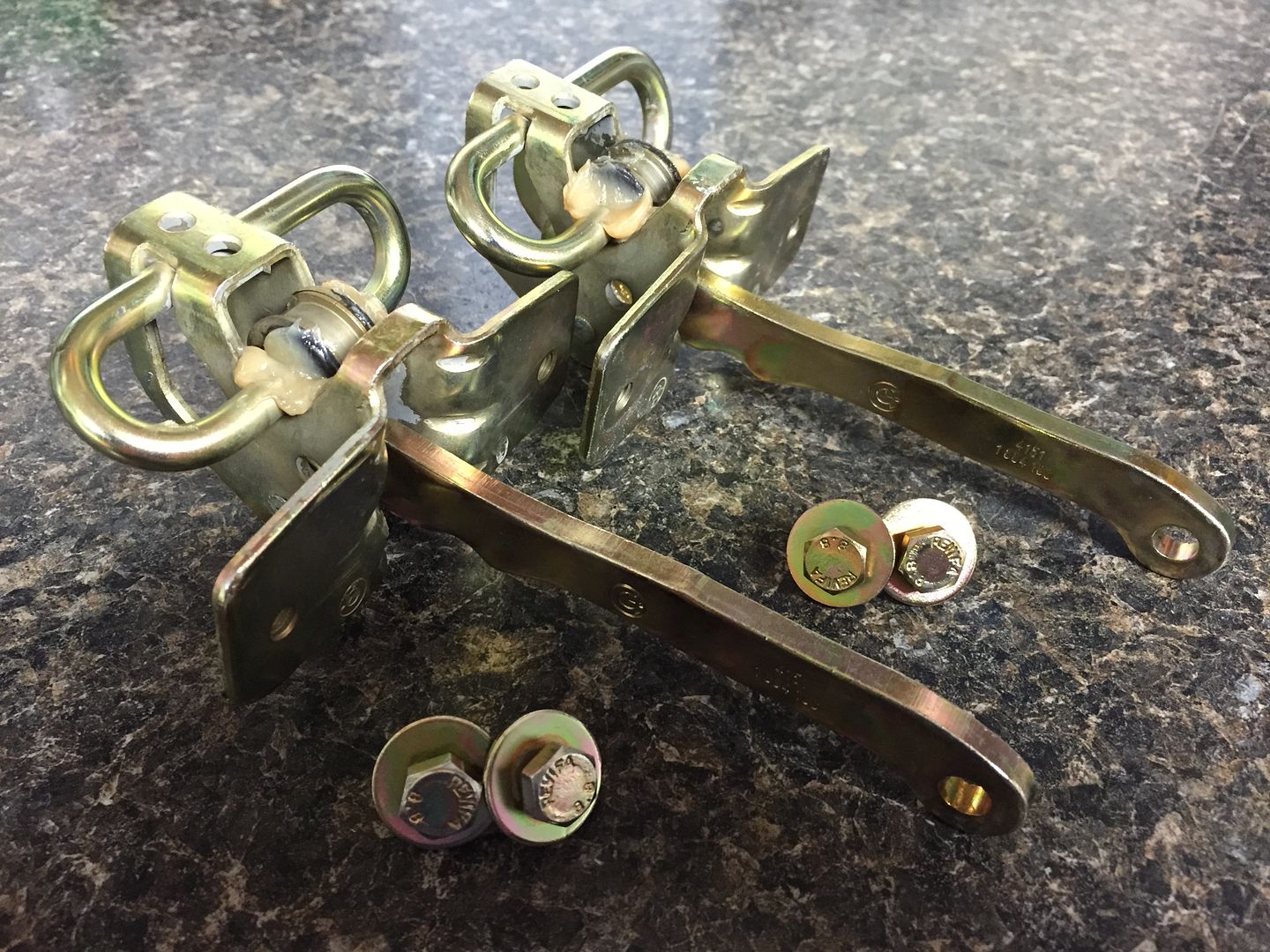

Door brakes and mounting hardware reassembled and greased. Wasn't able to install them today though as I can't find the little rectangular rubbers that go over the door brake pin in the jam.
