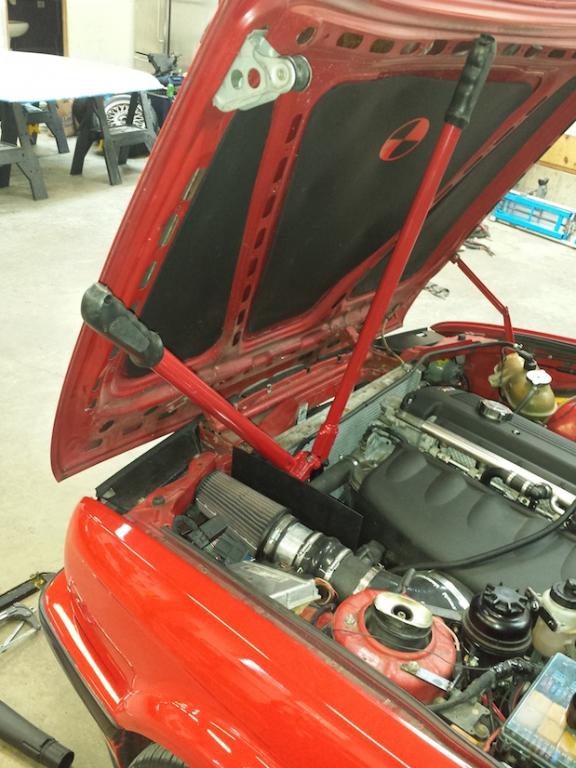

    Vehicle is a 1990 325ix sedan. BrilliantRot. Manual. I will put up a few poser pics here at some point in the near future.

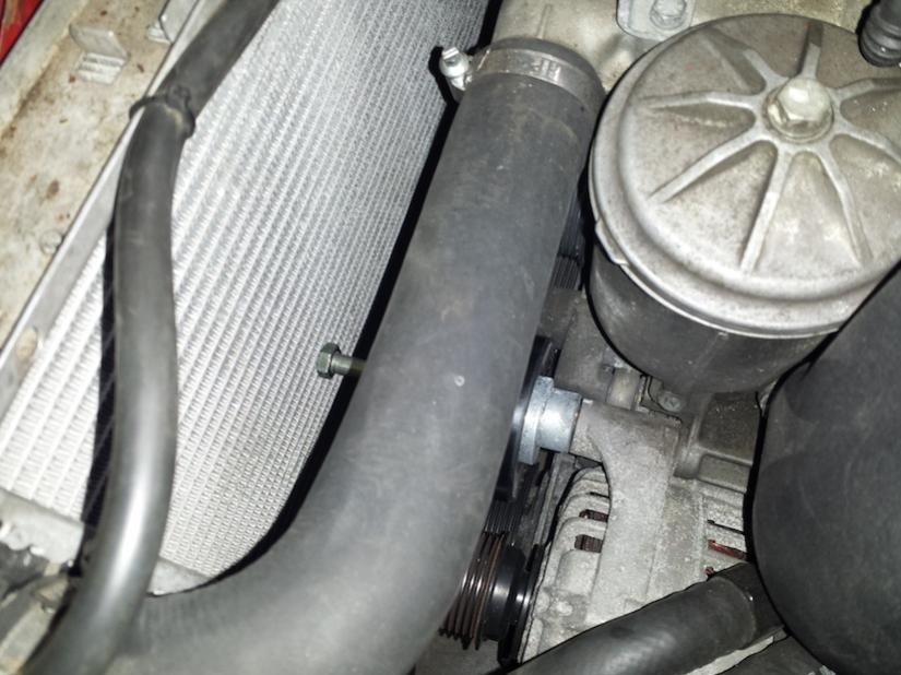

    The main belt tensioner and/or idler were making some noise so went to replace them and the main serpentine belt. The tensioner was simple.
    Ran into a little issue with the idler, though. The bolt for the idler is long and also mounts the alternator and it couldn't be removed without dropping the coolant and radiator.
    Didn't want to do that, and wanted to make it easier for the next replacement, so resorted to a BFBC.

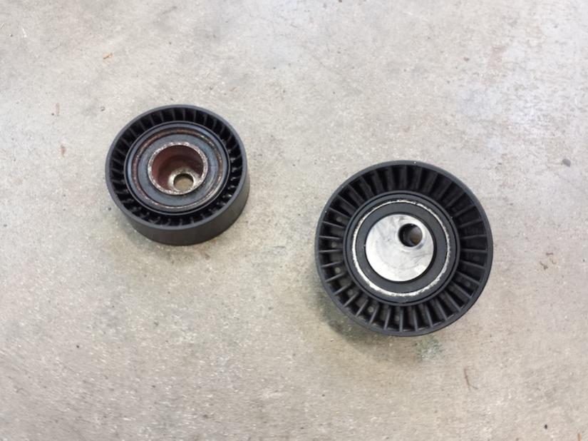

    Pic of old tensioner and idler. They were pretty worn, maybe original. Replaced the upper alt bolt with one about a half inch shorter, so now the idler can be replaced by unbolting the alt and tilting it sideways. Things are much quieter now.

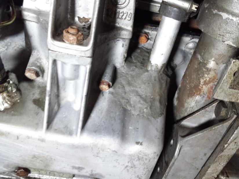

                              Was crawling around under the car doing some other stuff (posts coming up) and got a look at the pan. I'd heard that Jake forgot the dipstick tube at first and had to go back and put it in. I guess that's a wad of JB weld... a bit ugly?
