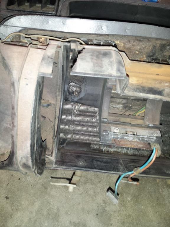

    After pulling out the heater box, looks like a previous blower motor fan exploded on the passenger side or something. OEM replacement covers are available but also on national back order, and I don't feel like waiting another 3 weeks before putting things back together.
    Anybody got a recommendation for how to fix the plastic cover? Duct tape? I was going to try to glue a patch on, and maybe "weld" the edges a little bit.

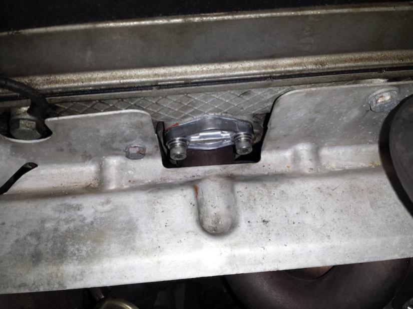

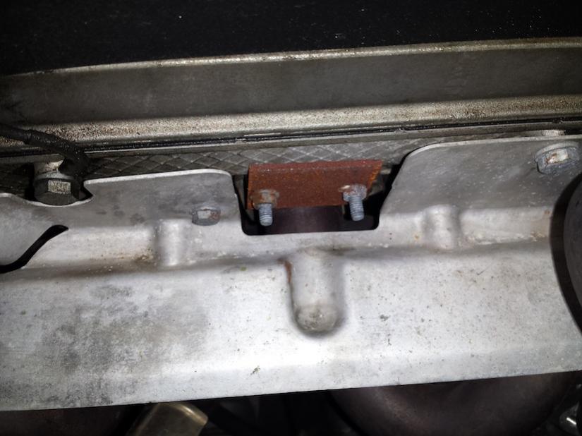

      Air pump block off was perfectly good, but wanted something that looked a little nicer:
      With the OEM block off plate:
          [ATTACH]102755[/ATTACH]
          [ATTACH]102756[/ATTACH]
          the little stuff ALWAYS makes a big difference. keep it up :up:

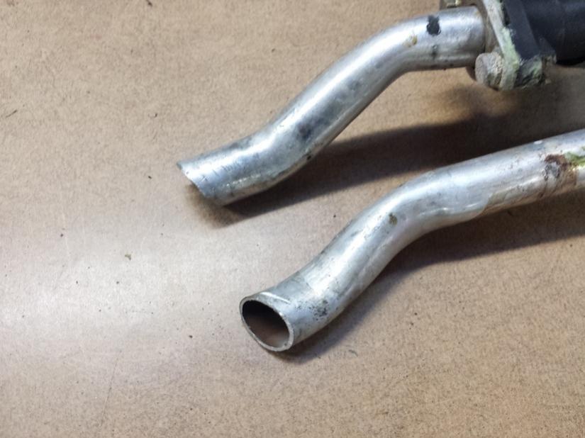

            Possible source of the DS interior leak... when the metal heater pipes were cut for clearance, the bead was not restored. These pipes fit *very* loosely in the rubber hoses.
            These were secured with hose clamps, so not sure if they could've sprayed coolant into the interior, but definitely possible.

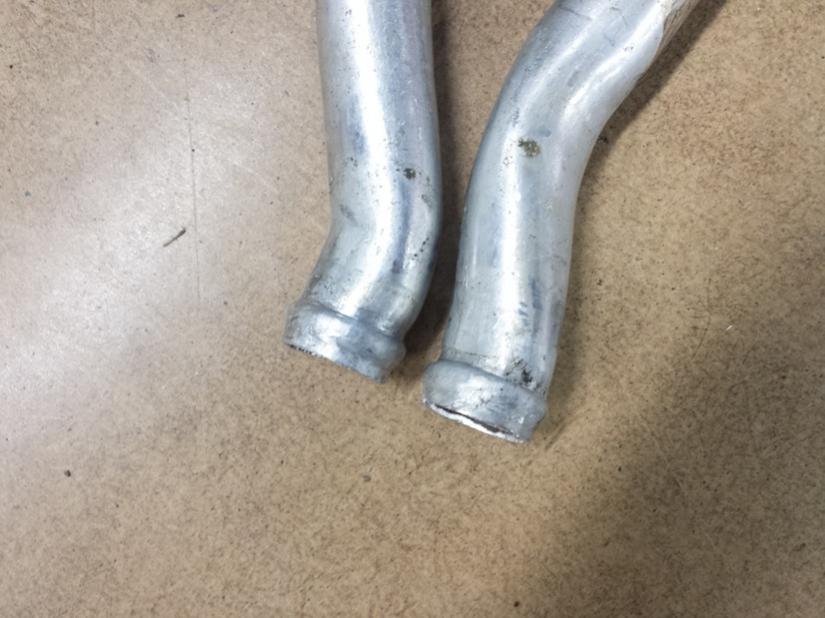

            Cuts evened out and beads restored with ghetto beading tool. Rubber hoses fit much tighter.
