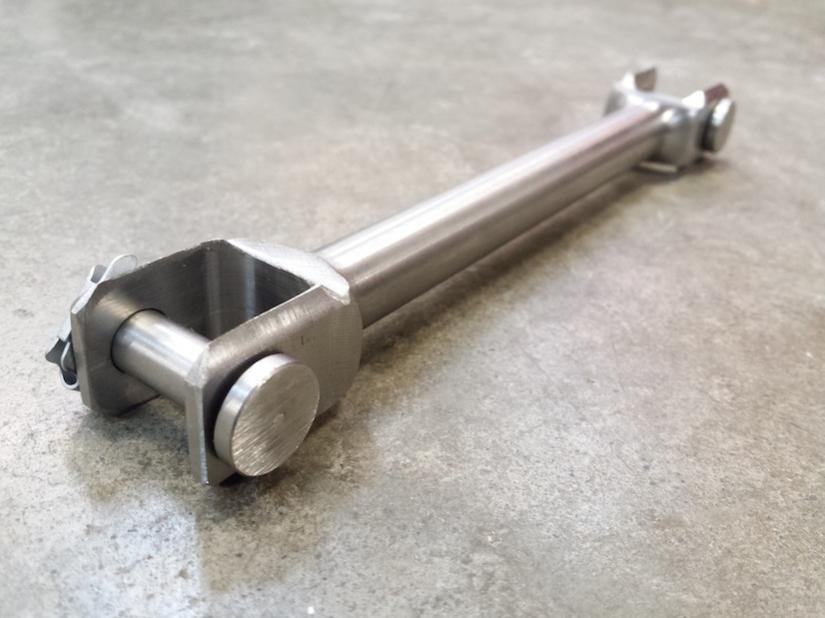

            The selector rod for the iX is ~5mm longer than the "regular" E30, but UUC doesn't make one for the iX. Others have had the "regular" DSSR lengthened to accommodate. I went with the DSSR that UUC sells for the E36 which is 2mm longer (189mm vs 187mm) and hoped it would work without lengthening (all other dimensions are the same).
            On the plus side, my new DSSR is machined differently from older versions so it needed very little grinding. Here's pic comparing the older version with a stock selector rod (the right side of the DSSR in this pic has been machined):
            Originally posted by nando
            And here's the new version. You can see how the ends are completely different.

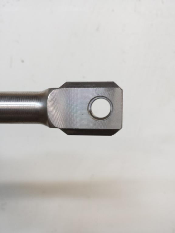

            Very little grinding required. Here's a side pic of the end before grinding:
            And here's a side pic after grinding:
            And another POV after grinding:

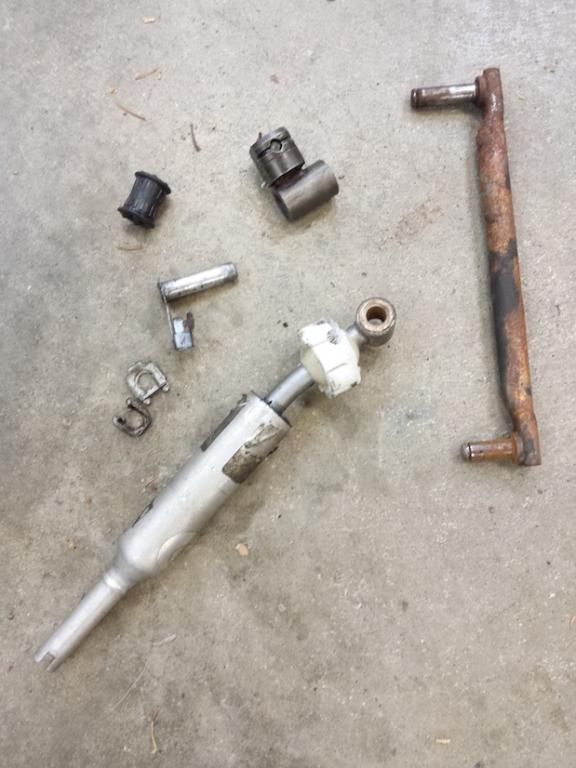

              After the grinding/filing, it was pretty much just putting everything back together. Here's a pic of all the old parts:

                Cool! Did you have to clearance the shift carrier at all? I had to as I don't think I could get into 3rd or 5th if I remember correctly, the top of the DSSR was hitting it. But now that it is machined "flatter" than the one I have, maybe it's not an issue.
                Good call on the E36 DSSR. I thought of doing something like that later but since I really didn't know if it would work at all, I just bought it and made it fit. 2mm shouldn't make much difference.
                Build thread
                Bimmerlabs
                • Kershaw
                  • 11822
                  You know, I didn't clearance anything with a file when I installed my DSSR. No issues. I did use the IE DSSR, but it looks the same.

                      I think it's because of the flatter, non-rounded shape on the top and bottom. if I remember that's where it hit my shift carrier on the original DSSR.

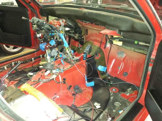

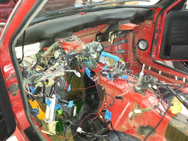

                              So while I was waiting for the rear shift carrier support to show up I got into the interior a bit. It was swapped from tan to black and was serviceable as expected, but came across a few things I'd like to change:
                              Both front seats were passenger side seats. Not a huge deal really, but it was just kind of eating at me. Got a tan driver-side seat and planning to recover both.
                              The rear seat bottom doesn't fit. It has a spring bottom, not foam, which I understand is from the earlier E30s. It just sort of sits in place, unattached, and jiggles loose over time. I got a proper foam seat that fits from a local member.
                              Found some moisture under the front driver side carpet - guess it must be coolant. The foam under there was pretty wet and I couldn't let that go. Carpet was OK but not great, so... got a new OEM carpet.
                              After the carpet showed up I wanted to replace it "the right way" and not cut around the heater core. So, started ripping things out. Here's where it sits right now:
