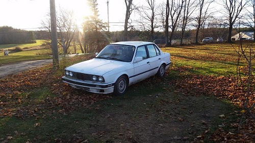

    Hey! I want to make a introduction I guess. So I' am 20 and in college, so best that I go off and get 318i for $250 that doesn't have compression. I mean absolutely none across all 4 cylinders. If everything hasn't eaten itself and I can some how get it running. I' am going to RallyX it
    It turns over and doesn't sound like the engines trying to eat itself, which I guess is a good sign. When I got it home the first thing I did was take the plugs of and put some oil in the cylinders to see if the rings or the cylinder walls might be complete garbage, but that still made no difference. Next step I wanted to see if I even had valves, By that I mean did they come in contact with the cylinders and get obliterated.
    So I took off the the throttle body, intake, and what ever the last piece is that the fuel injectors are connected to. If you know the actual name for that please tell me cause I hate calling it "that thin". When I took everything off I was able to see that yes in fact I do have valves, Intake valves at least. the valves though do not close all the way so that's where my compression is going.They don't look jacked up, I' am just hoping they are not bent, but how would they have gotten bent if the timing chain is good and tight? Could the lifters have crap in them maybe the guides are gummy too, not allowing the valves to close?
    Tonight I' am going back home and I will be taking the head off. Everything should be pretty clear then. I will keep you updated and i hope everything works out okay, but hey $250.

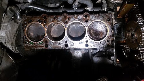

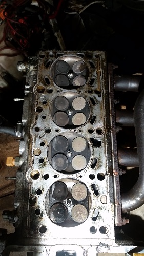

                  So I got the head off. The intake valves did make love with the pistons. The exhaust valves didn't hit the pistons and with a visual inspection they look okay. The pistons are okay except for the little marks from the intake valves. The cylinder walls look really good almost like they got honed. I' am hoping that the guides for the intake valves are okay.
                  So I' am thinking that someone had this engine apart maybe replacing the head gasket or something. Then when they went and put it back together they put the intake cam in the wrong position. Who knows maybe the exhaust cam is off too, but just not enough to have hit the pistons. I mean that sucks for who ever did that. But I can not think of another way that would have happened because timing chain?
                  Now I need to know how how I can get the timing back in order? In the pictures you will notice that the engine is not at TDC. This is because I rushed into things and forgot to put in at TDC, but don't fret the engine hasn't moved. After I get the valves out of the head I' am going to put the head back on with the cams and put it at TDC. At least then I will have some point of reference. How can I get the cams back in the right position? Cause now even the mark I put on the cam shaft and gear is wrong.

                    Check the condition of all of the timing components, there are many things to go wrong. You need to find yourself an M42 service manual. Have a look around here: http://www.m42club.com/forum/index.php?board=12.0
                    As for aligning the cams:
                    See:
                    Also, upload your pics to a hosting service and use the IMG code.
