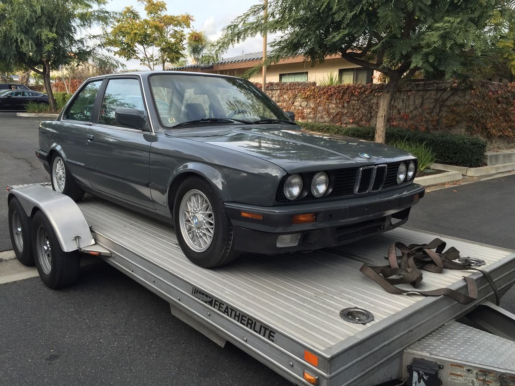

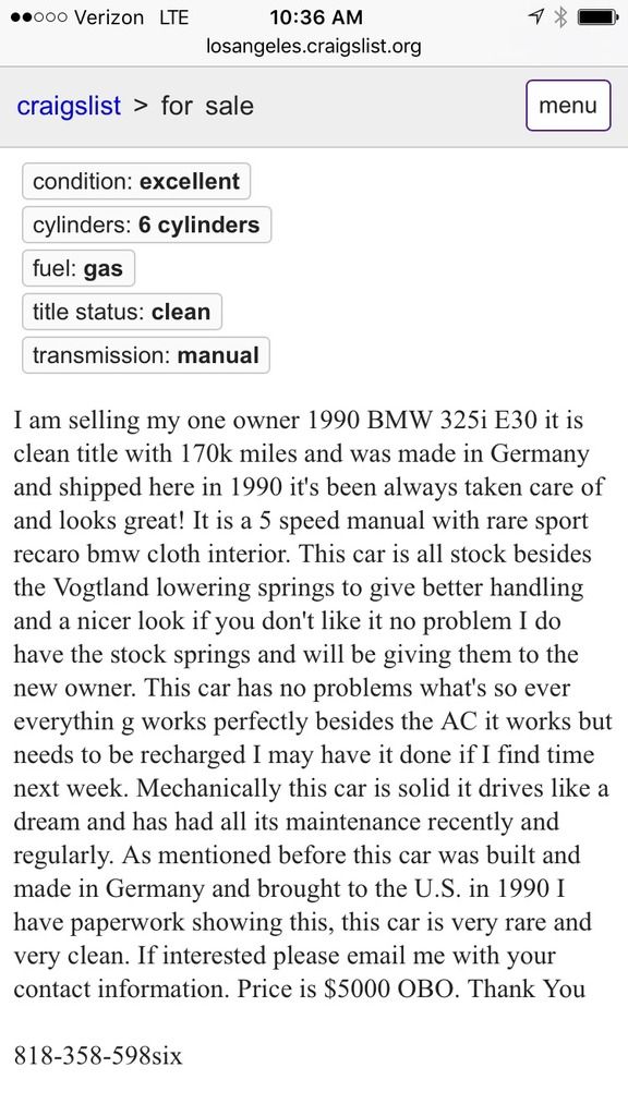

    In early October of 2015, I ran across this local Craigslist ad:
    I was very excited!! Looked like an awesome car... I immediately called the seller... Talked to him about the car for about 20 minutes on the phone and was reassured that everything listed on the ad was true and that he also had a carfax that he emailed to me. I made an offer, $3500...yes.. it was a bit low from his asking, but I knew he would counter. Well... he stood firm at $5,000 and said basically he had another higher offer on the table. So, I felt a little disappointed but decided that I'll just have to keep searching.
    2 hours later, he called me back and said if I am willing to pick up the car that night, he would sell it to me for $4,000. This was a Friday night, and I live in Orange County.... it would literally take 2 hours to drive up to North Los Angeles to get the car. I decided to agree and had my brother take me up to LA to see and pick up the car. It was 9pm when I first saw the car.... Yes... I was overly excited, the car was running, and everything looked decent. The seller seemed to be a young college student that had inherited the car from his father. He mentioned he had lost the pink slip to the car but had all the paperwork transfer info ready to hand to me (I actually got on the phone with his father and spoke to him to confirm this information). The Carfax showed no accidents and and two ownership transfers (originally from his Uncle, to his Father, then to him). All the maintenance records and paperwork he mentioned would be sent to me along with a missing fog light. The final item was the smog check that he assured me was done 4 months ago and passed.... but I would still need to get one because 3 months is the limit for smog checks in order to transfer title. So foolishly without seeing all the signs that told me I should have walked away, I trusted him and paid for the car, took the car into my possession, and took a photo of his ID.

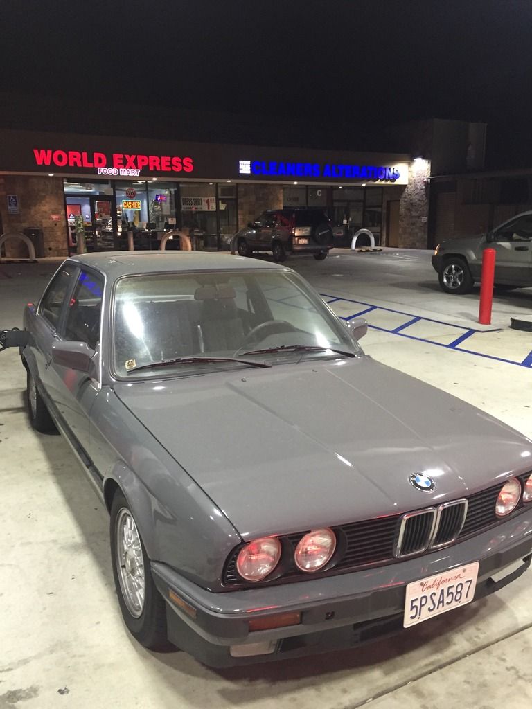

    I drove the car to the local gas station.... I was actually still so amped about finally owning an E30. I even took these two photos and posted it up on the R3V Facebook page while getting gas!!

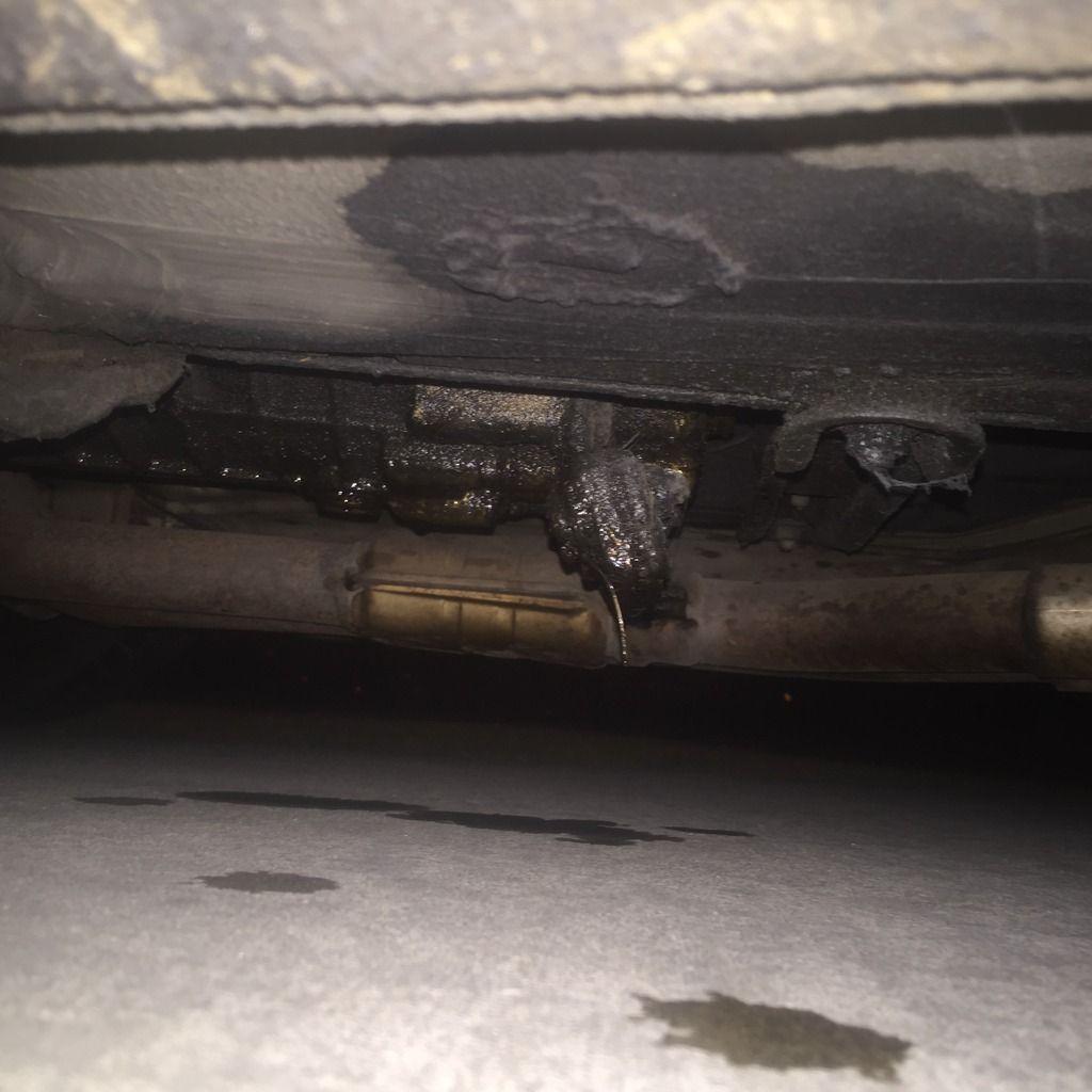

    That night, while on the freeway, I noticed the temp gauge was on high and the check engine light was lit... I texted the seller and he said the gauge was broken and the car is perfect. By the time I got home, the car was steaming out of engine bay and leaking.... I messaged the seller, and all he could say was that the car was perfectly fine when he had it. Well, I am sure you guys all know what comes next out of these stories....

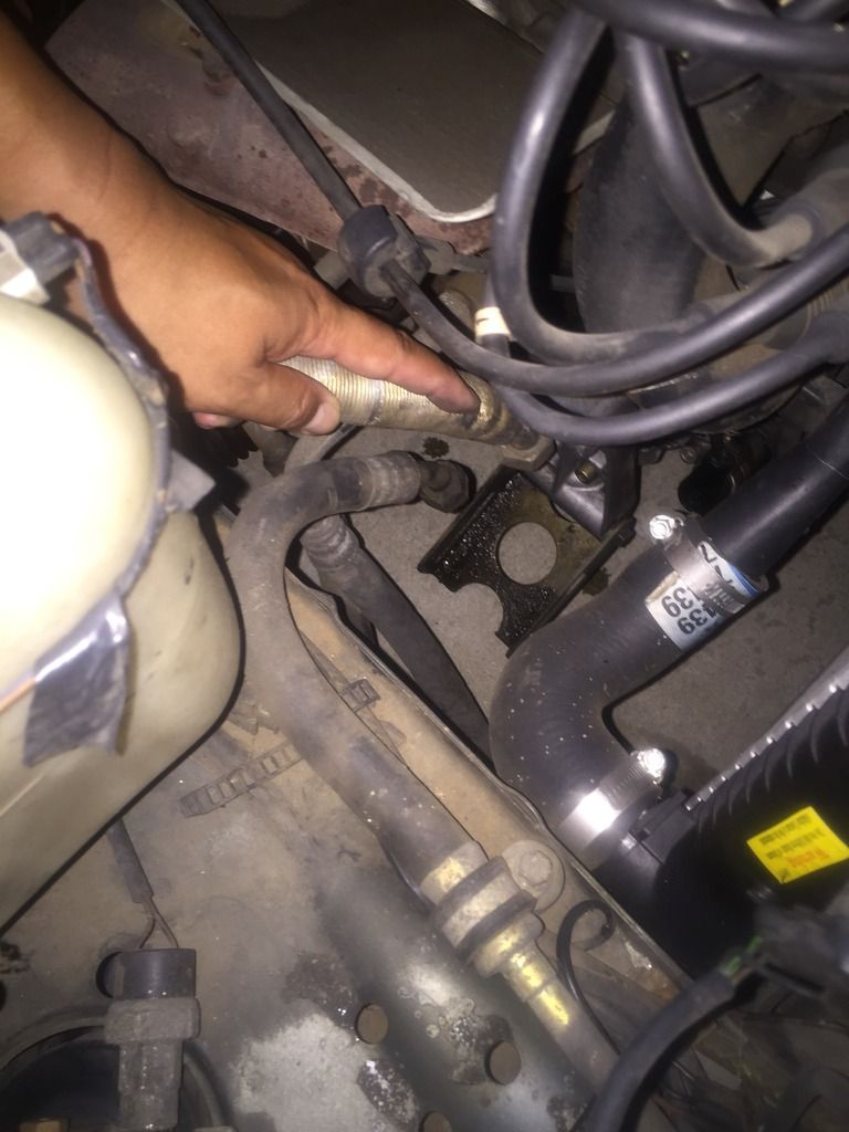

    The car is missing an AC compressor or AC unit... AC hoses are attached to... NOTHING
    Car is leaking coolant
    I also did my own full Carfax report...
    Car actually had a minor accident when it hit a fixed object.
    The following day, I towed the car to a family mechanic.... it was determined that the car had a blown head gasket. It would not pass smog and title could not be transferred. Brought this to the seller's attention and always got an excuse of why it happened. I tried to work it out with him after one week but it was going no where and I could have pursued ways to get my money back or what not... but I decided to just keep the car and the unresponsive seller would eventually get what he deserved from his dishonesty. He is actually a R3V member as well!!

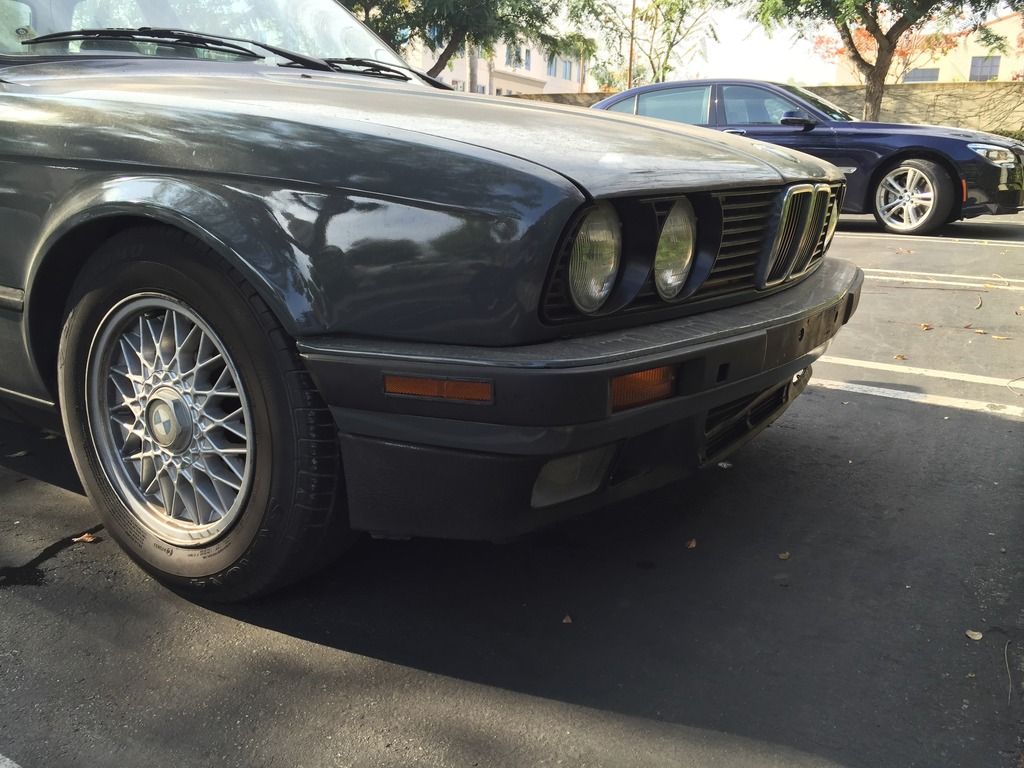

    Looks like a pretty clean car, interesting color, looks repainted? Maybe I am just unfamiliar with that color but, it doesn't look stock to me.
    Anyways, I would take the picture of the previous owner's license down. Sounds like he was a very dishonest person but, seems a little "eh" to post his driver's license up on r3v, especially after all your just went through over the last 2 months to get the title/transferred and such.
    Anyways, nice looking car. Can't wait to see the build!

      Took your advice.. took down the PO's ID.... =)

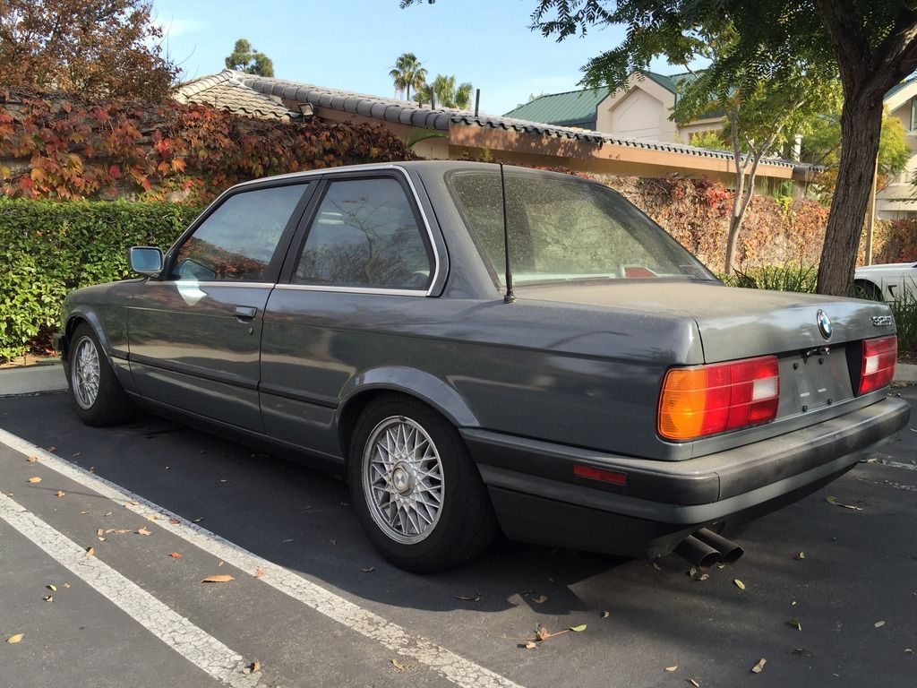

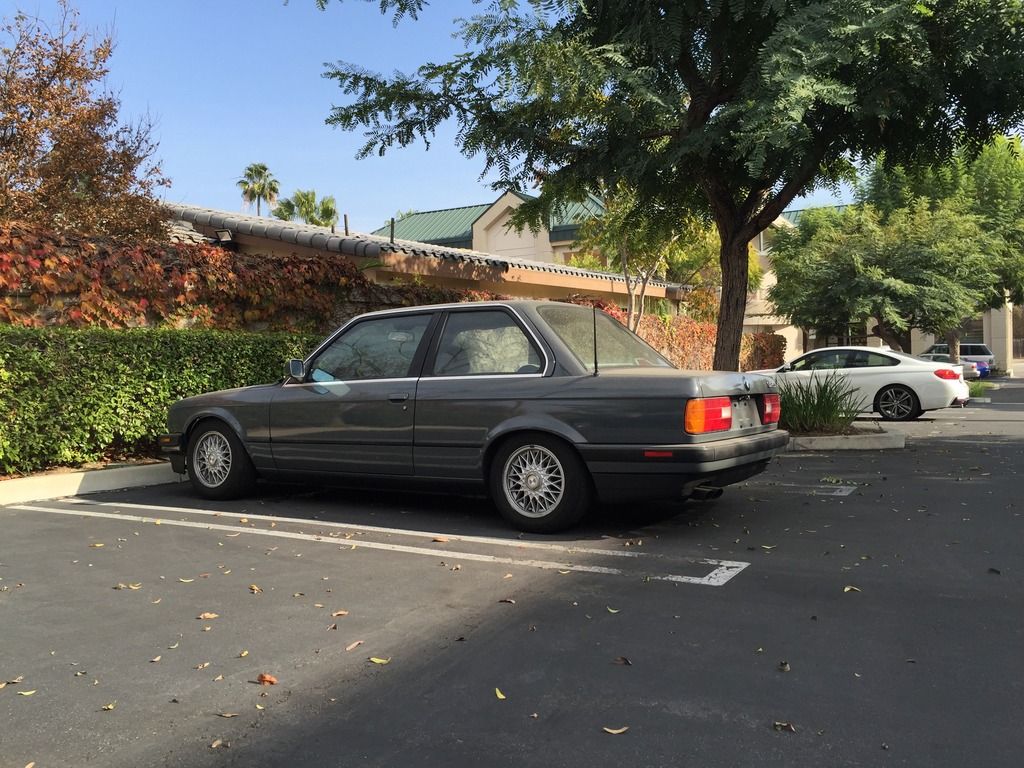

      The car body is in good condition fortunately. The car is repainted a flat cement gray color. The original color is Delphine Gray... which is the color in the engine compartment. The plan will be to strip the paint off anyways... it was a very poor paint job if you see it from 2 feet away... Car is very photogenic... LOL

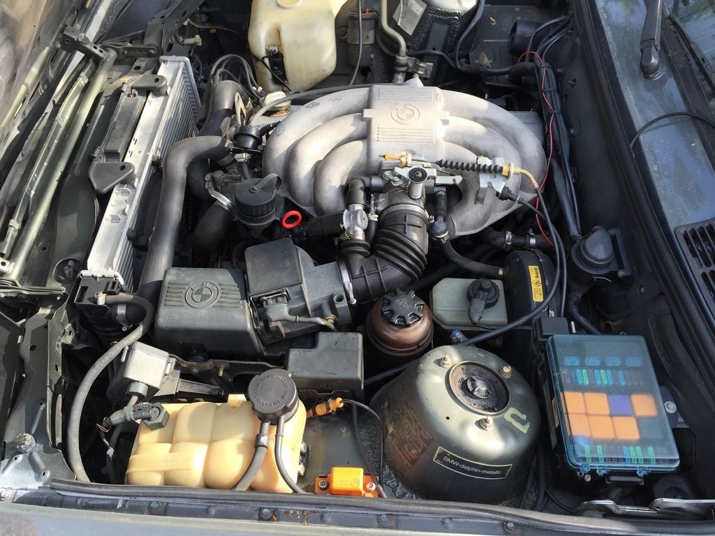

        I had decided that my first E30 would keep a M20 Engine and upgraded performance parts would be added to give the car it's own characteristics. My goal is not to restore the car to original condition, but to retain it's classic lines and overall design but to enhance the driver's driving experience. This car would be driven 2-3 times a week and would remain as an art piece in the middle of my interior design studio office.
        Here is the car as it sit's in the parking lot for over a month...

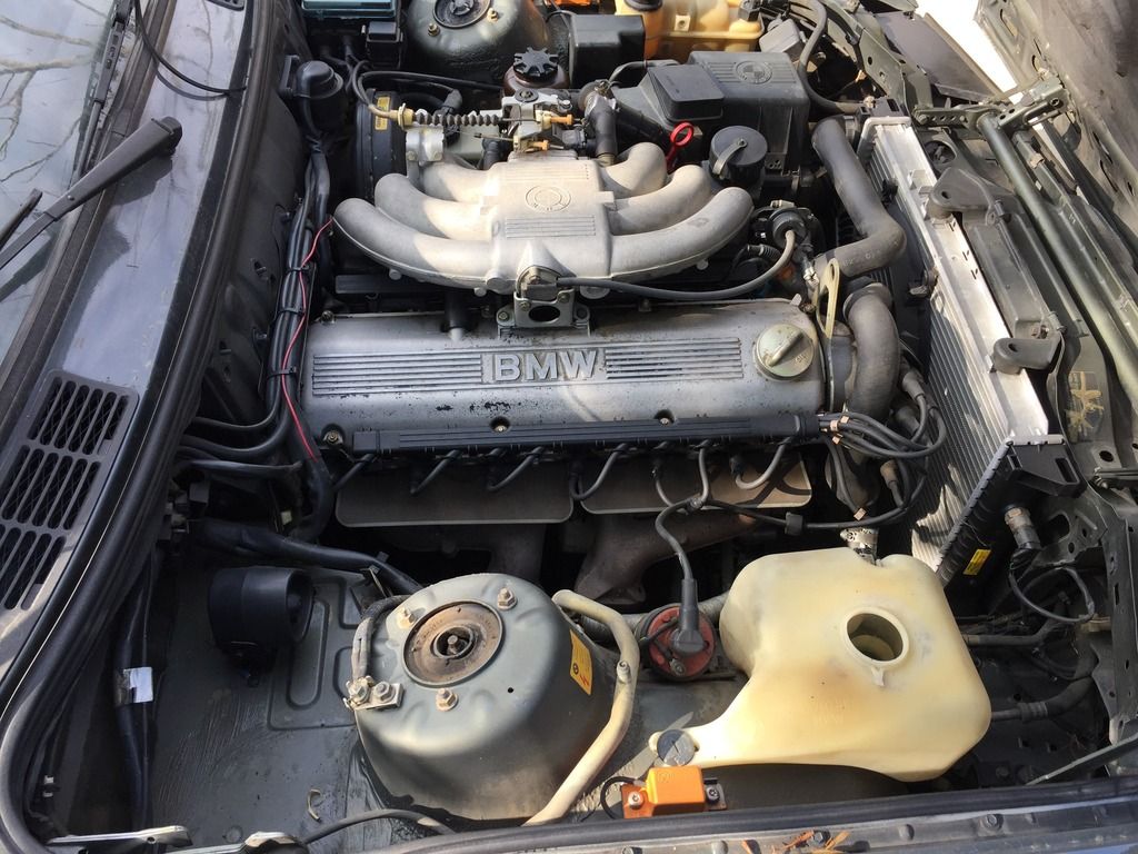

        Here is the current M20B25 Engine....

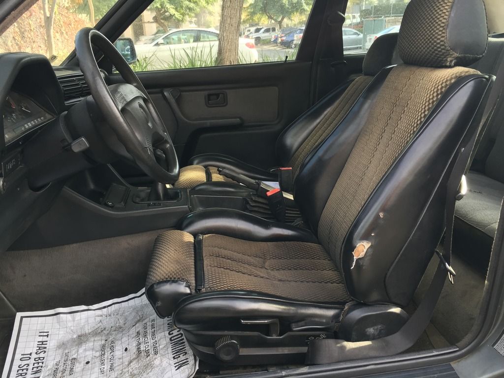

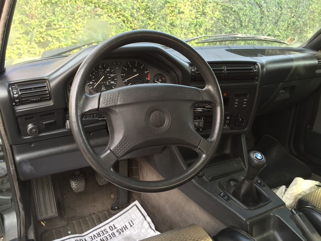

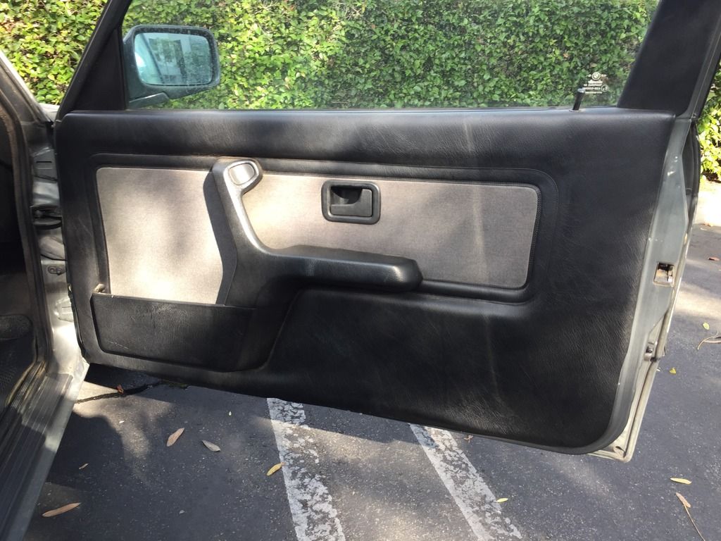

        Here is the current interior condition of the car...

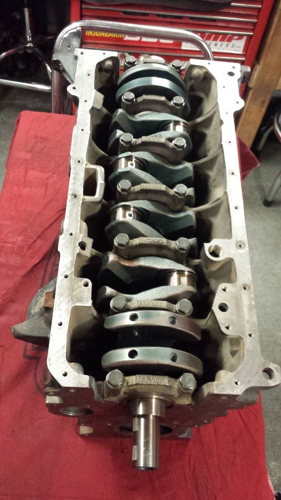

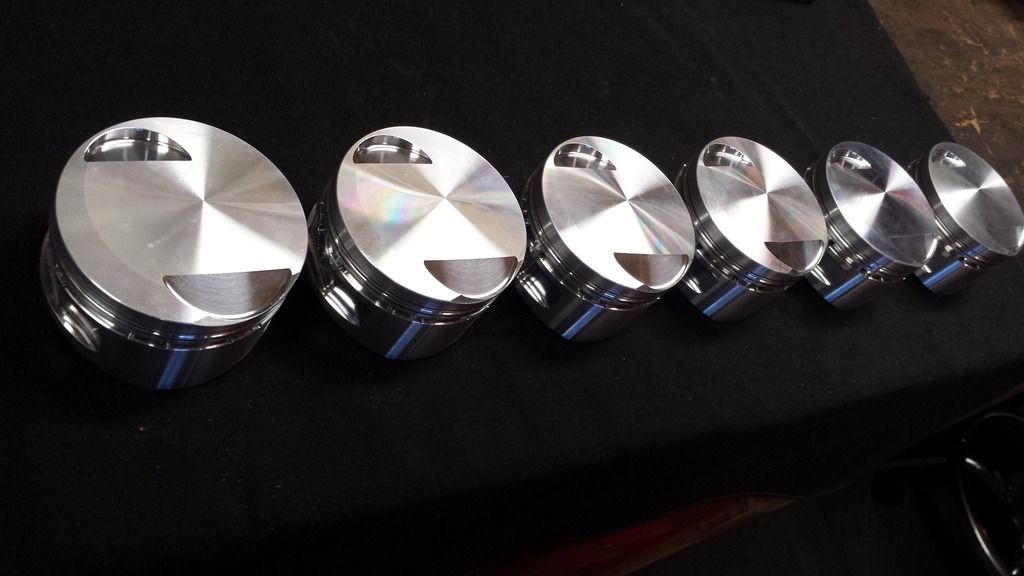

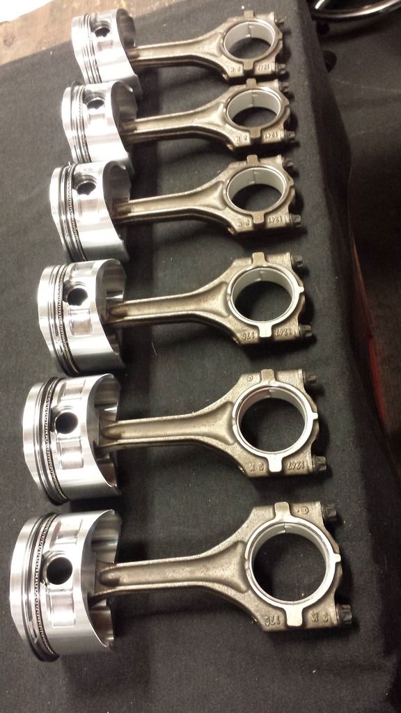

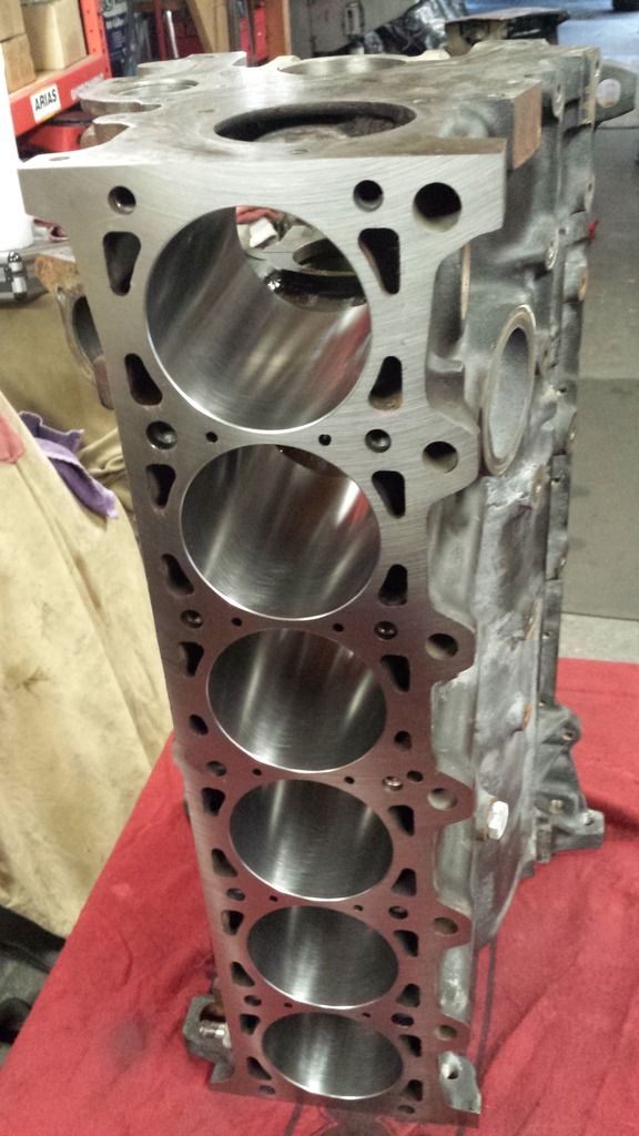

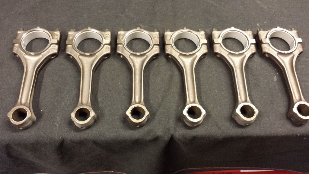

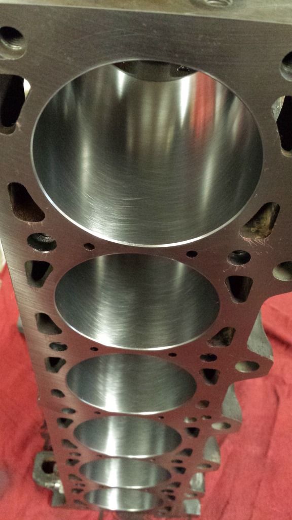

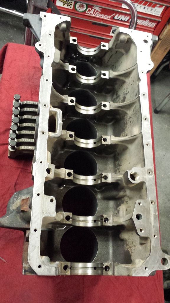

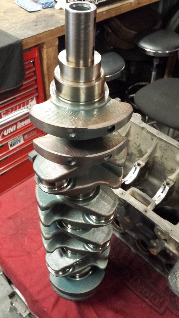

        The project was going to be an M20 engine, but it would be a 3.1 stroker. The engine would be rebuilt completely and the clutch was also going to be replaced. Then new engine would be sporting the Bimmerheads M20 Race 885 Cylinder Head.
        Engine would be ported and polished, new rockers, cam gear, cam seals, cam gear cover, rotor mounts, studs, oversized valves, valve seals, valve springs, etc. all weighted and balanced.
        I am pretty mechanically challenged so I entrusted everything to Shant and Matt. They also would be sending me photo's of the engine build as it was coming together.

                I like that you're doing a 3.1 stroker with their race head. What Compression ratio/pistons are you doing? Not sure what kind of budget you're on, but some of the IE Race headers and a set of RHD ITB's would top off that 3.1 stroker nicely.
                    Thanks Northern!
                    The compression ratio is 9.97:1

                        I can't decide whether to strip this paint and re-paint the same but with a much better quality and experienced body shop.... or go with the BMW Carbon Black (which is a very dark midnight blue)..... or.. 3rd option would be to go darker than the original Delphine Grey....

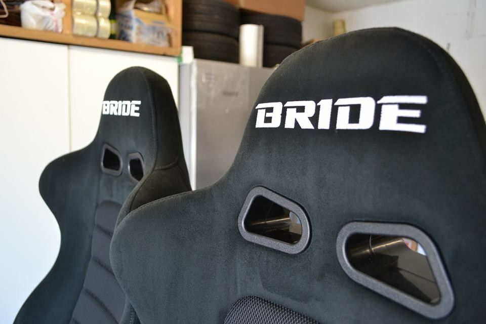

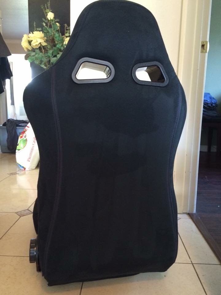

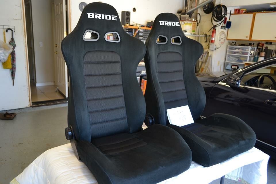

                            Acquired Seats
                            Picked up these seats to go into the E30! Bride Eurosters!
                            Now to order seat brackets with sliders... any recommendations?
