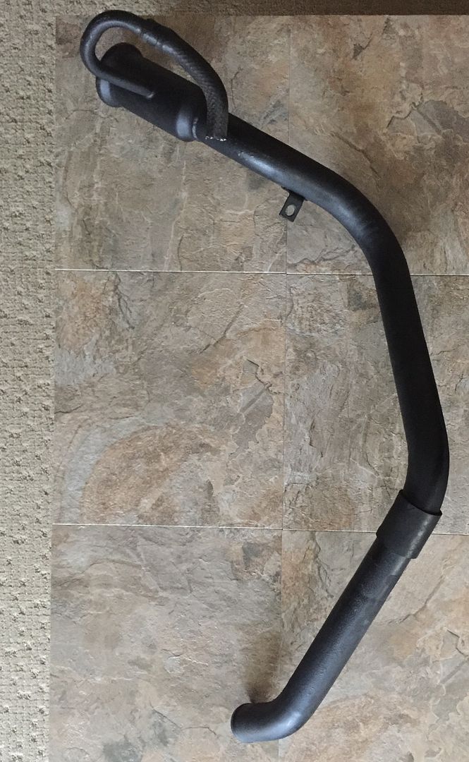

Fantastic. :DTo add some detail - I've been agonizing over this part of the project for the better part of a year. Like you mentioned, I've seen a few of these cars done poorly and I definitely don't want to add my car to that list. I've saved every photo I've found on the internet of these conversions and have studied what was done right, and what was done wrong.
First, and most obvious: to do this right you have to use OEM quarter panels. The cars with fiberglass over fenders not only vary in degrees of quality, but also they don't actually widen the inside dimensions of the wheel housing (which was the entire point of the box flares in the first place!)
The other area where people cut corners is as you said, the wheel housing. BMW built wider arches to accommodate the wider wheels, and mate up to the wider quarter panel. Without this extra width, the gap extends all the way down to the bottom of the quarter panel. There are only two cars I have seen that have handled this properly. One of which is Vazbro's amazing Alpine convertible tribute with the S52 swap.
And lastly, the details. As I mentioned earlier in this thread, you *can* modify the M3 coupe side skirts to fit, but they aren't tall enough and can look funny IMHO. I am using M3 cabrio skirts and all OEM hardware. Also some builds continue to use the standard E30 fuel filler, but that's a problem as well because you've moved the gas door two inches outward! I was lucky enough to get a E30 M3 fuel filler from a generous S14 forum member.
E30 M3 fuel filler:
I've poured over the part numbers, drawings, etc so many times that I have identified every part and piece that is different, and I'm doing my best to not cut any corners. Here's hoping it turns out!
