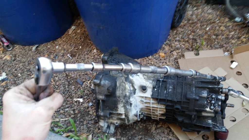

                      Did some work to fit the AKG DSSR to the old style shift selector. Why buy somthing when you can spend 5 hours making it?
                      Start grinding it down
                      Hand shape some HDPE bushings
                      That’ll do
                      Small piece of rubber to replace the sponge thingy.
                      Wasn’t planning on doing the clutch but my buddy gave me a dual mass clutch disk and TOB for free so why not.
                      Go go gadget wrench!
                      All back together with this gem. This isn't your Sunday cruisin' flick of the wrist shifter, you gotta man handle this thing.. like all the time, and its awesome. And I gotta say it's really a beautiful piece of metal, combined with the DSSR there is absolutely no play, any slop is in the box.
                      But I do need to get stiffer trans bushings, I'm at 80a with 95a engine mounts and there was several occasions I couldn't get into gear on a hard corner.

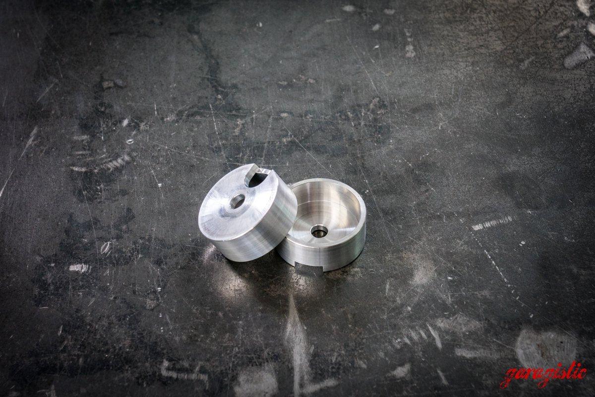

                        If you used a stiff poly bushing of some sort I recomend adding these.
                        Transmission Bushing Enforcer Cups - E30, E36, E46, F30, F32, F22, F80, F82, F87 These transmission bushing enforcer cups are great if you're looking to stiffen up your transmission mounts without adding noise into cabin. Machined from 6061 aluminum, these are meant to be used with E21 transmission bushings (not includ
                        You can totally drill
                        A second hole. I did later on after those picture where taken.
                            I’ve been driving the car a lot and it seems if I chuck it into a hard right I can’t get into 2nd. I shouldn’t be power shifting mid turn but I think I’ll fab up some of those cups for the bushings.
