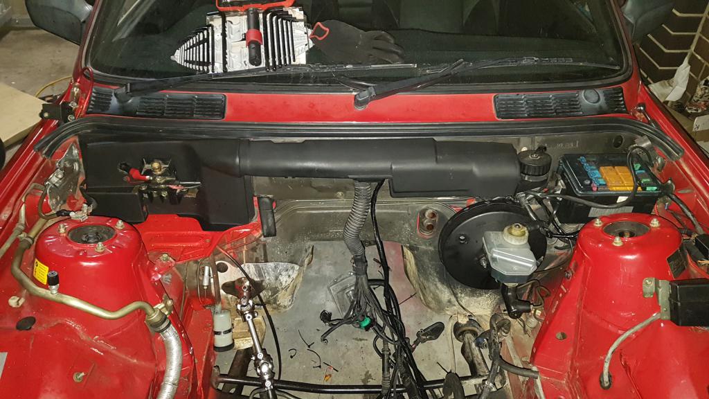

              Finished doing the wiring tonight.
              Ran the wiring for the battery relocation to the boot, fitted the e36 remote terminals on the m3 wiring cover in the engine bay.
              Diagnostic port is in the factory e30 location next to the fuse box and all wires under the 318i harness covers.
              Much happier with the new fitment.

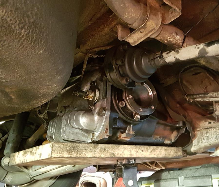

                Spent the day today tearing out the 4.10 diff the 318I came with and mounting the 3.15 from the scrap car.
                Getting the diff out was much easier than the last one. Knowing what to do already, made it a much smoother process.
                Mounting the new diff proved difficult, particularly with my limited equipment. Managed to get there in the end, using various toolboxes as supports and a very careful balancing act with the the jack and a piece of mdf.
                Only the one progress pic of the nearly finished mounting.

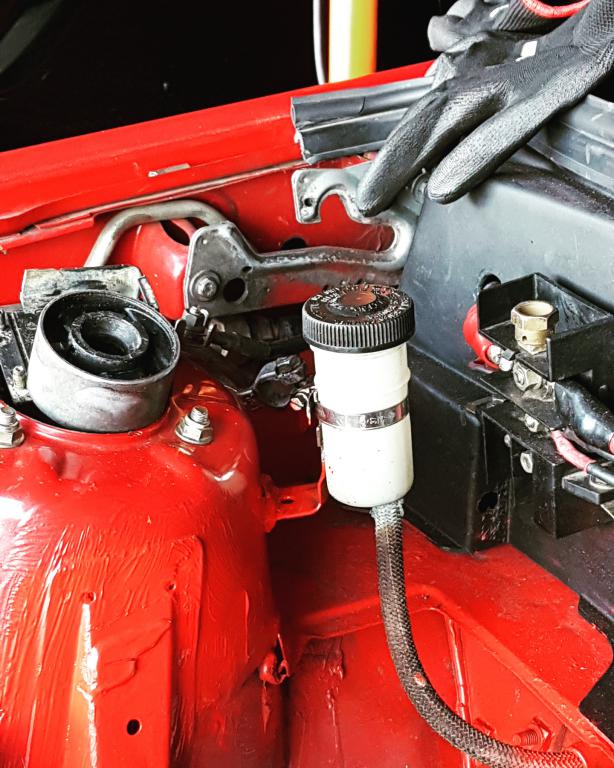

                  Haven't made much progress lately. Only thing of note was relocating the clutch reservoir from the side of the strut tower to the back of it where the battery tray has been cut out. Cut the old bracket and welded it into the new location
                  This was done to allow more space for the downpipe.
