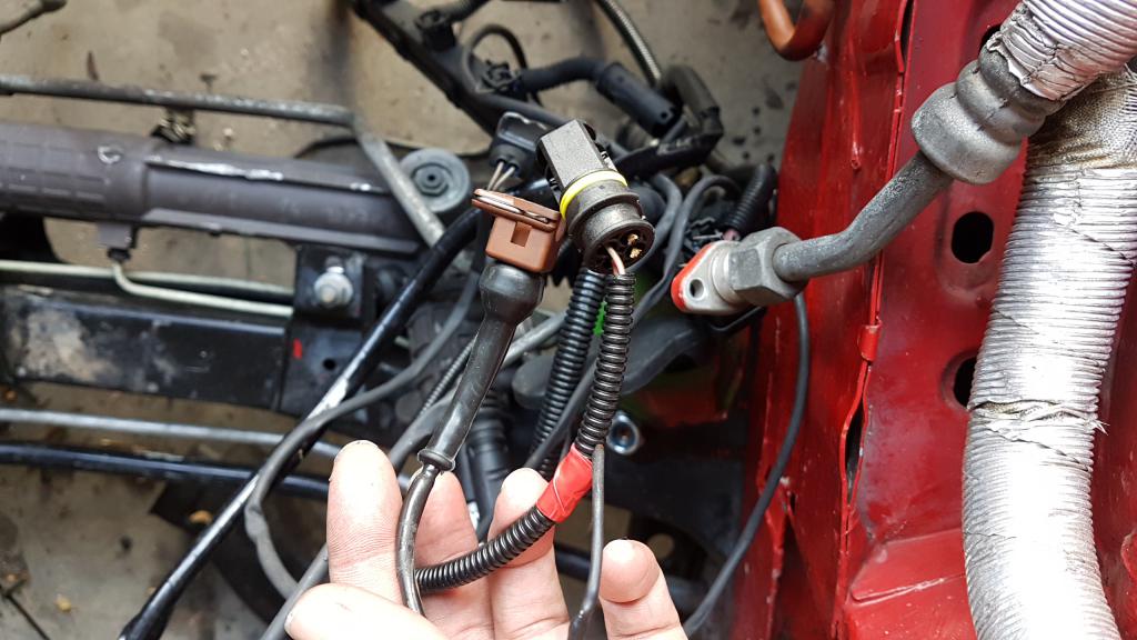

    Cluster temp connector was done through cutting pins 1 and 2 from the round, dual temp connector in the e36 harness. Pin 1 should be brown/violet. I pulled this back up through the loom tubing slightly and then back out the tubing. Soldered and heatshrinked this to the single wire temp connector I'd removed from the m40 loom and capped off the wiring from pin 2 cut earlier.

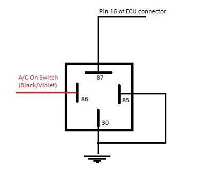

      Finally, i located the black female connector under the steering column with two wires in it. Thick black with red stripe, and black with violet stripe. The Black/Violet wire runs to the aircon switch and fed 12V when the aircon button is depressed. This needs to be wired into the MS41 ecu to enable idle bump when aircon is on.
      Wired up a basic relay that taps this 12v source straight to pin 19 on the MS41 harness, and at the same time, activates a relay to ground pin 16 of the MS41 harness per the attached picture. This then tells the ECU to ground pin 74 to pin 85 of the compressor control relay. As the e30 harness already does this, this shouldn't need to be hooked up.

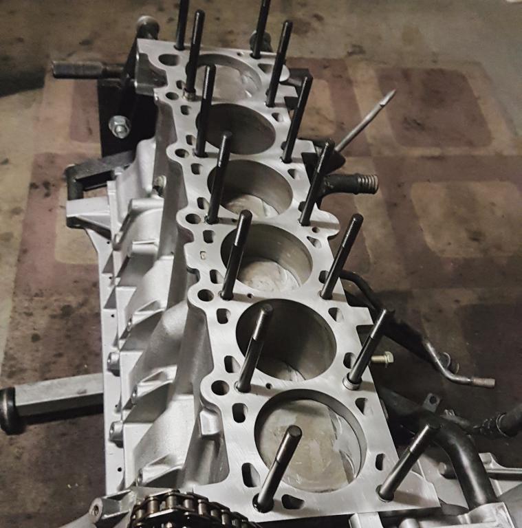

        So I finished timeserting the block finally. Still need to spend a bit of time on the finish; there's a few highs and lows to take care of but after a couple of mishaps, I'm glad it's all over and done with.

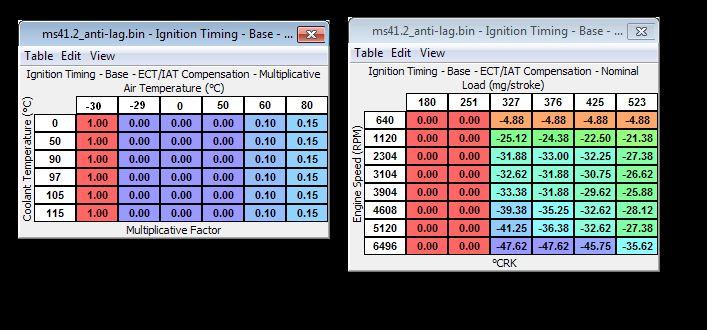

          Have been spending some development time on tuning software to get some stuff sorted once its finally time to put the engine in; Specifically, rolling anti-lag.
          Essentially what i need to do, is configure the scenario where the IAT reads approx 4.8v regardless of what the actual temperature. 4.8v relates to -30 degrees Celsius on the sensor scaling. By triggering this event, it will look up against the related tables in the flash, and attempt to target -30degrees timing from 327mg/stk load upwards.
          I have a rudimentary circuit that i'm not happy with so i'm going back to the drawing board to come up with a more refined version.
          In the mean time, if anyone knows whether the DME will throw an error if >5v is fed to IAT sensor that would speed the process up considerably and i could just scale the table to -40c (5v) and be done with it.

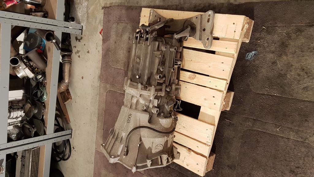

            #35

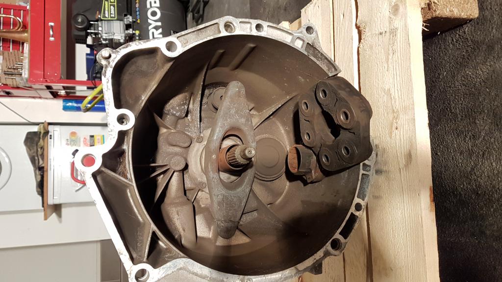

            A present finally arrived today from the UK after 2.5 months of sea transport.
            GS6-37DZ - 6 Speed from a 320d

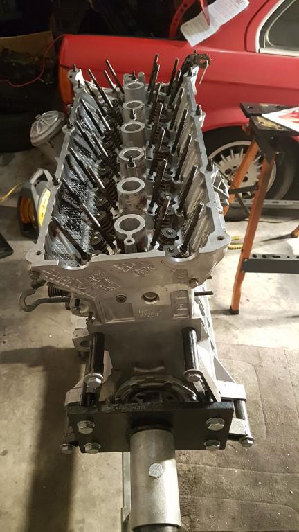

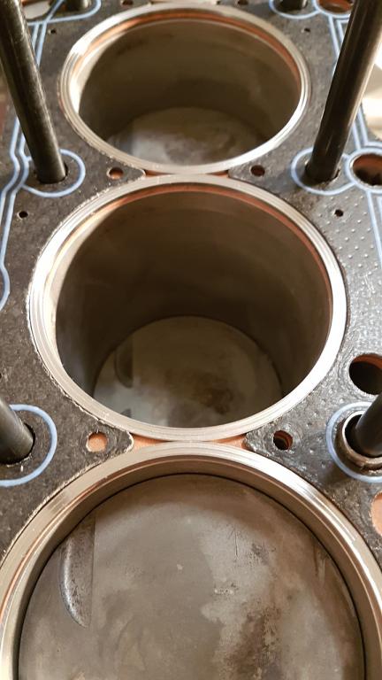

              Finished up surfacing the block and fitted the raceware studs. They sit taller above the deck than the standard bolts if bolted all the way in. Unsure on how deep they're usually inserted though.
              Nowhere in my city seems to stock copper spray so I'm waiting on that to come in the mail before fitting the copper spacer, gasket and cut rings and the head.

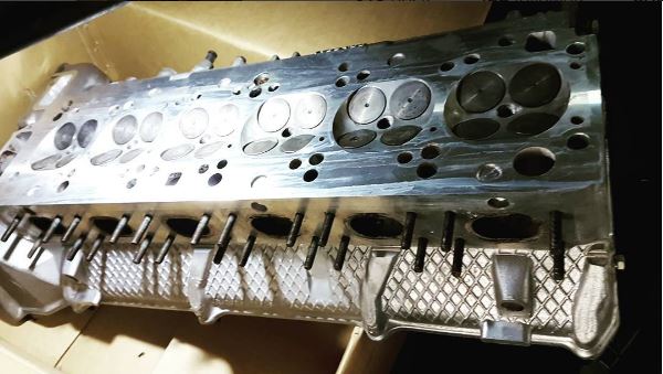

                Picked up the head today (finally!) after being gone for 3 months...
                nothing major done, just had it skimmed and had new stem seals fitted. Soon as the copper spray arrives i'll be fitting it up!

                  I'm really interested to see how the antilag turns out. I would've never thought to use the IAT comp tables for that.
                  I think I saw that you swapped to 41.2 with 2.8 maps? Did you end up changing the full flash load limit to 2048kg/hr? I read the basic instructions in that thread, but I don't understand any of what they meant. Going to send you a PM on that...

                    Originally posted by Northern
                    Looking good!
                    Yep i posted a MS41.2 rom that i converted with all the MS41.0 defined maps over on the other forum. should be a good starting point but would need some more changes for it to be useful on a euro M52 like disabling misfire detection. This is all defined in the xml i shared with you, hopefully the descriptions make sense.

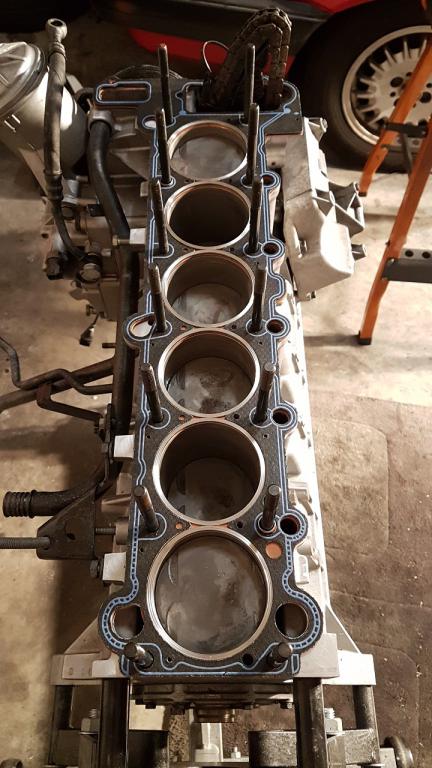

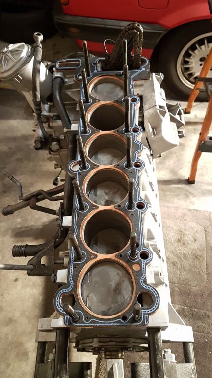

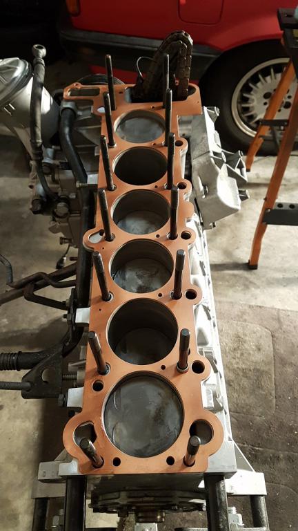

                        Got home after work last night and decided it was time to get cracking on reassembly.
                        started off by spraying a light coating of copper spray on both sides of the spacer and laid it down on the block, followed by the gasket and cutrings.
                        I then removed all studs bar the 2 that go through the dowels so that it would be easier to drop the head down and align it.
                        Got the head down, tied the timing chain out of the way again and started putting the studs back in. The instructions say to wind them in until they bottom out lightly, and not to double nut and try to tighten down, so thats what i did. so far so good. Click here to enlarge
                        I then commenced the torquing sequence, 20ft/lb, then 40ft/lb and then finally 55ft/lb. I left it this way overnight and decided to check back in the morning.

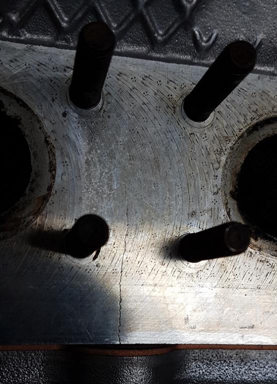

                          #42
                          This morning before work i performed a final check to see whether they'd held torque overnight. The first few were all still to spec, however when i got to about number 7, it had loosened slightly and on attempting to re-torque, the nut made a slipping/cracking feeling before the torque wrench clicked. This didn't sit well with me so i walked around to take a look at the head where this bolt goes through...
                          I think this picture speaks for itself
                          FML. After waiting nearly 3 months to start putting the engine back together, this head now goes in the bin when i get home from work today and i commence searching for either another engine, or a donor car to start all over again. more delays!

                            #43
                            wtf....? I have never seen than happen before

                                #45
                                wtf dude im sorry that's awful
