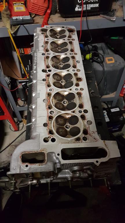

    Build is looking nice! Great progress. The only thing I am recommending is that you put RTV sealant on the top of the timing cover. Not a lot so it squeezes out but just a light coating because they are known to leak oil in that spot. I've been there and done that.. so I'm telling you to save you in the future lol. However the picture you just posted of the cylinder head is quite strange...
    I should have mentioned i did put a VERY light coat of RTV over the seam where the timing cover meets the head as i'd read about the leaking.
    The cracking however is nowhere near this.
    In other news i appear to have found 2x M52 short blocks and a head to go with them. Just hope it doesnt cost too much to ship them across the country

      And we have the culprit. Seems despite my tests, the block was somehow too soft in one place (maybe) because the cause of the crack was a timesert stripped from the block and pulled up into the head.
      Very strange, I've never read of timeserts failing before. All the others were perfect.

        That's not caused by timesert. It's because of those stud bults you are using. The alu-block can't handle those (that's why ARP doesn't even have bolts for alu-block). Next time use only use stock headbolts. Those can handle 500-600 hp. If you wan't more, then switch to cast iron block with stud bolts.
          This was the recommended setup from VAC motorsports...
          Have found an e36 325i (M50) for dirt cheap with 180k kms on it so i'll be swapping that one in instead. Bonus is it's an auto, which i needed a tailshaft from anyway in order to complete the 6spd swap so it's not all bad.

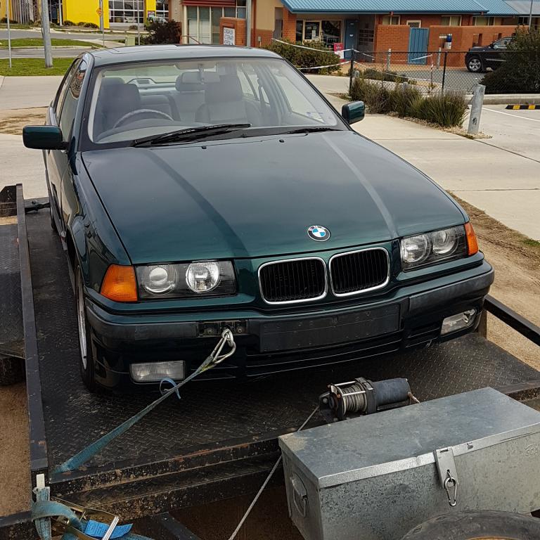

              New donor car collected. 325i with m50b25tu. Paid AUD$400 which is roughly USD $0.50c.
              No more aluminium block.

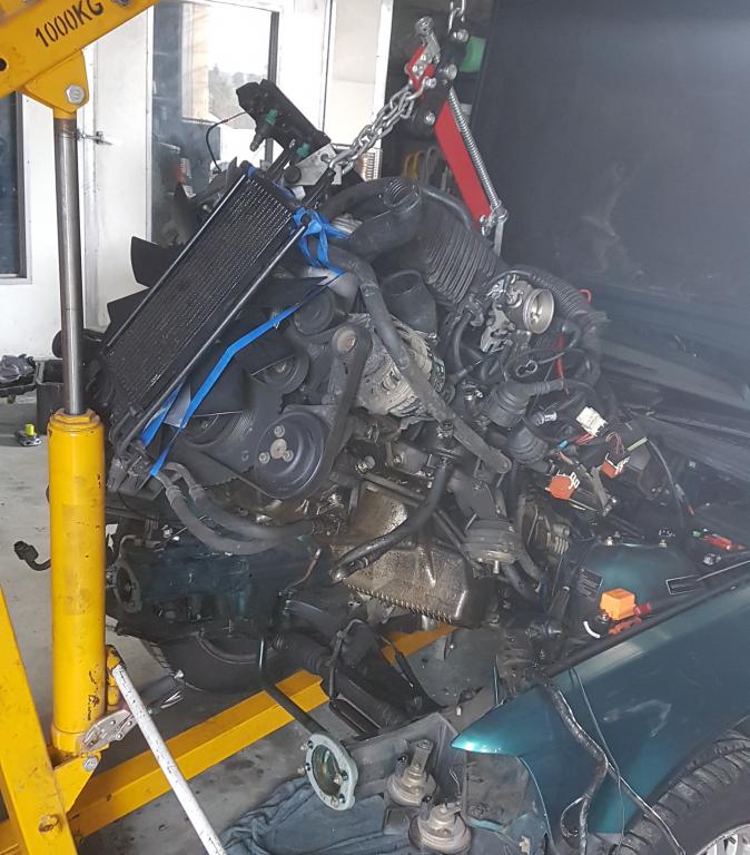

                #52
                Engine out!
                RHD OBD2 M50b25 turbo build thread:
                http://www.r3vlimited.com/board/showthread.php?t=384800

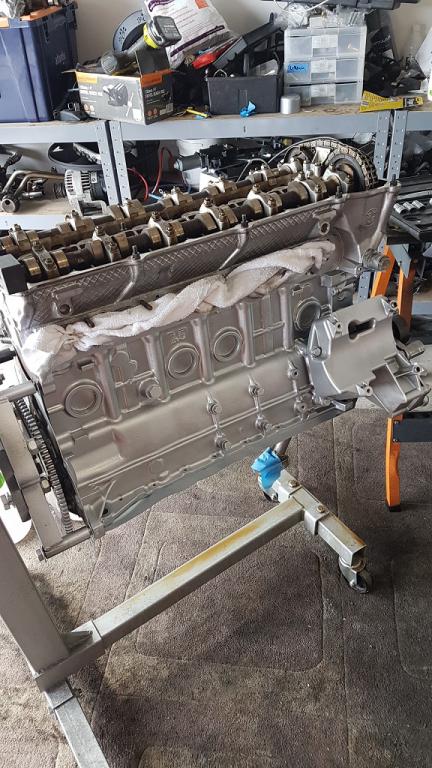

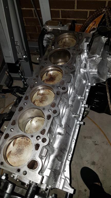

                            Finally made a little progress. Spent the weekend pulling the head and cleaning up the block a bit. Positive news is that the head looks to be in excellent condition, as do the cams and ledges.
                            Also drilled, locktighted and safety wired the oil pump nut. That thing isnt going anywhere!

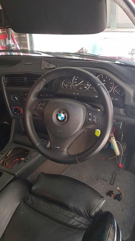

                            In other news i also decided i love my 135i steering wheel so much, that i would also buy and retrofit one to the e30. Pretty simple, just shaved the back of the wheel down, drilled holes and bolted to a boss kit for an aftermarket wheel.

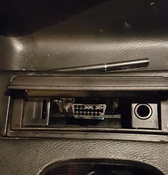

                            Also wired up the OBD2 port to the ash tray/coin holder.
