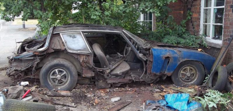

                  "Barn" find...
                  Sometimes, when I’m on Craigslist or Ebay, I come upon a car whose condition takes my breath away, and makes me wonder how the hell any vehicle could ever descend into such a miserable state. This Jensen Interceptor is one such example.

                    "Ran when parked."

                      Originally posted by LateFan
                      "Barn" find...
                      [ATTACH]115650[/ATTACH]
                      http://jalopnik.com/this-dilapidated...eti-1796843968
                      That's about as bad as my red JH, lol!
