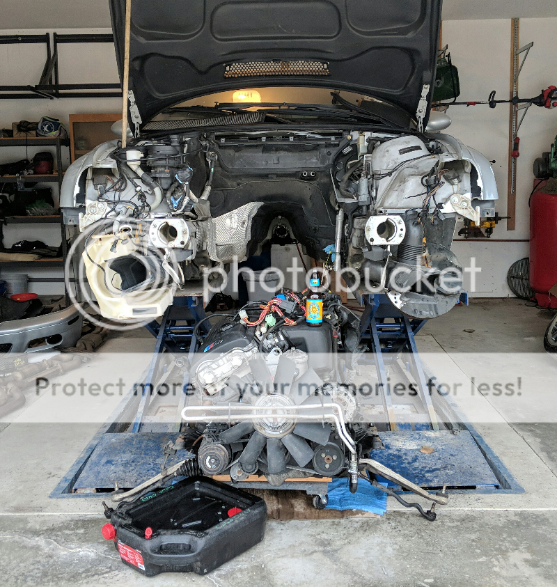

      It's been a long-ass winter full of work travel and a distinct lack of garage time, but I managed to do something this past week:
