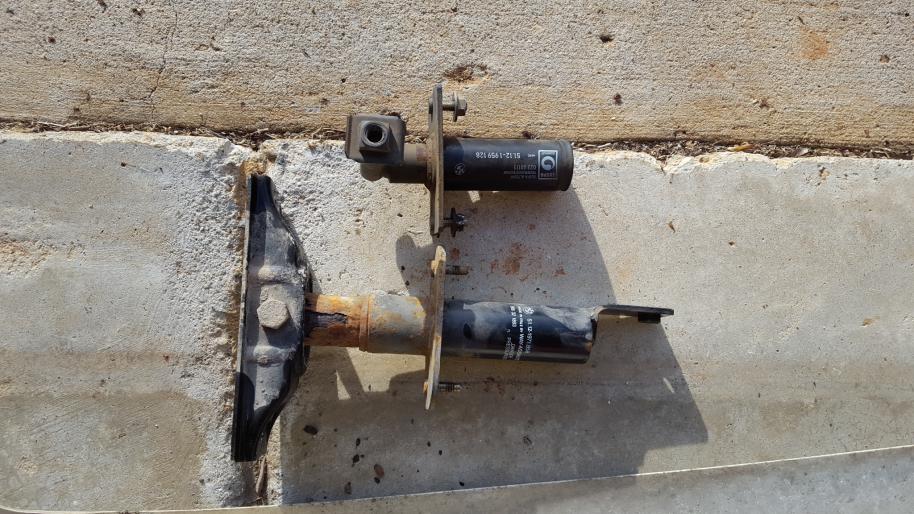

              I posted a picture of my 88 and the new "plastic bumper" shocks side by side. I think the newer shocks might work for the rear bumper but you would have to modify the support in in the bumper to get it to fit/grind it so the tube that the torx goes through fits. As you can see the length is pretty different so if you really need to know I could mock it up for you tomorrow.

                Part number on it is 51 12 1971 858

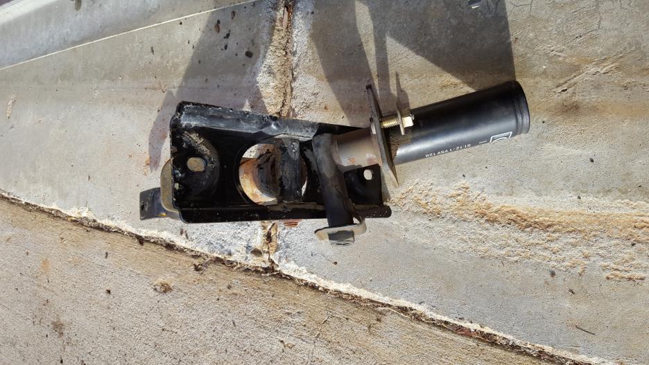

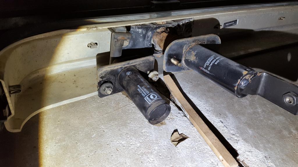

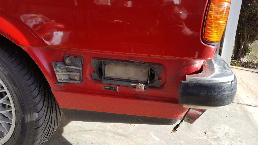

                      So I mocked them up and here are the pictures. For the sides you will have to weld on a bracket for the plastic/rubber surround. I think the rear diving board bumper should be a direct bolt on for you if you have the metal bracket shown in the picture attached to the bumper and you will have to cut the vertical piece that supports the bumper down to get it to fit in the bracket and use a bolt and nut. Worst case you would need a spacer between the metal bumper and metal bracket. The car is still apart right now so let me know if you have any questions and I can go out and take a look. Still have the sides let me see what kind of shape they are in and I can send pics. You will also need the side brackets pictured since the rubber side piece slides back onto it

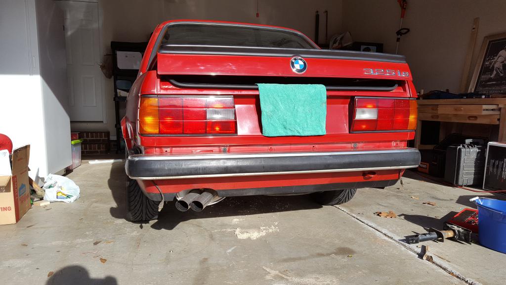

                        I am almost done. Doing it by myself so it's hard to check interference when I'm installing the rear bumper.
                        Does anyone know if the rear bumper should just slide on or do I need to cut the bracket that the rubber trim pieces screwed too.
                        Also wondering if I need to get a Dremel and grind the bolt holes to move the shocks down a little.
                        Going to get it finished up tomorrow one way or another

                          Normally for the plastic bumpers, I pull the two vertical screws and slide them out whole (fiberglass with the lights and cover), leaving the shocks in the car, reverse for installation.

                            That worked pretty well. Had to grind off two mounting tabs for the old bumper then touched it up with duplacolor victory red so it didn't rust. Just started adjusting the brackets.
