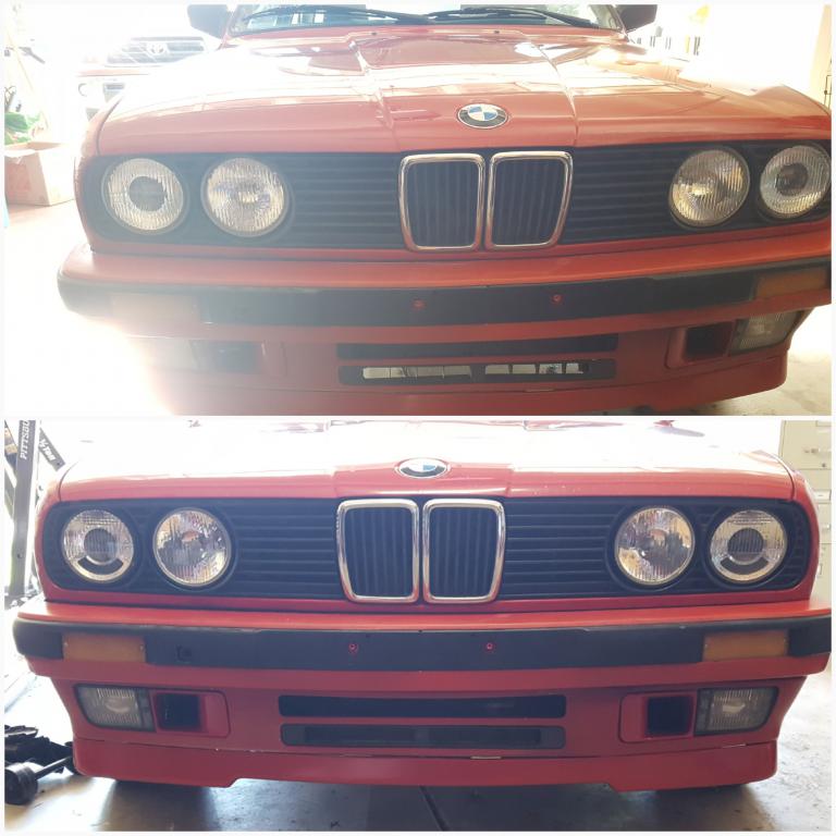

      #62
      Smiley
      Finally got my smileys in today. I went from US Ellipsoids and the only moment of confusion was when I turned on my highbeams and everything worked. I had gotten it stuck in my head I would need to jump pin 30 on the relays but unless I am mistaken that is only for sealed beam to smiley.
      Does anyone know if the engine bay headlight covers will still fit?

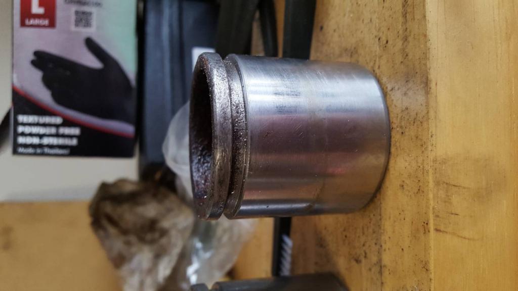

                          #72
                          Working on rebuilding my front brakes. Is this too pitted to use and if so can I buy a new one compatible with the girling?Click image for larger version
                          Sent from my SM-G920V using Tapatalk

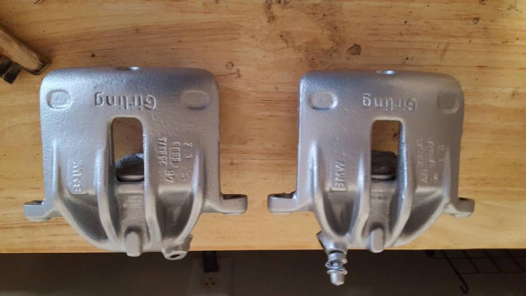

                            #73
                            Front is done!Click image for larger version

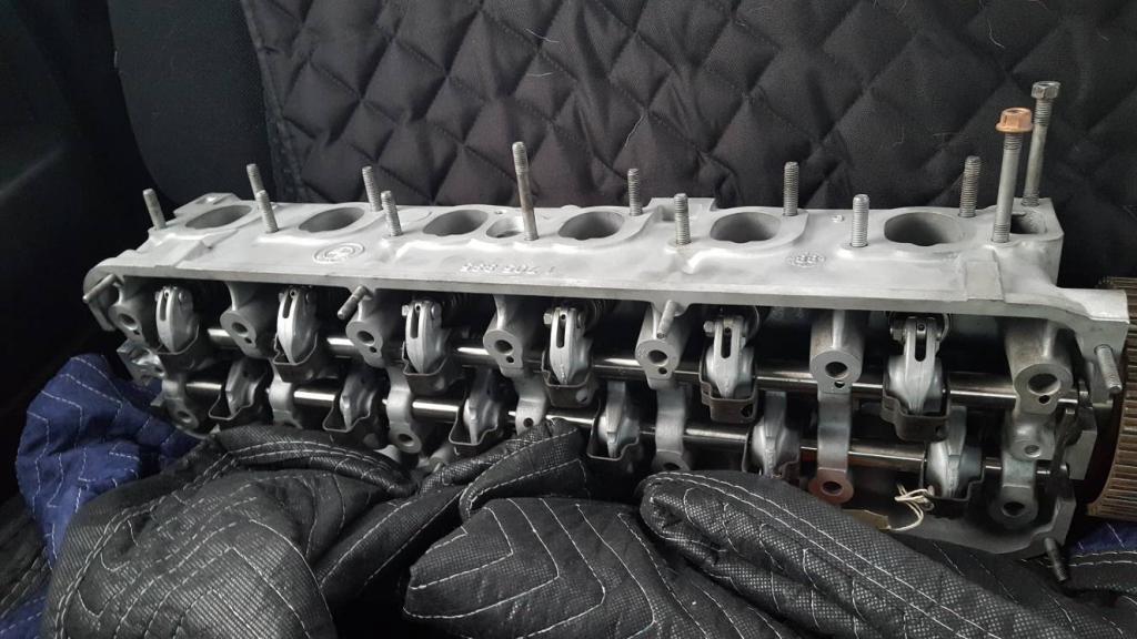

                                #75
                                Nice fresh head with new camClick image for larger version
