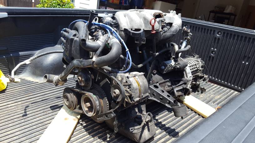

        Well r3v my day started great. Got a fair deal on a M20B25 with G260, picked it up, got it home, was taking it off the truck and........................ about two feet from the ground I turned the handle the wrong way on the engine hoist........ bammmmm as I look at what seemed so full of promise and grab some paper towels to mop up the oil seeping into a black pool around my cracked oil pan. I wonder three things and the first is rhetorical.
        1. How could I be so stupid.
        2. Oil pan and transmissions mounts took the hit. What do I need to check and should I just pull the head and make a coffee table?
        3. How long until I find this funny?
        I'm going to go try and mop up that oil now

          The beforeClick image for larger version
          Sent from my SM-G920V using Tapatalk

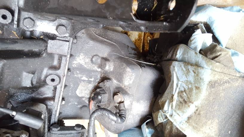

                  And heres the afterClick image for larger version

                    Probably just need an oil pan... also a good time to remind you that maybe a skidplate should be ordered too, though your car doesnt really look too low

                        Buddy is a welder so I'm going to see if he can fix the pan
                        I was planning on doing a compression check but my plan now is.
                        1. Remove the transmission.
                        2. Install the motor onto the engine stand.
                        3. Clean everything and look for cracks.
                        4. Have a friend(certified welder) see if he can tig the oil pan.
                        5. Maybe buy a liquid penetrate kit to check for small cracks on the block.
                        What am I missing?

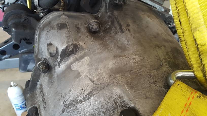

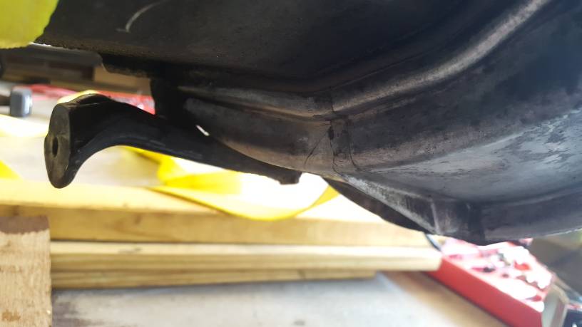

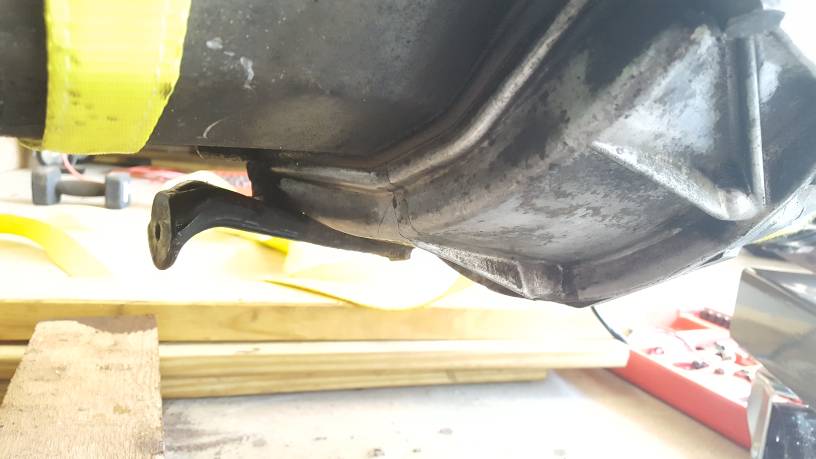

                          #57
                          Looks like my bell housing took it on the chin. Can the housing be welded?
ID:	7197089Click image for larger version
                          • tiger_e30
                            • Dec 2016
                            • 219
                            #58
                            Looka like this already was welded or is that a factory seam?
                            [ATTACH]121750[/ATTACH][ATTACH]121751[/ATTACH]

                            • ForcedFirebird
                              • Feb 2007
                              • 8300
                              #59
                              Customer dropped his brand new Spec e30 engine about 3' from an engine hoist. Landed right on the crank bolt and broke the alternator bracket clean off. Stuck ity in and raced it at nationals.
                              Also, several of the racers don't even run that cover for the flywheel.
                              john@m20guru.com
                              Links:
                              • TimKninja
                                • 2131
                                #60
                                thats just the cover for the flywheel,not part of the tranny/
                                1985 325e M50TU(Sold)
                                1991 318is Slicktop (Sold)
                                1990 325is Brilliantrot S50/5 Lug Swapped.
                                1992 525i Manual shitbox Winter Beater
