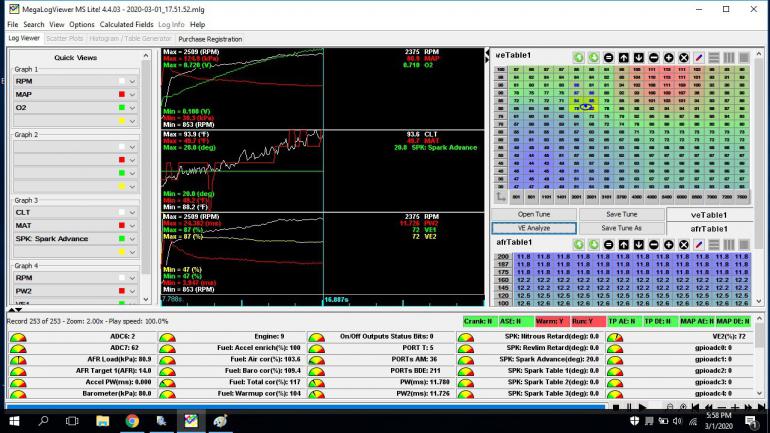

                          Hooked up a used Diyautotune plug and play today. The good news is it started but it sounded rough and the tach didn't match tuner studio. Still running Naturally Aspirated with a narrow band O2 but I hooked up the pressure line and installed a GM IAT. Never worked with megasquirt before but it looked like the coolant temp wasn't working. Any idea where I am going wrong?

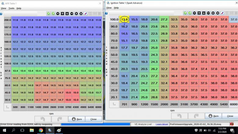

                            #88
                            I was able to calibrate my IAT and coolant sensor. Is it normal for the coolant sensor to be at around 60 and fuel pressure at 140kpa when I just have the MSPNP on the bench not connected to the car? I was unable to calibrate the stock TPs. Do my maps look reasonable? Also any idea why dash rpm would be off vs mspnp

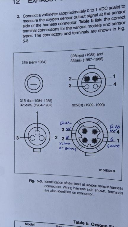

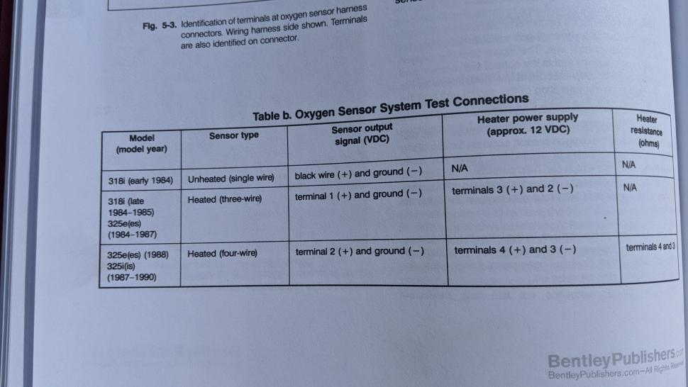

                              Wired in the lc-2 using the stock o2 sensor cable and connector I added what the wire colors and pins were for my application below. The lc2 has a wideband and narrowband output

                                #90
                                Found out the pnp isn't wired to control the stock 02 sensor so the relay isn't powering up for lc2
