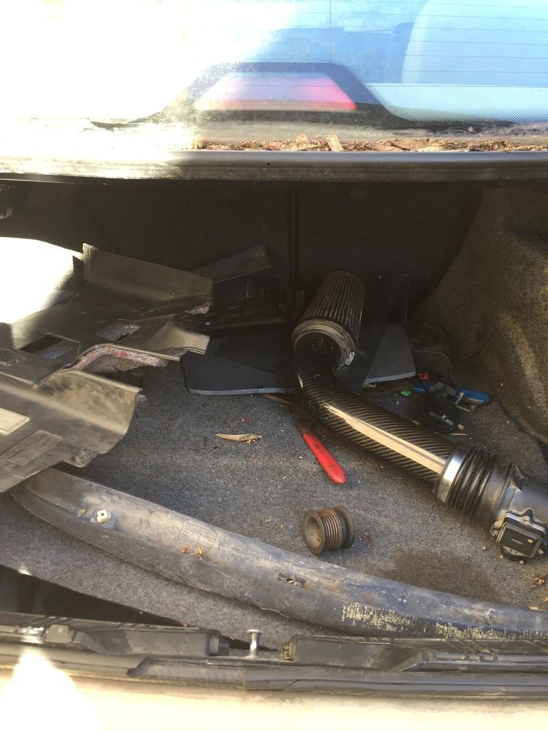

          Here's a bunch of stuff that may or may not make it back on the car. Just a huge mess. You can also see all the leaves and dirt in the jams between the body and the trunk seal. That crap is all over this thing.

          • 2mAn
            Señior Mod
            • 21062
            Sell me that intake.
            Is it painted or wrapped in that awful color?
              PMd you on the intake.
              Unfortunately that's primer over the original cosmos :( but it looks like they did a decent (read not perfect but on its way) job on the body work.
