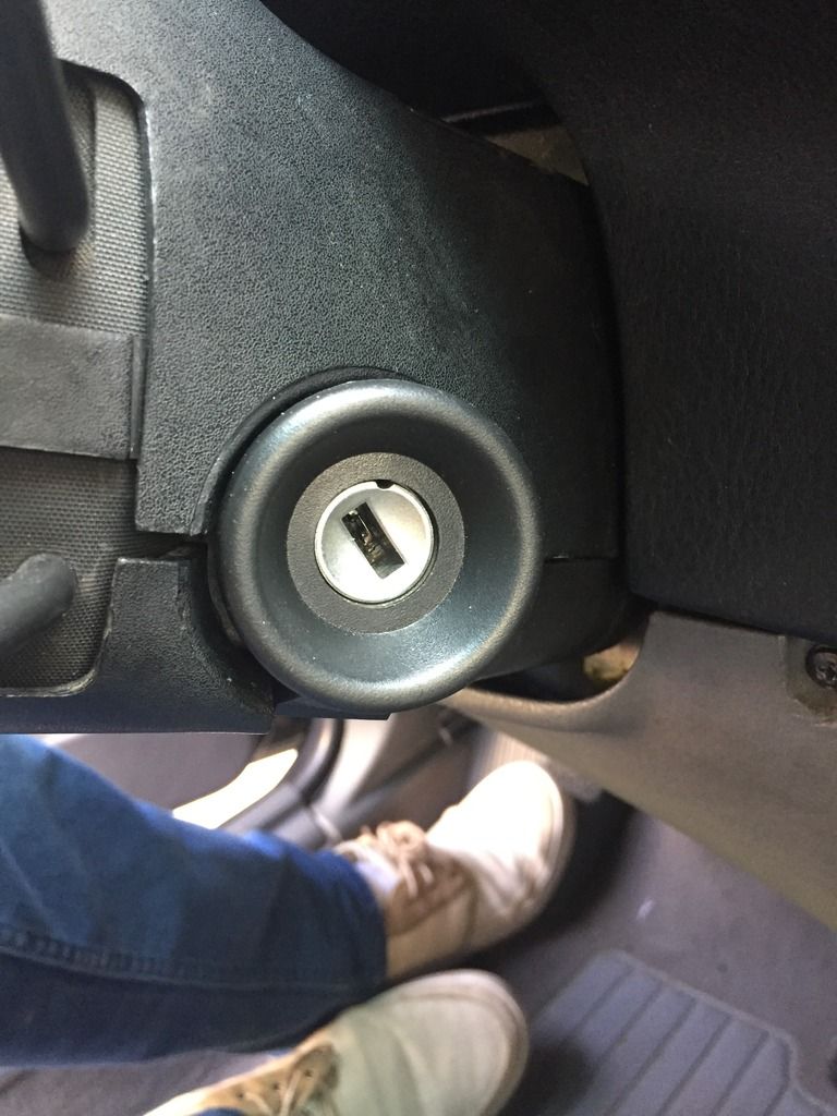

                    Fixed the broken antenna ring on my ignition. Its pretty much a beauty cover now with no EWS but I don't care. It was ugly before.
