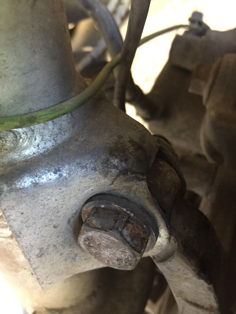

                              I borrowed a couple of DS2s from my dad so I could get the car on the ground and rolling around. The clutch feels good which is a bonus, but I've really only driven the car about 8 feet.
                              The style 32s were rubbing the crappy front coilovers so the helper springs had to go.
                              Then I found this awesome little guy.
                              Don't buy cheap parts kids, and please understand torque values.
