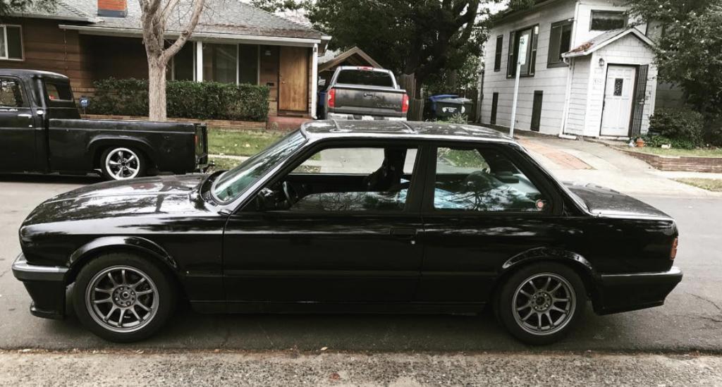

                Well, today was a big day... I was able to drive her for the first time in years!
                I cleaned up the wiring, my idea of extending the DME end went out the window after I chopped up a spare harness to see what I'll have to do. There are a quite a few wires that aren't individual, but shielded wire looms so that's what stopped me from attempting this.
                I opened up the firewall hole to match the shape of the harness plug that I removed from the spare harness to use as a template. I cleaned up the wiring harness from the ASC wires and the secondary throttle body TPS sensor etc that some cars utilized and some didn't.
                I think it's long enough where I can make it work, I kept the wiring harness connectors for the temp sensor and fan connector as I plan on utilizing them in my install.
                Here are some photos
                The white black black connectors are literally not connected to anything else on the engine harness, so you can pull that off. This is for optional 2nd throttle body.
                Here is how far into the cabin I was able to get the DME end with relays.
                • Jean
                  • 18228
                  #113
                  First impressions, keep in mind this was an easy drive to see if everything as in gears/brakes/steering etc are working as they should :)
                  - using a "virgin" 540i/6speed manual DME, fires right up and finds its idle
                  - shifter is very precise and mechanical, not sure how else to describe it. If you've ever driven a Miata or S2K, its similar but even more precise.
                  - clutch pedal is right there, feels good
                  - steering is working, no unusual noises or anything
                  - car is a bit loud inside, but kind of expected as I am using poly / bolt through engine/tranny mounts and added a 2nd diff mount that's also poly with a bolt through. BECAUSE RACE CAR? LOL
                  - I forgot how low my car is, it doesn't seem low but I already scratched exhaust pulling out of the driveway onto the street DOH
                  - exhaust sounds good at idle, and car isn't loud outside unless you get on it which is exactly how I wanted it to sound so glad it worked out.
                  - all gauges are working expect for tach, need to get one of those modules or make one of my own if I find a schematic for it.
                  - I am still using my custom built 4clutch disc 3.46 lsd, moving in 2nd gear and then rolling on power maybe 60% and it's braking traction . This will be like learning the car all over again, it's quite noticeable power increase over my previous m30b35 swap.
                  Need to install cooling fan and find the right expansion tank cap that actually works with the early tanks.
                  Please ignore the late model tank I am temporarily using, it's only there so I could test drive this thing.
                  Two quick videos to show how it sounds
                  slow take off - https://www.youtube.com/watch?v=iVyP0Lvtz0U
                  drive by - https://www.youtube.com/watch?v=qzchRCGRS6k

                        Got wiring under the hood cleaned up and installed my spal fan. Unfortunately it's too big to install as a puller so I had to install it temporarily as a pusher using spal brackets.
                        Fitted airbox in the engine bay, damn thing barely fits but must be in there to keep this swap California legal . Also got the check engine light wired, just need to solder some wires under the dash for vss/ tach and mpg .
                        Also need to figure out a way to securely mount the DME, good thing the dme harness end is just long enough where it should be doable .
                        After installing airbox , it really made the sound of exhaust more defined imho .

                                First real test drive done today, car is ridiculously fun but gearing a bit short for freeway speeds �� 70mph @ 3500 rpm or so, a bit high.
                                First gear is pretty much non existent, enough torque to pull in 5th around town . Thinking I'll probably need to switch from 3.46 to 3.25 , considering sport 540 cars had 3.15 iirc
                                Boosterless brakes are working fine, but take a little bit of time to adapt to as they are so different from how they feel. I will most likely be posting the complete Wilwood pedal assembly with masters and Garagistic bracket for sale soon (make me an offer :) if you are looking for a set.
                                Exhaust sounds amazing , but I will need to raise a car a little bit as clearance under cats is a bit on the low side , oops.
                                Really liking rack doctor e46 steering rack, and v8 power is exhilarating! Got the tach working using universal tach adapter that you can purchase on eBay for about $40, it works with 4 and 6 cylinder clusters, you basically set the dip switches to the correct combination and off you go. Link - https://www.ebay.com/itm/UNIVERSAL-T.../141931549970?
                                Tomorrow I need to check all the fluids, and do some miscellaneous clean up. Also ran a loom from the radiator temp switch inside the car to install a manual override switch for the e-fan.
                                Ordered new external and internal fuel pumps, as I am hearing some cavitation going on.
