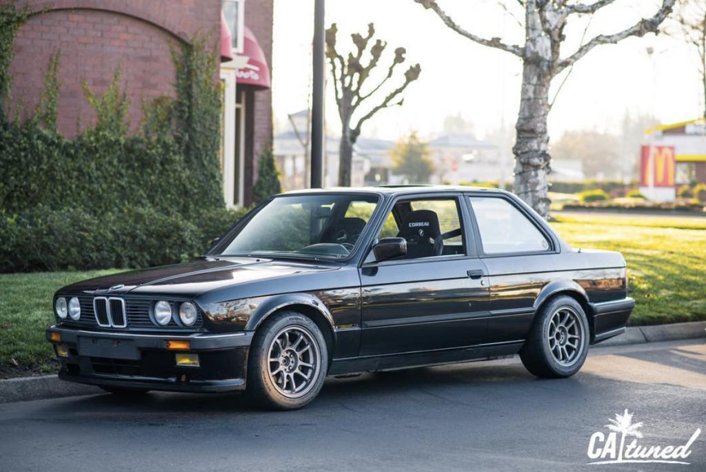

              Haven't been to a car show in years, decided to check out local Euro Sunday event and it was huge turnout but only seen 1 other E30, local guys really clean E30 M3 with S50 or S52 swap. CAtuned crew snapped a photo of car, I really need to get the car detailed and take some good photos. Ordered the missing center caps from TireRack today and also clips for the fender trim. Maybe one day I'll get the side skirts painted and installed too.

                  Man, your car....it's beautiful. I has question: are there skirts to go along with the front and rear valance combo you have? That euro bumper+rear valance combo is perfect.

                    Thanks guys ! She has potential :)
                    To answer your questions , I do have matching oem skirts but they need to be stripped from old paint / repainted and then installed .
