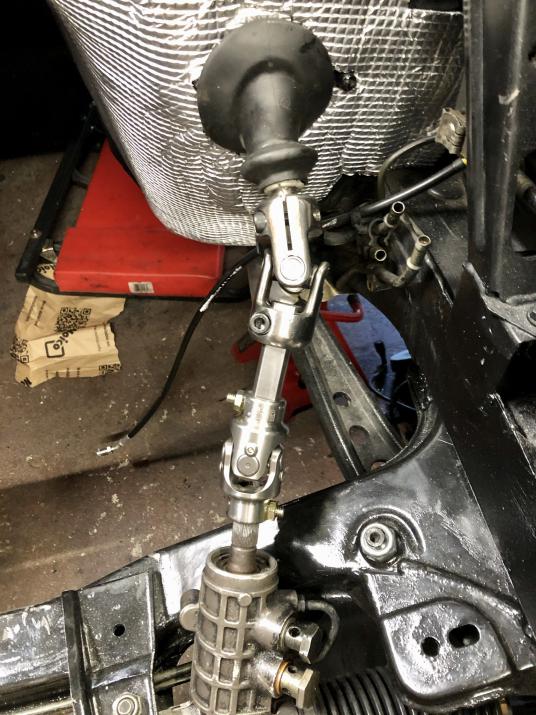

                        Okay, decided to go with a different steering shaft setup. My steering column splines are 17mm x 36 spline, while the e46 rack is 17mm by 54 splines. Condor offers a single ujoint solution for these specs, but it seems that the steering column wouldn’t be long enough to for the single ujoint to bridge the gap, even when fully extended. To further complicate things, nobody that I could find offers a two-joint with DD solution for the airbag column and e46 rack combo. So, I started searching through summit racing and found this to be the solution:
                        -Flaming River FR2563 17mm x 54 spline with 3/4” DD to attach to the steering rack.
                        -Unisteer Performance 8052510 17mm x 36 spline with 3/4” DD to attach to the column. (This is listed on summit racing as 3/4” x 36 spline on summit, but that’s incorrect. You can confirm that it’s 17mm x 36 on unisteer’s website)
                        -About 3” of 3/4” DD
                        This 2 joint setup fits perfectly and also takes care of the issue caused by the angle of the e46 rack so that the airbag column can rest closer to its original position.

                          #42
                          So, with that steering shaft and joint setup, you won't need to notch the firewall for airbag cars, correct? That is AWESOME.
                          • 1panthertxn
                            • Oct 2016
                            • 40
                            #43
                            As far as I can tell, I don’t see why you would need to. There’s always a chance someone smarter will come along and tell me I’m wrong, though.
