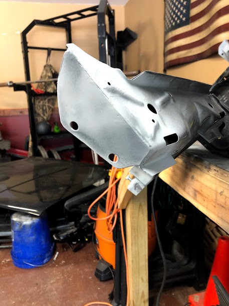

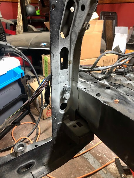

                I also made the top half of the radiator support removable to make everything a little easier. I basically just cut right through the support about 1/2” short of each fender, welded in plates on the fenders and boxed in the ends of the support with a plate that matches the ones on the fenders. They are secured by two bolts each.
                Click image for larger version  Name:	z1M2VimLVlBfVa8aBCbNd97L6s6pw4DCC6Xm6wSqOXlHJU0-cA-X_6Ht3cfY_0_Bu-1Y54nCeTEX-Q5CuAxzddiNsWQP3Ej2Lv7TDwE6XhK6jFW5vKnbdHA26hIfC_I1xfylVJ6h5Tgb59AIvflsXvRAVj6YQ2x2LPnt6PXwUDVfmp7BKTw5TnfPwCgIj3-G4XsE7gHOP2zoBCuCyKoBLqQvF5F6I4QTuNRc3E3-oorv6AwABbJBOURFrKtVbU_ Views:	0 Size:	71.9 KB ID:	9887725
                Click image for larger version  Name:	6GRy5GcYaF50EWsXVzbct7DnYP46yHGCJ91YNQ3WdblaThSRAgtaHkUl5pzZpY0NIgzosmSC3jwujmthIl7Ly9KPoWcHt0N0jr8RTVtFfCkKPriPhui8frynJ9YULtl0s39-DKW8uDvKiAoYZa0OyN3jx6eMxMKm610dPIvwTGEgez6rbv-4nS7LTFCyDjswA3-ZpW8uNH8CQbXCswu98ZeGoMUOkIHfKVqKtphuoY-gFkx9JiOMKNk045l3WN6 Views:	0 Size:	75.4 KB ID:	9887726
                I made some U shaped brackets that I slid about 2" into the vertical sections of the radiator support and welded in place. The bottoms of the brackets easily slide into the bottom section of the radiator support and bolt in.

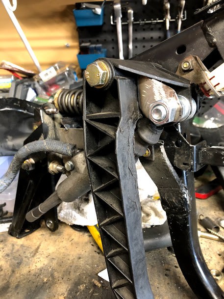

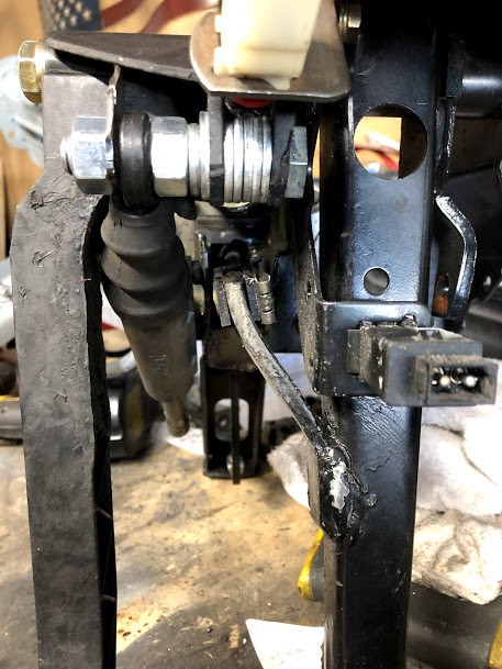

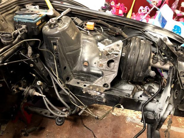

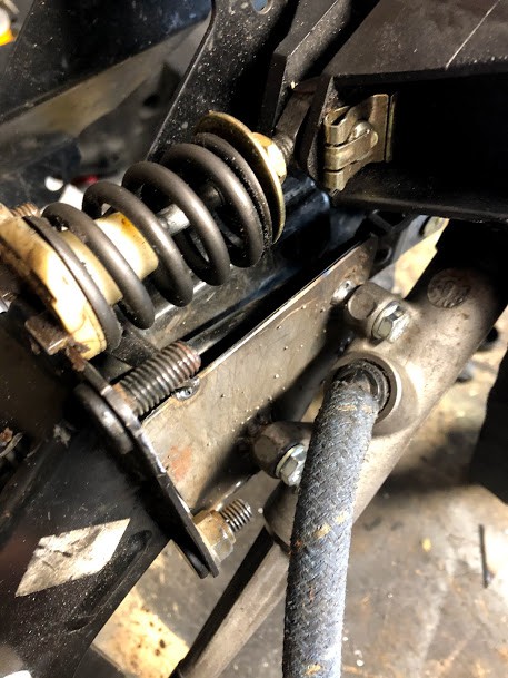

                  The brake setup has been, by far, the most complicated part of this project. Trying to get this pedal box modified to work with the e34 remote booster setup was a real chore. Following the Macalent guide, I moved attachment for the brake pedal and push rod about 3.5" to the left, shaved the plastic clutch pedal, spaced the master cylinder to the left to make room for the brake push rod, and welded in supports for the new master cylinder mounting points.
                  Click image for larger version  Name:	NPUdyScQyw3mKBuqu1xCHRDPGwTxdnSjPMZm4D9z4c-2XxkvUofiDkG6FeNM_EQ3WILAjH8v1nW5WAC31-AG51x9YaNJtqQkdHP3NIOi2ynR2--P5jT3RnIaie1s6SKJXrXZlL5qe9XPVuCF6eTWjOpTB6l7XHfYrS8oGz6EuBIgxjR2jeypKEGynOXBtTESIycU4To6t74kCQVliR35X8TEFYnOOemN47xcODuXxAHJ7aesltjtMWrDbiRUb_r Views:	0 Size:	88.4 KB ID:	9887739
                  Click image for larger version  Name:	l7tH_T3qwdUu1B30XBg8nZBkTD90UHnH_f19vZmN8zETbESE5FDKf0AEbOBeVgCLjG7fc7R8nWeOBOhperyqbBWcHmbZ32XyojGi_x-anQeYKKbS7wM9eUT4pC2dRkSDXWNXbtPRWbTQxkBHWK0FL3tIyYq5EGGyKVUuhM23LjmaTEx-dPvnq767bBXkUUDV__eyUbJ07AZyp8ckQVihvmhl6V6jBRDSCfvSPnM2yDyNDQjqr-sOkKjFgWJT1Rm Views:	0 Size:	103.4 KB ID:	9887740
                  Click image for larger version  Name:	RrdHONQ64GYtYF5bd2lStNOc5xV1NNYmZ4RVEfh9-9Bcm3y6nPzWwqWG7rtY5ZL1cWs8MWQb9uA-hBfSRCI3N8dPbyxDxYl7Xb0-EgZkgKEVzdIjsdRA3lZsJQ4i0GQLoBtyNlGaANstb8VDj_O3d-1l5Mcnqd9UC8vmRPdsLeOGf9KzM8uuHIXDLU_LN86iyhC-anfa8s-9DrLPpUA7qL4m5pkj3ZRie80YU9hdPlZ_x32AIFyo5nn90bYgYK6 Views:	0 Size:	90.8 KB ID:	9887741
                  I made a simple 16 ga adapter plate to bolt to the firewall and mount the e34 remote booster knee bracket. Then, I welded up the bracket to mount the knee bracket to the frame rail, cut a small hole through the strut tower support to run the long pull-rod through, and began figuring out how to mount the big booster bracket.

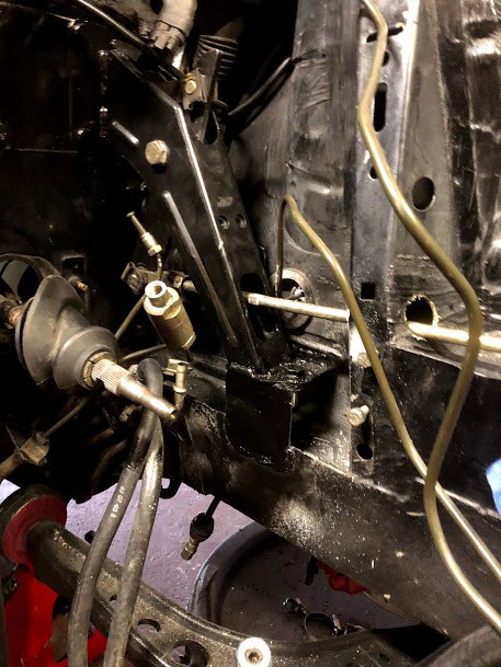

                    I opted to cut about 2" off the bottom of the booster bracket instead of cutting into the frame rail, as it was just simpler to do. I welded an adapter plate onto the frame rail and just drilled two holes through the plate and bracket to bolt it in place.
Name:	33rAGPX2gxt6rbjzMm5iPaNCJcmgX5hMZY0iNw8ik_CCpTu8HQyWLLTrd5jvEKTBCxMBYgGHDevGhn5XcrB8Nx5E32AAFQMmjL7Zy1m3OEF_GG1BdPMgo45mxZBddPe-82AztYPlgA8Vx5no_Ht90jtCUOoqvkRH9K63m5prSxESVSPBQqvKbuUQHHGw_GzscRWwedKY9iUsTTSORaWQv2p81nqbPWadcDuv8BsAo8ougcRlqk-TrgIWhgqZrGu

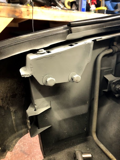

                    Then, I welded a bracket onto the wheel well that bolts onto the topside of the booster bracket.
Name:	39lI7CYbHtTJPiQqYMIm0nWMiU4RAoDx_se_O9mNDEB9Cz-zCJD0zG6Yvrys-c2naXjdK6fg26YKtY742zlY3yEl8aN0nqos_G6IqWcg7rOBBi9jqYJzSD6ri8UuHiQSCYViGXLwRZanAJZAQb_YG7Hg75XvLkStZeVUsSpYIvWwqTkLc6ldinYKYJ9jq4vAyXSD97mLzFgV0zBGSkm3_cMpO0ht1Fh1NvJ3y7b4GjXC3lovbcuZ-eaGilqUnkd
                    The last two steps will be to shorten the pull-rod and the support rod that attaches the top of the booster bracket back to the knee bracket. I'm planning to just cut that support rod and attach it to the shock tower. Things look a little ugly at the moment, but the whole setup seems to be pretty solid and functional for now. I'm sure I'll have some tweaking to do in the future, but I'm glad to have the bulk of this part behind me! I was hoping to wrap up the brake setup this weekend, but the flu had different plans for me . Meanwhile, my new chassis mount shifter and conversion mounts are on their way from Garagistic so I can start mocking up the engine and making some more progress.

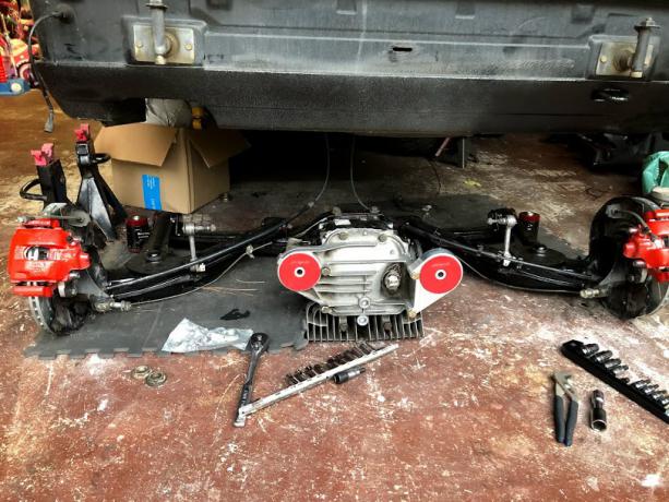

                      I got my reinforced subframe, e46 steering rack with new tie rods (e46 inner and e36 outer) and Garagistic 10mm subframe spacers installed yesterday. Today IÂ’ll be bolting the steering column back in and making a new lower profile steering shaft with two e46 shafts. Pics to follow. Sent from my iPhone using Tapatalk
