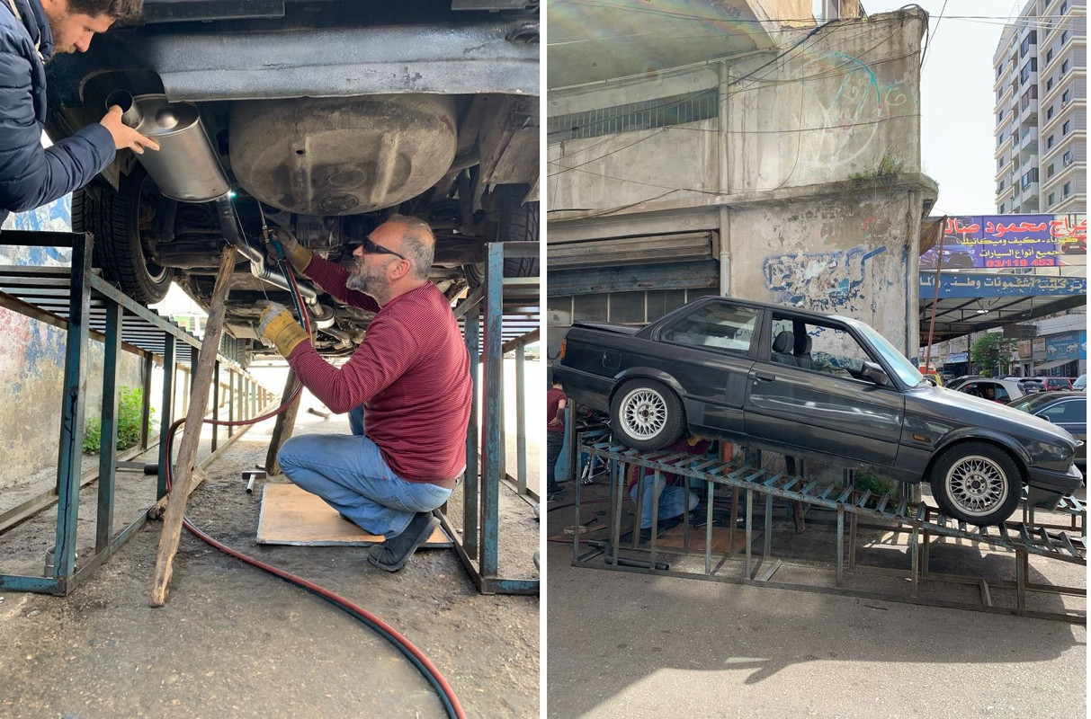

    Without a catalyzer or middle resonator, the exhaust was loud, so I got a new Walker resonator and Quite-Flow SS muffler.
    The existing exhaust was completely rotted and also in the wrong size: 2" pipe was welded after the manifold instead of the standard 2 1/4" for a 318is as seen in the below picture.
    New stainless steel muffler and resonator with correct 2 1/4" pipe.
    The old muffler fell off during removal.

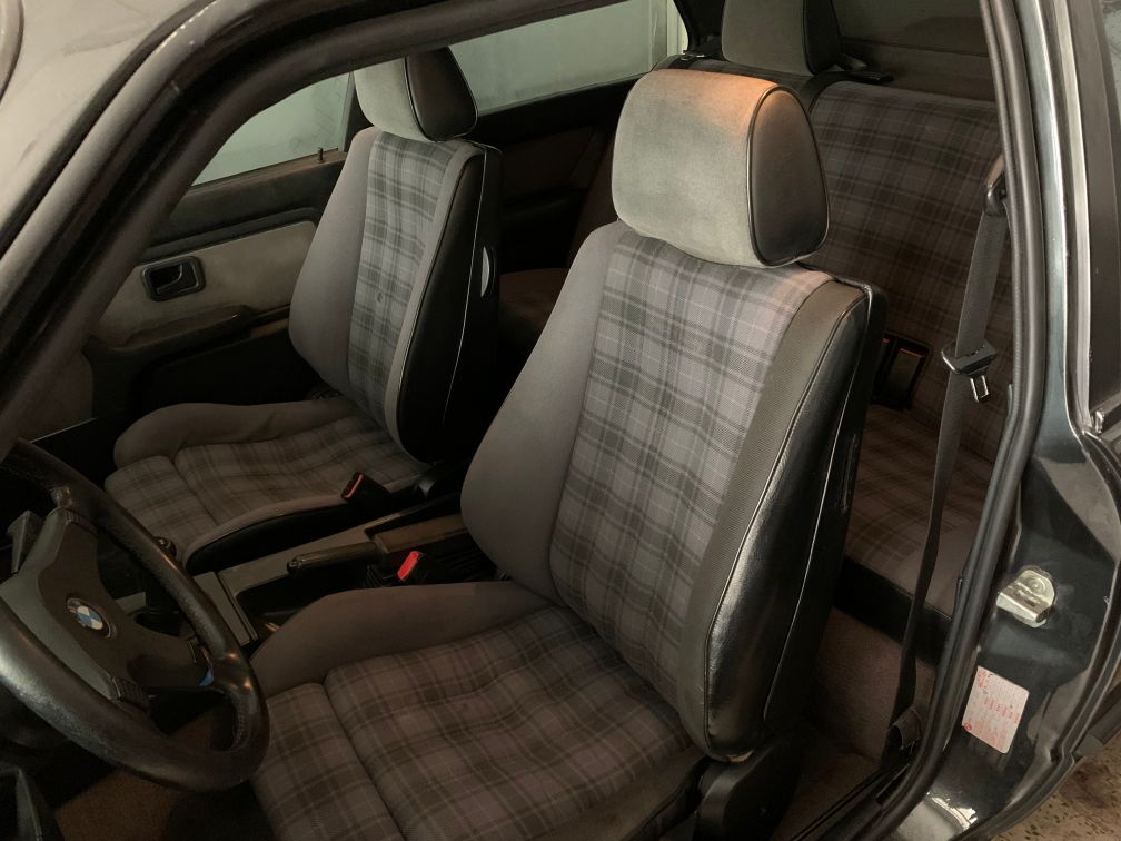

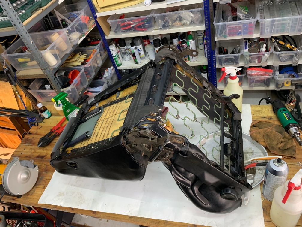

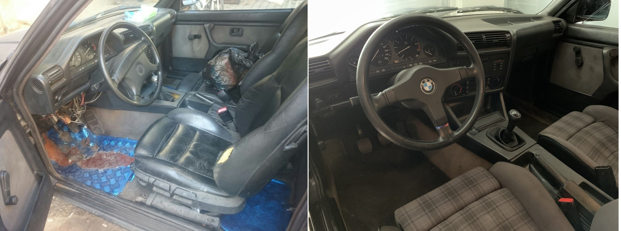

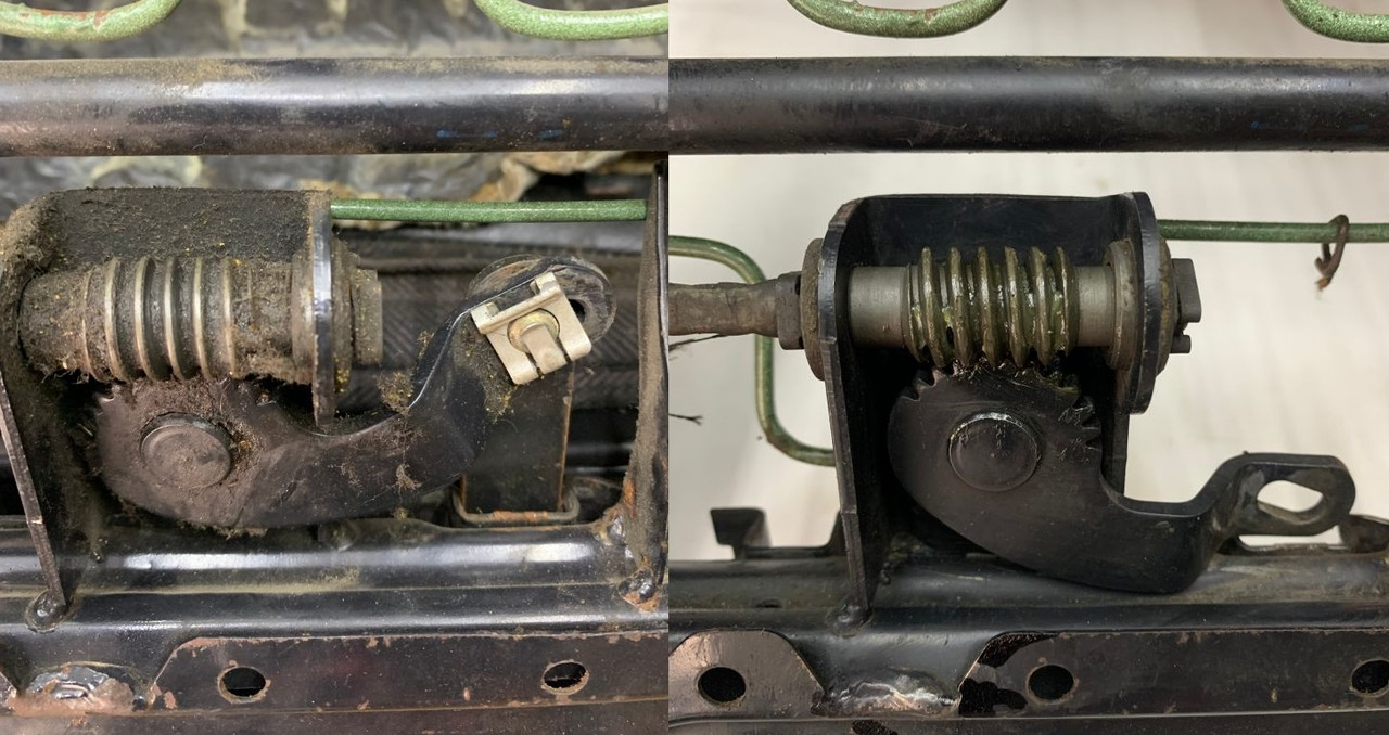

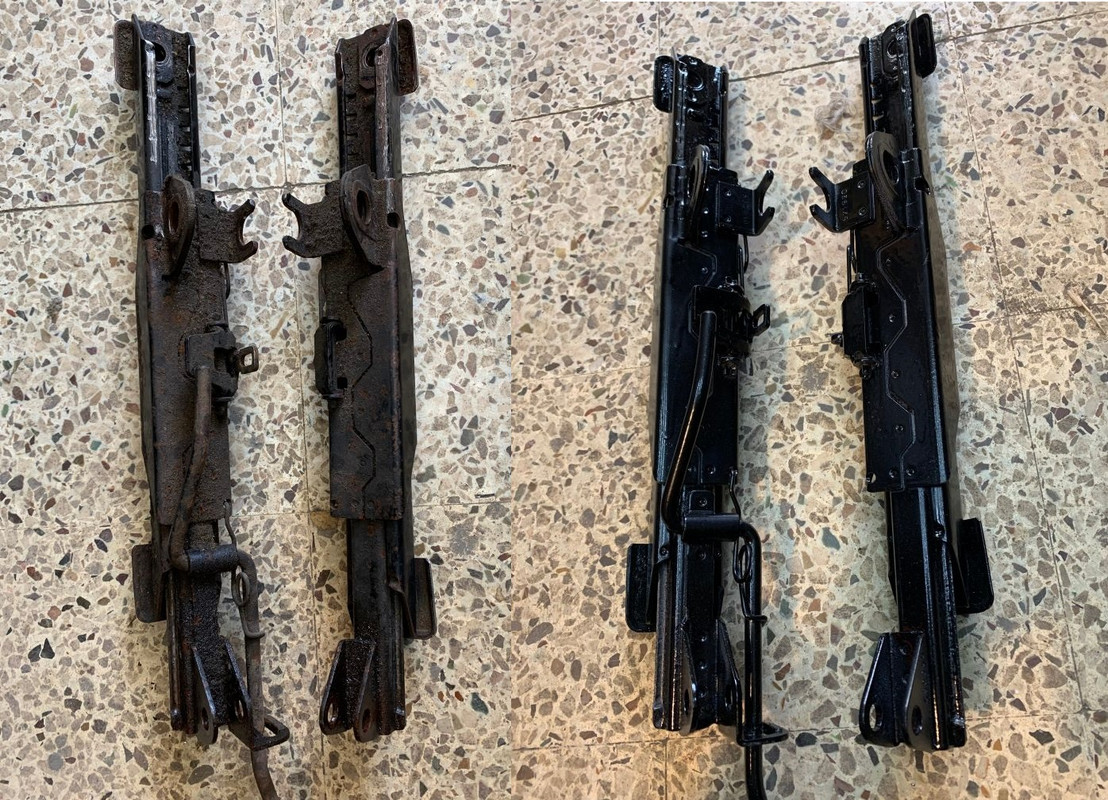

    Finally managed to get iS seats instead of the existing E36 leather seats, and after a lots of cleaning and sorting out small things below are the results:
    seat rails sanded, cleaned, painted and lubed.

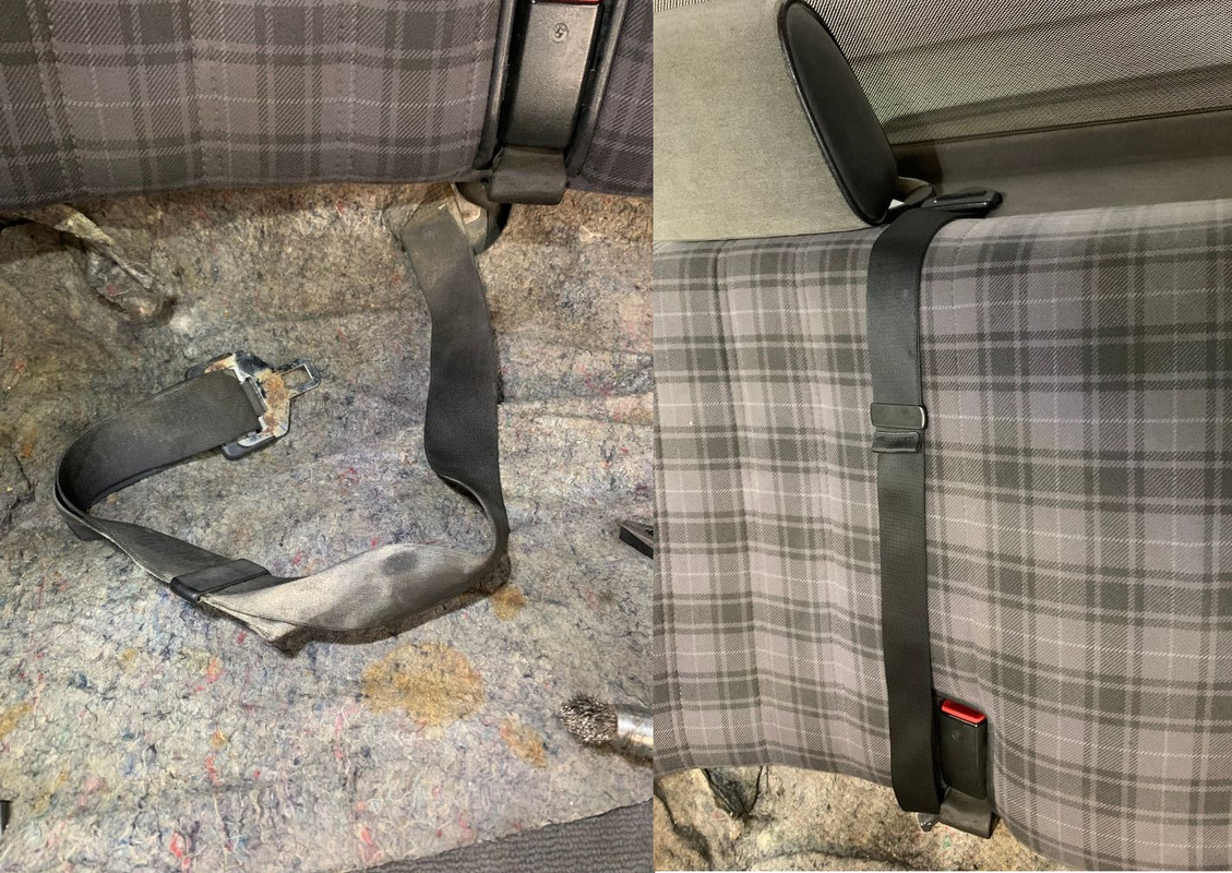

    3rd seat belt was hidden under the rear seats.
    knee pad worm gear.
    cloth cleaning
    Before and after:

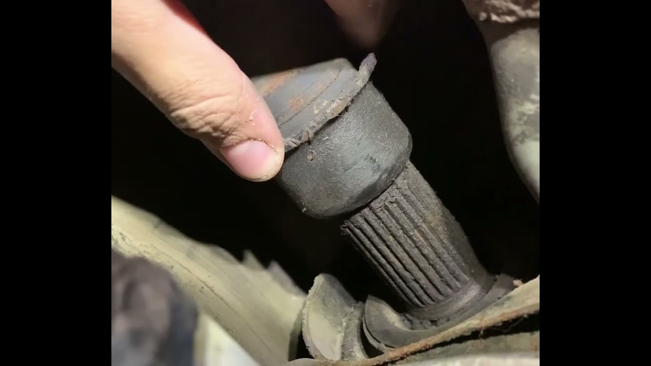

      Recently I started to notice a thumping rotating noise coming from the driveshaft, the center support bearing is solid but I there is a play in the center locking nut: the plastic inside it might be worn or it may need more tightening.
      After driving the car more, the problem was was only observed during on/off throttle or when engaging the clutch.
      As per the Bentley manual troubleshooting table this is most likely caused by a siezed sliding coupling, and indeed upon further inspection the gunk on the splines were baked in so hard I had to use an angle grinder with a brush wheel to clean them.
      In addition, the plastic teeth of the central locking nut were gone, that explains the play in my last video.
      With a new nut and fresh moly grease, the vibration is now gone !

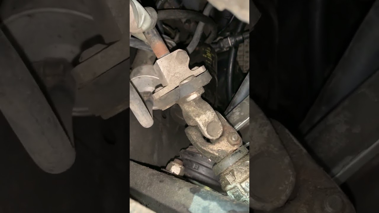

                          Finally it was the time to do the steering rack upgrade: 5 years ago I got a new Z3 rack from China for around $ 300 shipped from AliExpress (https://a.aliexpress.com/_c3QiKjTV), I believe it's the same unit sold in the US under the AAE company name model 3111N.
                          The conversion was the hardest job I've done so far, with me under the car pushing the new rack up in while dad was inside the car to mate the male splines of the steering linkage to the female splines of the steering shaft coming from the steering wheel.
                          The steering knuckle u-joint cross bearing was also replaced with a new one (model # ST1540), with new rubber guibo and plastic guide pin as I was having lots of bumps and vibrations in the steering wheel whenever I go over a bump on the road.
                          The steering was installed without the hydraulic assist, and after driving the car I felt it was a little heavy at slow speeds, so maybe will consider putting it back the hydraulic part in the future.
                          The below video shows the amount of play that was present in the knuckle before:
