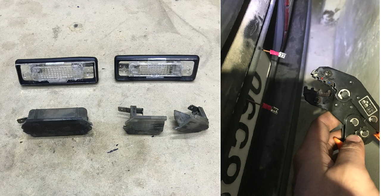

            Rear license plate lights replaced and new connectors crimped, previously it was just a wire warped around:

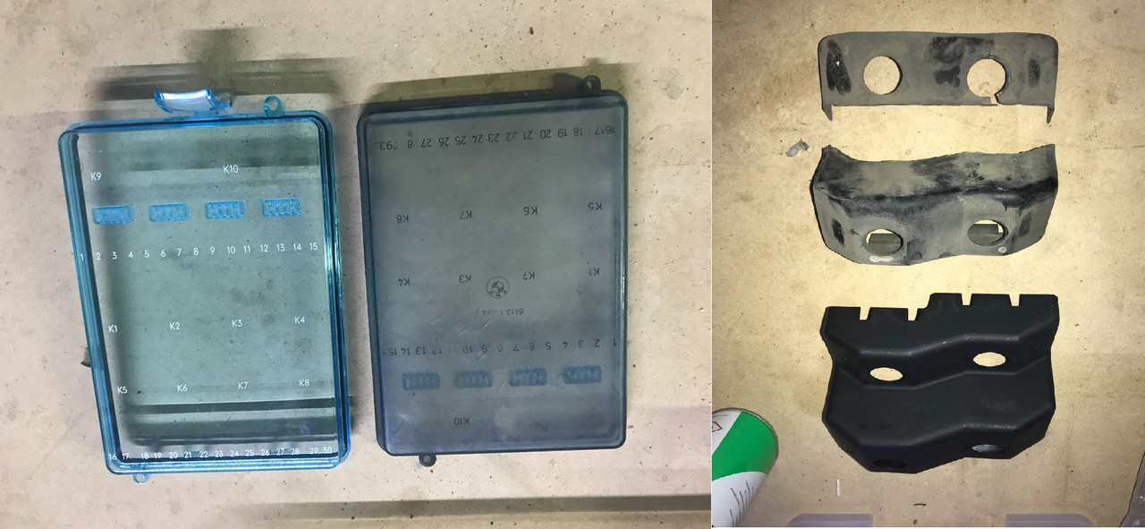

            New fuse box cover and coil pack cover:

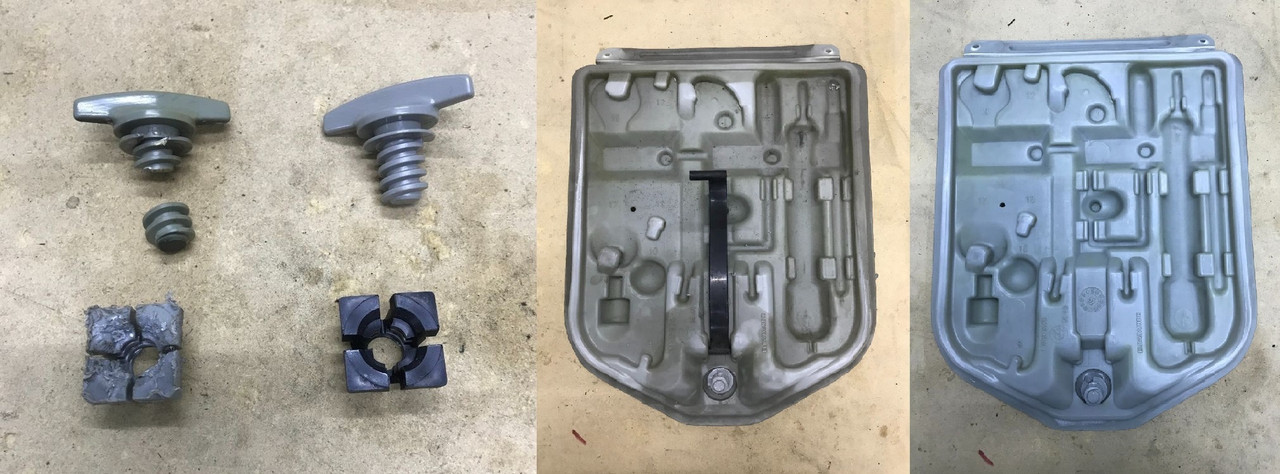

            Tool box cleaned and broken parts replaced:

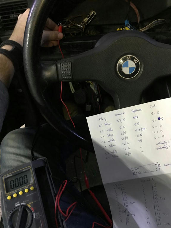

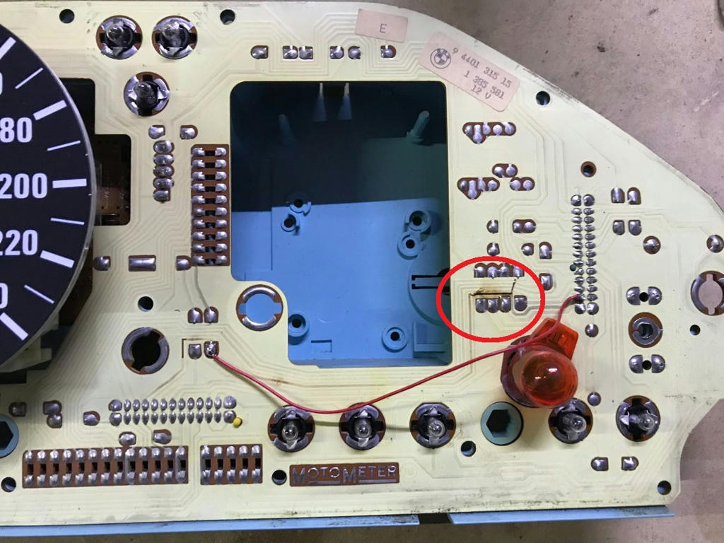

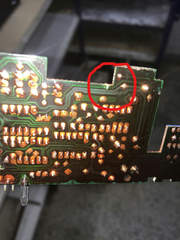

            Trying to fix my dead rpm, pulled back the SI board and found it has the infamous cluster screw damage, so it was repaired by soldering a wire to bypass the damaged path. Also the batteries were replaced, and found out that the coding plug is not for an M42, so I bought the correct one instead.
            Click image for larger version  Name:	IMG_3206.jpg Views:	0 Size:	314.6 KB ID:	10118906
            Cluster also had a path that was burnt, so I soldered a wire to bypass it:
            During my voltage diagnosis for the plugs on the back of the cluster as per the Bentley manual, I have found out that I have no power and no continuity at pin no. 2 in the C1 blue connector.
            As per the wiring diagrams, power at this pin is required for the rpm and SI board operation.
            The power for it comes from fuse no. 21 (RED/GREEN wire) passing by splice #S319 near the driver's side speaker on the floor.
            Doing some research online, I have found that this splice usually corrode and needs re-soldering.
            This will a project for another time.

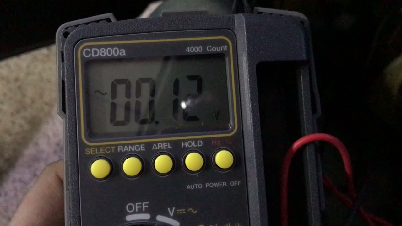

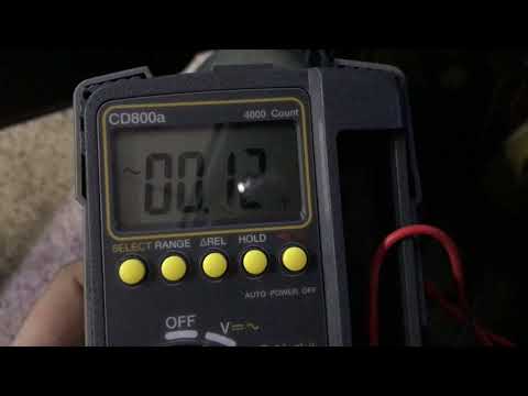

            I have also proven that I have a signal from the ECU for the RPM by setting the multimeter to AC and probing the black wire (pin #7) in the blue connector as you can see in the below video:

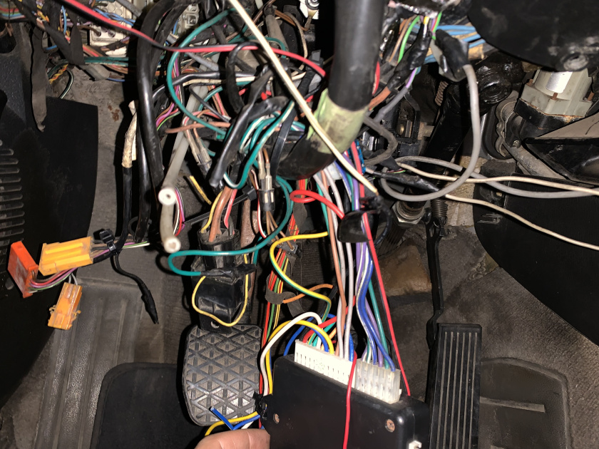

                  1 - The mess under the dashboard:
                  An after market Alarm was previously installed on the car:
                  Click image for larger version  Name:	IMG_1615.jpg Views:	0 Size:	288.7 KB ID:	10118917
                  It was a huge mess of unprofessional work where all wires were spliced by hand and held together using electrical tape.
                  I decided to remove the alarm and to install a kill switch later on.
                  First I start by releasing the stress on the wires and cut the zip ties, then for every single pig tail connected to the alarm box, followed its wires and remove it from where it was spliced into (door solenoids, ignition, ect ...) while crimping, applying heat shrinking all liquid electrical tape where required.
                  Click image for larger version  Name:	IMG_1639.jpg Views:	0 Size:	264.4 KB ID:	10118918
                  And below was the result:
                  Click image for larger version  Name:	IMG_1661.jpg Views:	0 Size:	216.2 KB ID:	10118919

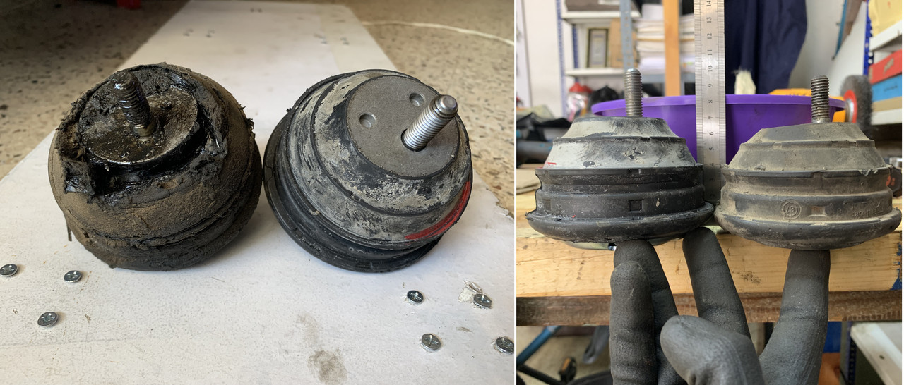

                  2- Engine mounts replacement
                  One of the mounts was completely destroyed and all fluid was out as you can see in the below picture.
                  Also they are collapsed and the height difference can be seen and now my oil pan is slightly higher from the ground.
                  During installation I faced the well known problem of the locating tabs on the M42 mounts not being in the proper location although they were original BMW ones.
                  I ended up grinding them off to be able to install the mounts properly.

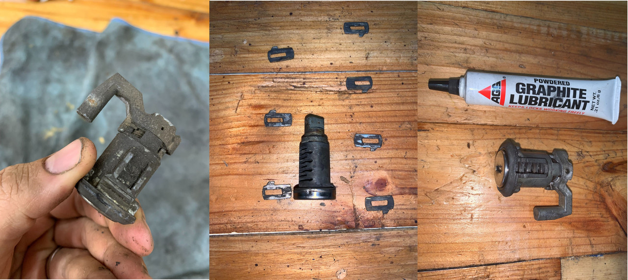

                  3- Lock barrels
                  Turning the key in the door locks is so hard I was afraid to brake the key inside, so they were removed, cleaned and lubricated with graphite powder.

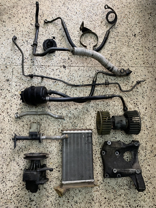

                    1- Since the A/C and heater were not working, and the power steering hoses were leaking, I decided to do some weight reduction.
                    This will be a weekend car only and will not be driven in bad weather, so I can live without heating / power steering.
                    Below are is the A/C bracket, A/C hoses, heater core, heater valve, blower motor and power steering pump, hoses, reservoir removed.
                    The compressor was also removed previously.

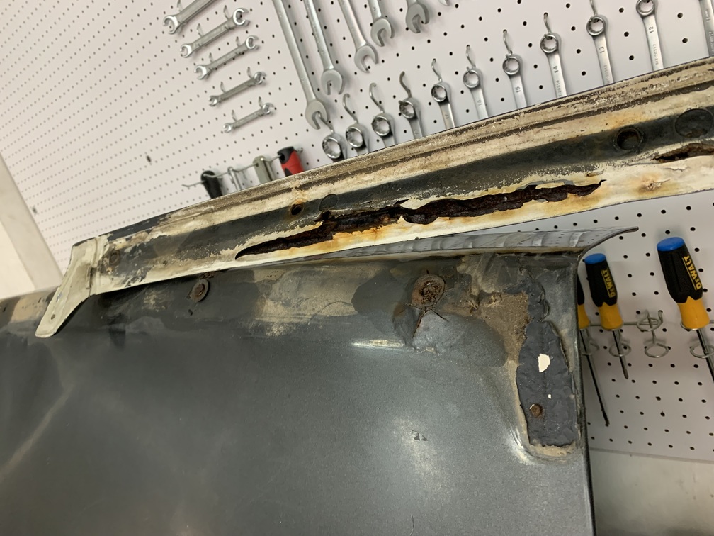

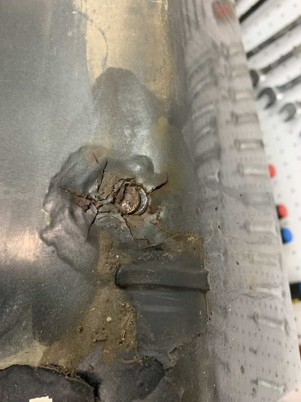

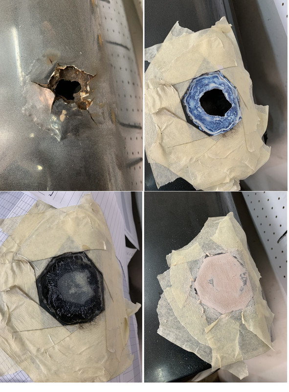

                    2- The rear spoiler was rotted from the inside cause it was fixed in place using silicone sealant which blocked the water draining channels and led to the corrosion in the trunk where the fixing nuts are:
                    drain channel filled with silicone and trunk corrosion:
                    corrosion repair:
                    new and old spoiler:

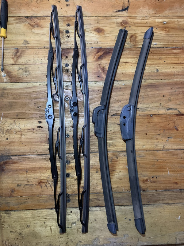

                    4- old wipers, of course they are the wrong size:

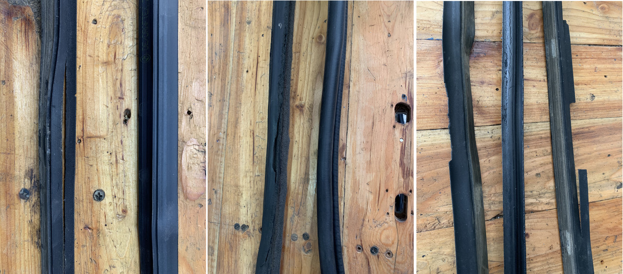

                    5- All windows weather strips replaced with new:

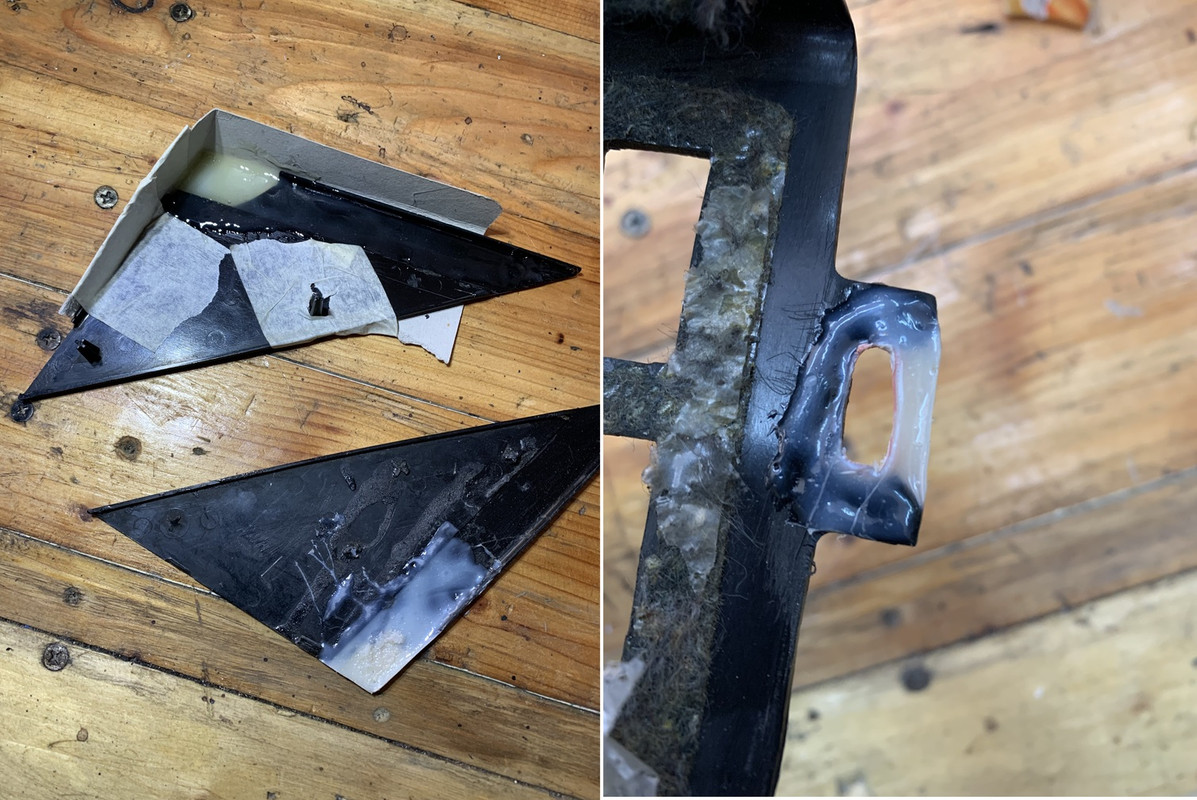

                    6- plastic molding with epoxy:

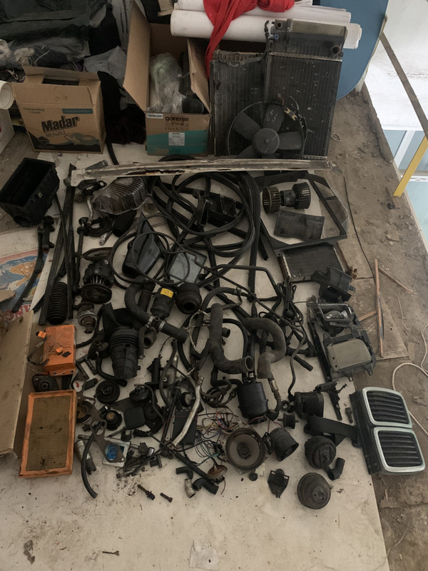

                    7 - The pile of all replaced / old parts:

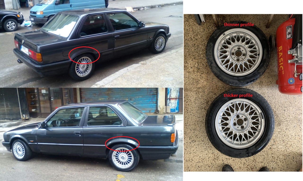

                          ​July 2022 update during summer vacation visit:
                          The car completed now 3 years on jack stands, and I am planning to take it out to test it after this repair round at the end of my visit.

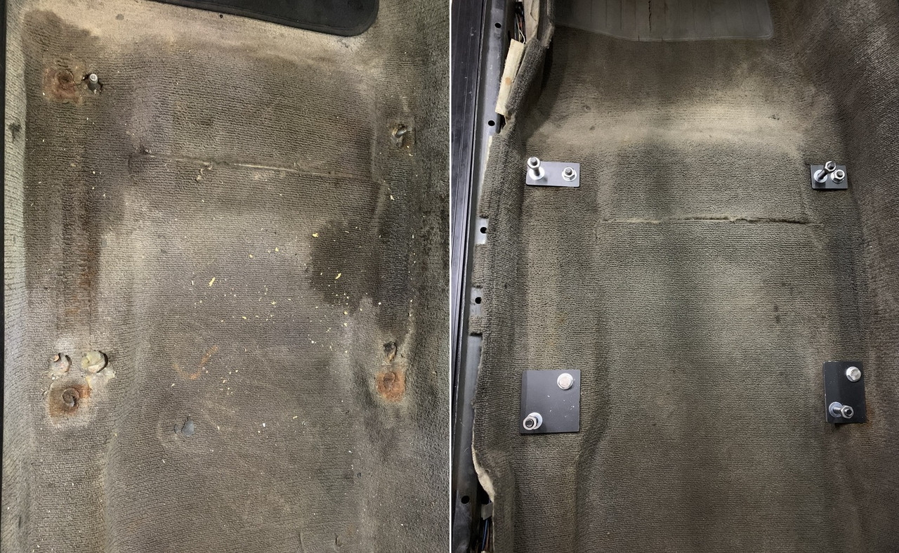

                          The E36 seats were installed with 6mm bolts (instead of 10mm) drilled directly into the floor.
                          In case of an accident, I guess the seats would have been pulled from the floor.
                          I fabricated adapter steel plates and used proper M10 bolts.
                          The seats themselves are pretty heavy and I will be looking for a chance to buy original sport seats.
                          The floor carpet was also cleaned during the process:
                          I decided the car should be as simple as possible with the main focus on driving, so I replaced the radio with a delete panel, removed the speakers and installed fog lights covers:
                          The tires were dry rotted and starting to show some serious cracks, so I decided to replace them.
                          To my surprise, and after all this time owning the car, I discovered that the 4 tires were not all of the same size !
                          Two of them were 255/50/15, and the other two were 255/55/15.
                          The thinner profile tire can be seen in the above pictures, that’s why the car was sagging on one side and showing different fender gaps when I first got the car:​​
                          I bought four new 255/55/15 Marshal tires (Korean, part of Kumho brand) keeping the original size:
                          Screws were used to prevent the center caps from being stolen, not an elegant solution.
                          I will use some set in screws instead later on.

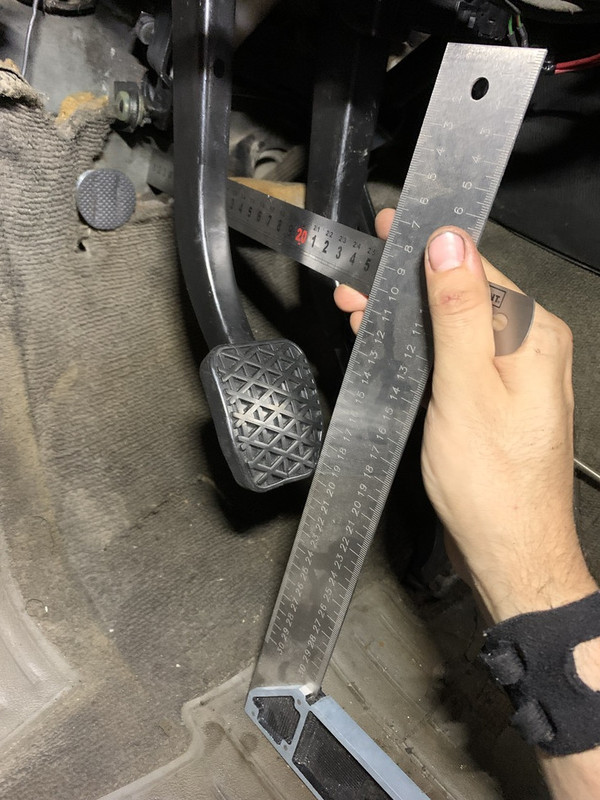

                          Clutch pedal eccentric bolt adjusted so the clutch pedal distance from firewall is between 253mm and 264mm as per the manual:

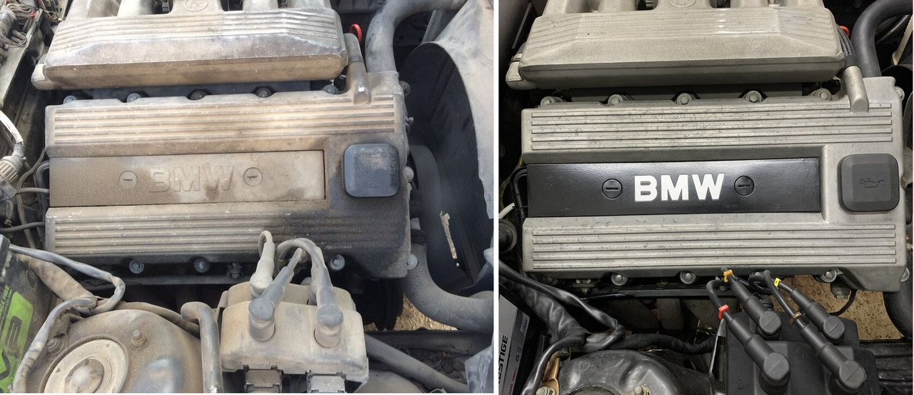

                          Current engine bay pics compared to when I first got the car:
