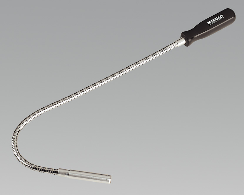

                    Here is you best bet IMO,
                    remove oil pump drive gear cover, remove the gear and try fishing it out with the magnetic pickup tool. Removing that cover will give you the access somewhere in the center area of the pan. I would use a flex magnet tool instead of telescopic but the telescopic might work too. Use the magnet from the bottom of the pan to walk the nut closer to the area where your pickup head will be located.
                    Hope it will work.

                      #430
                      This could work.
                      I do things.
