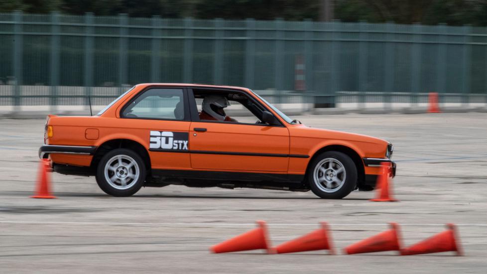

        Ended up meeting up with a friend who works for the Xtreme Experience, got to do some hot laps in a GT3.
        Skipped the track day, and did autocross ride alongs, the course was set up for drifting, so I spent about as much time trying to hunt cones as I did sideways, that was fun, but I need to stiffen the sway bars, she was leaning all over the place.

          Few race pics:

              Great action shots! Sounds like you've pretty much got everything sorted or a plan in place to correct issues.

                      This is a great build thread, nice work Melon your car looks fantastic.

                        Man. Car looked great going around the track and you looked quick.

                          looks like a lot of fun! glad this car is getting used! I predict that these future minor modification result in a little bit more and then a little bit more and then you'll have a car that is full track.
                            Not as quick as I hoped!
                            The time shown was 49.2s, my best clean was 49.4s
                            Friend of mine in an NA Miata managed a 49.0s
