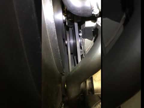

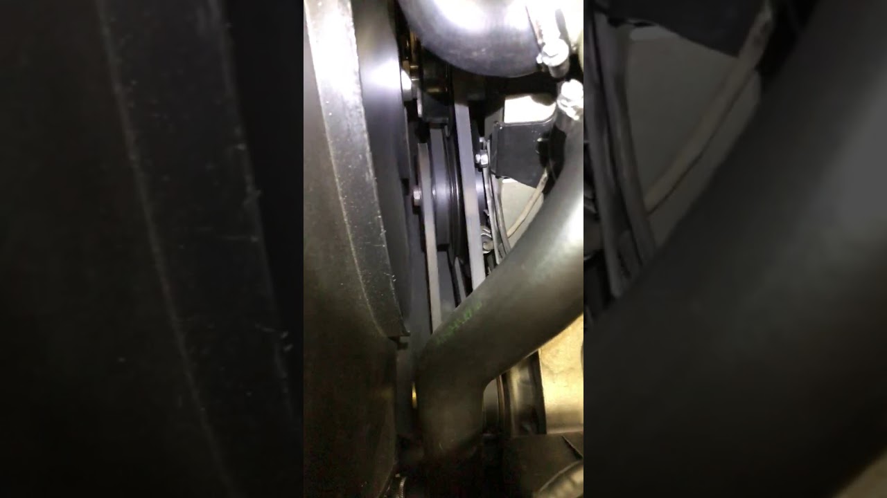

                              Had a weird thing happen yesterday after work. Pulled into the garage and noticed a weird rattle coming from the engine bay. Car was driving fine, and I was hauling on the way home too. Noticed my harmonic balancer and power steering pulley seamed a bit loose. I went out this morning to take a better look after the engine cooled down and sure enough, the six bolts holding the pulley and balancer were loose to the point that I'm shocked they didn't come flying off:
                              I had torqued everything to spec according to the Bentley when I did the timing belt/crank seals, and all it called for were some wave washers on the bolts, no LocTite. Needless to say, they're Loc-Tite'd, and they ain't going anywhere now. Wasted the better part of my evening fixing that boo-boo, as I continue to lose time on breaking the car down. The Vintage is looking less and less plausible at this point, sigh.
