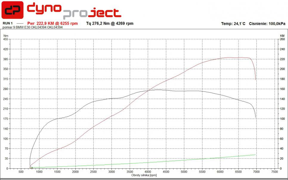

                          I've never heard of that power unit (KM). What is that in HP? Or is that just HP in Polish? Looks like it makes about 220HP.
                            yes, KM means HP in Poland ;) it makes 223HP. Not bad but i will try to achieve a little bit more :D

                              so 223HP on stand-alone, upgraded injection sequencing, ITBs, headers and that's about it? That's pretty damn cool to me! I bet it runs butter smooth too.
