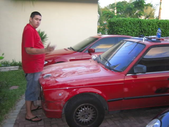

    Well in my intro thread some people wanted to see my ETA. I just bought it the other day for $300.00 big ones. The car runs great, brakes and tires are awesome. The outside sucks, the a/c doesnt work, the gas light is always on empty, the rear windows dont go down, and the shocks are bad. But over all nice.
    I know this thread might not be as cool as others but i try. :)
    Stock:
    Removed front end:

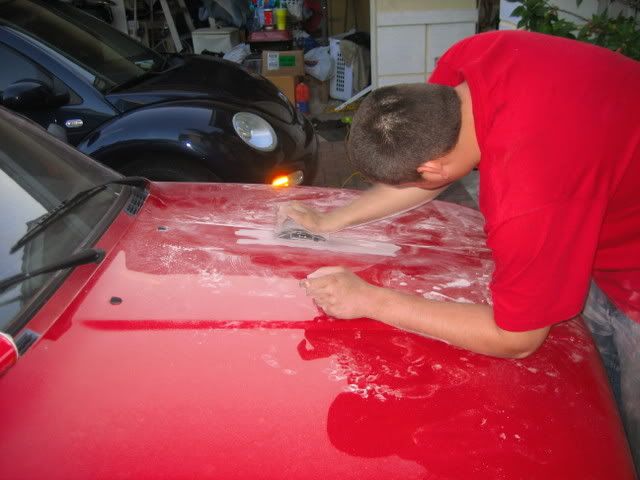

    My good friend Steve-o helping sand the dents in the hood:
    More Bondo:

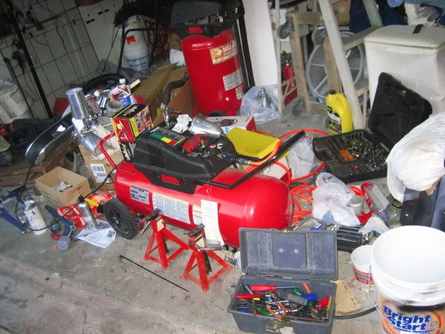

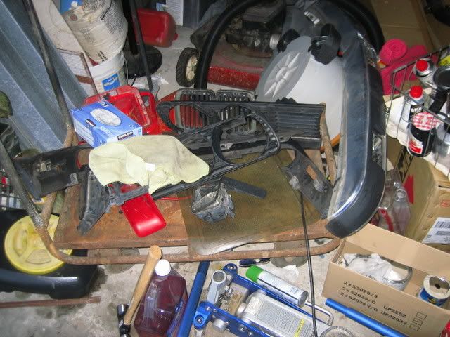

    Pile of Parts:
    Look at my messy Garage:

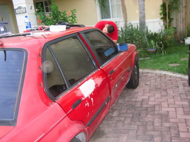

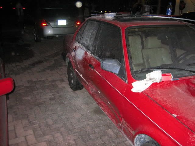

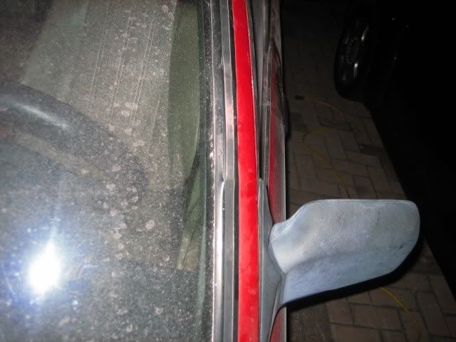

    Door Moldings Removed And WindowTrim. Does anyone know how to remove the moldings from the front doors?:

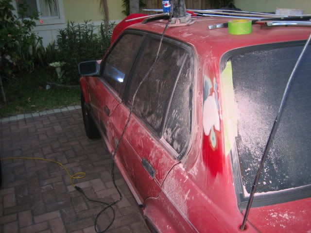

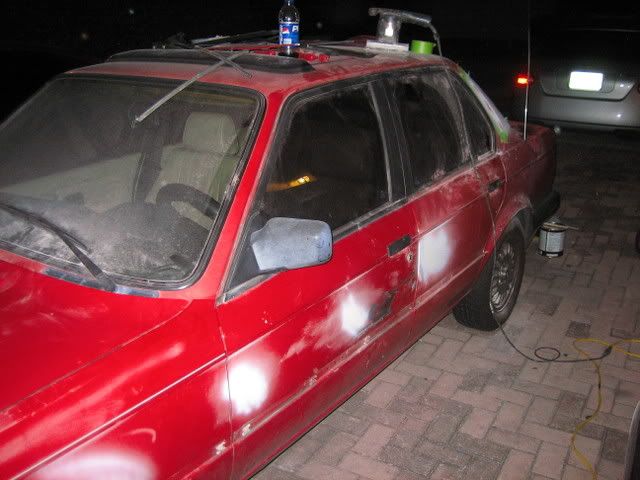

    Drivers Side Almost Done:

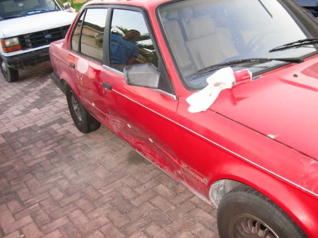

    Passenger side:

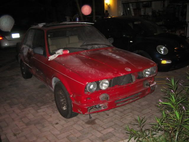

    I Ran Out of Primer and it Got dark, so Flat white paint will have to do:
    Front End:

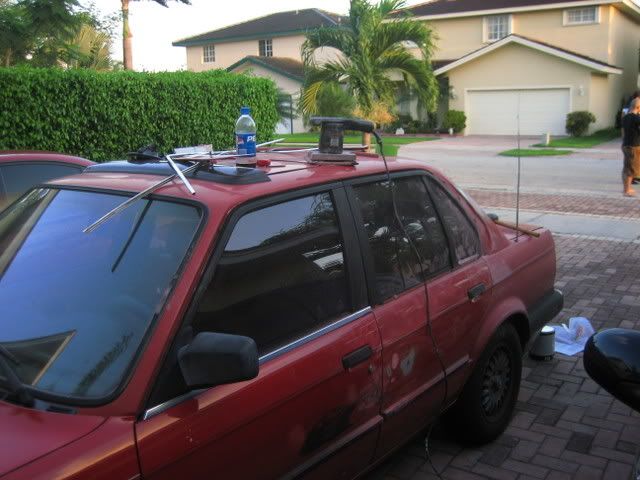

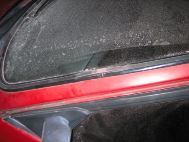

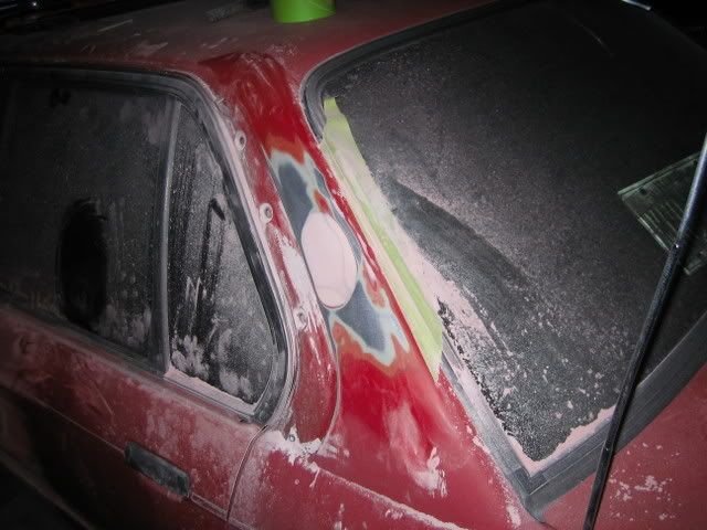

    Is This How You Take Off The Rear and Windshield Modling? If so, how do you put it back on?

    I have orderd a Rear plastic Bumper, Sunroof in process ,and passanger door. All i need is the front bumper, valence and is lip

      That's how i took my windshield molding off. When i put it back in, i put one side under the rubber gasket and used a small flat screw driver to roll the other side of the rubber gasket over the trim.
        Ohh ok. I was afraid i might ruin if i took it off.
        That is going off today.

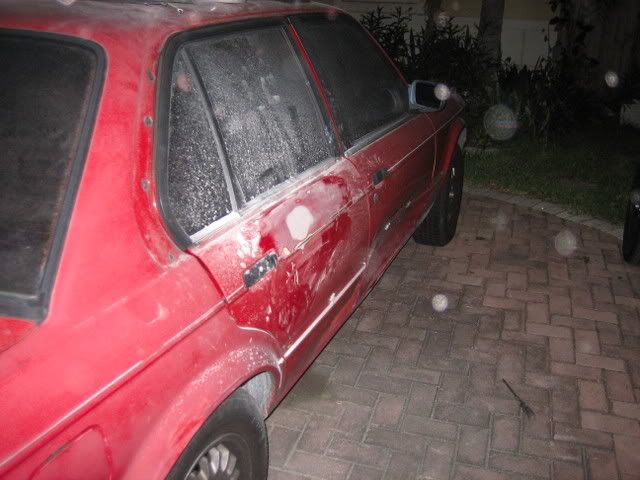

              fuck dude i wouldnt waste $200 on having maaco spray that thing, you filled big ass dents with bondo.
              if thats how yer gonna bodywork the car id hit it with a spraycan.
                Why?
                The dents are not that big. No more than 1/4 inch deep, if that. Is that not how body shops fill in dents?

                  most body shops use little anvils and body hammers to roll and knock the dents out, fillers (like bondo) are usually only used to fill imperfections if the body was creased and couldnt be repaired 100% and 1/4" is pretty deep. you should expect some cracking within a few months if you bondo'd big dents

                    thats the way to learn man,... i applaud you for taking a piece of shit and making the most out of it. good job and congrats on not having mommy and daddy drop 3k for paint

                      I dont think he is going for a show car finish, the bondo will be fine, i've seen worst done to cars.....and we didn't find out until trying to strip it to bare metal, only then did we see what the previous hacks did to it.
                      let the kid learn.

                        Keep going it will look a lot better when you are done. Just don't try to fill the BIG dent in with bondo. Get a new door and paint the car flat black and it will look good. Good luck and keep us posted.

                          You must remove door mirror to get that moulding strip off.

                            why not just buy a straight hood from a junkyard instead of bondoing a dented one?

                              Black Box: My goal in this project is to stay on a budget. Plus the location and nature of those dents it is not that bad.
                              Rocla: Thanks, i will do that tommarow.
                              Mastrcruse: LOL, yeah i know. I alreadt put a door on it, i just havent updated because of my cam battery died, and it rained today.
                              T.Dot E30: Thanks, i want a nice DD. I know a good amount about paint and know what might happen, but like you said it does not have to be a show car. for the amount i am investing i kinda know what to expect.
                              blunt: Thanks.
                              Jparkr2004: Wow, you scared me. I dunno they are not even 1/4 inch, maybe the worst on in its deepest spot. I dont want to get any cracking. :(
