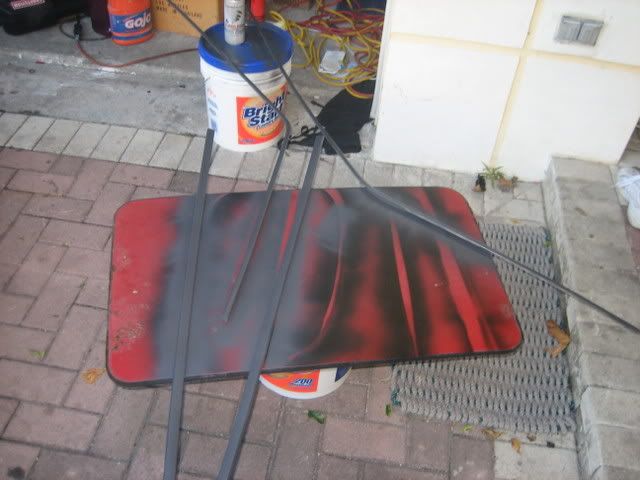

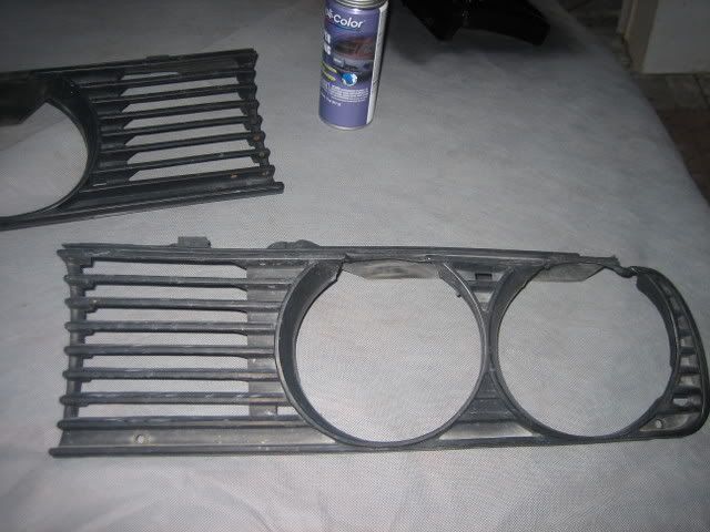

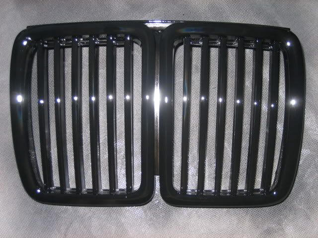

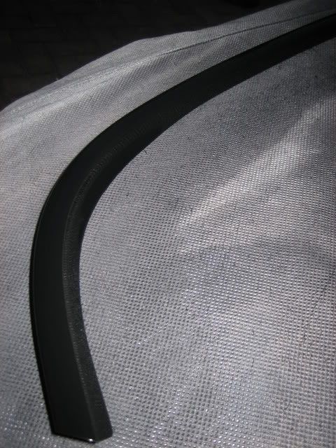

          So here is a real small update.
          The car should for sure go off to paint tomorrow. That is when I should pick the final color. After I get It back I have to buy clips to put the moldings back on, and fit all the bumpers and lights and what not.
          I have been really busy with work and school, and have been sick, so I didn’t get much done in the past week, but here it is. The camera died so I didn’t get all the final photos.

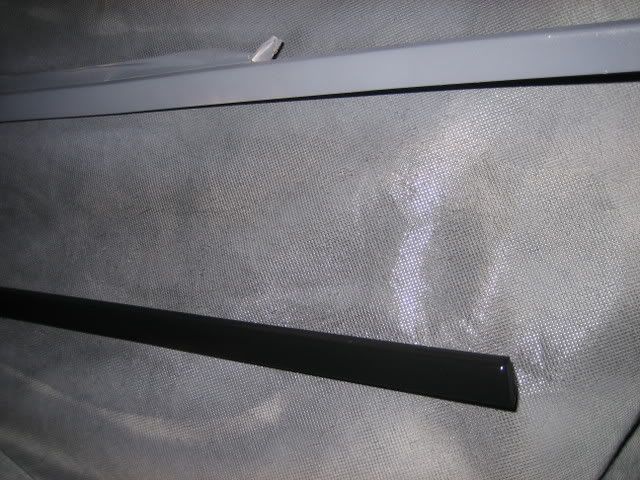

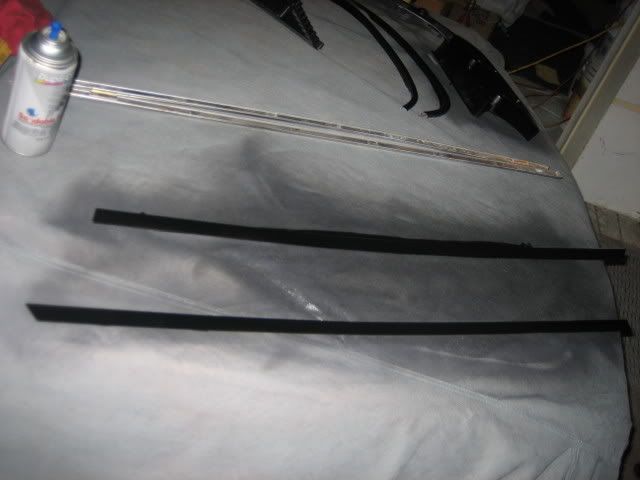

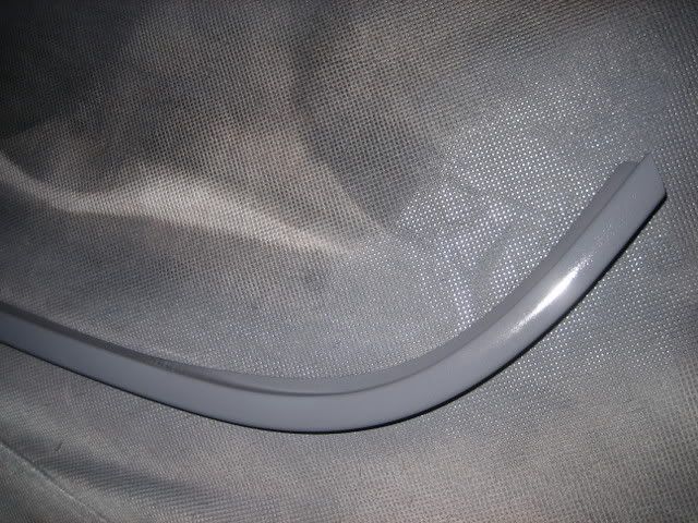

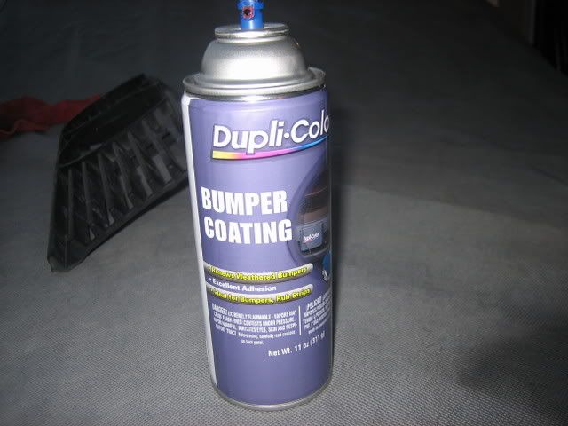

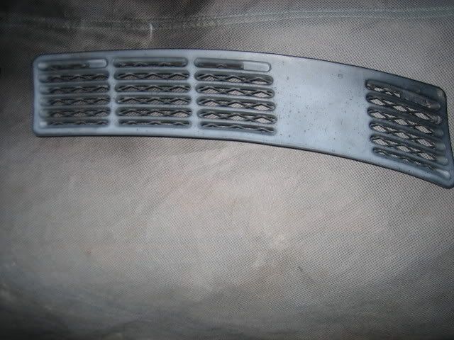

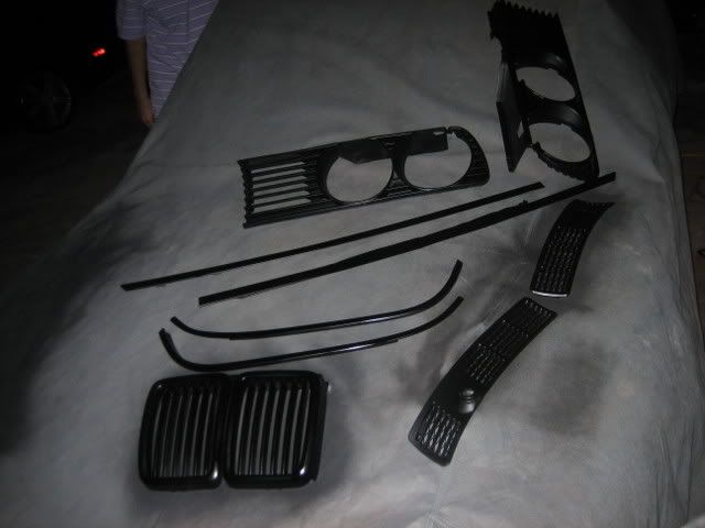

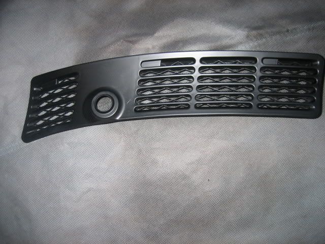

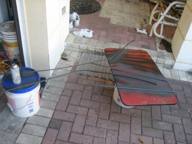

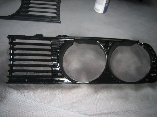

          I painted the trim, and re did all the black plastic on the out side.

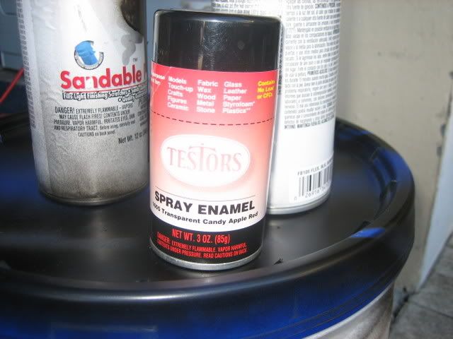

          This is the product I used.

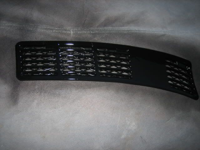

          Before pic of vent.
          After

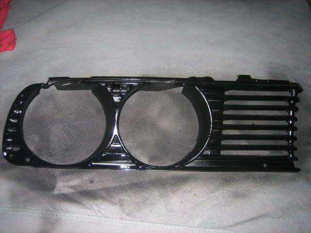

          Front Grille
          Almost done, but no final pic

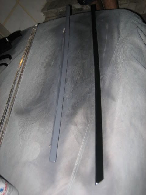

          Shadow line trim
          All I have done that day
          I am not sure yet if I am going to gloss the shadow line trim. What do you think?

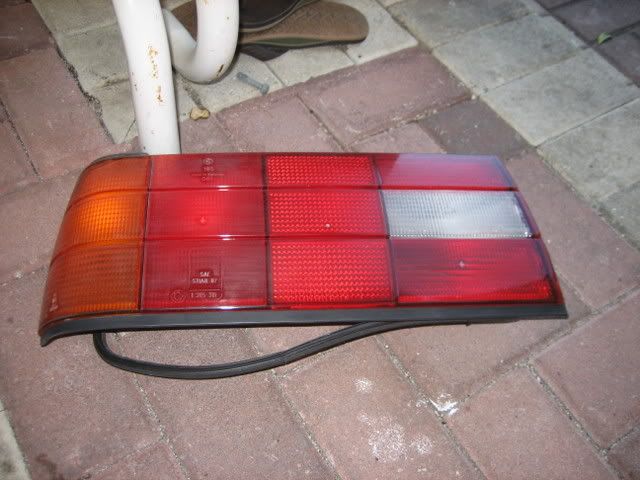

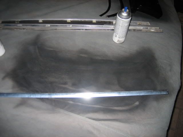

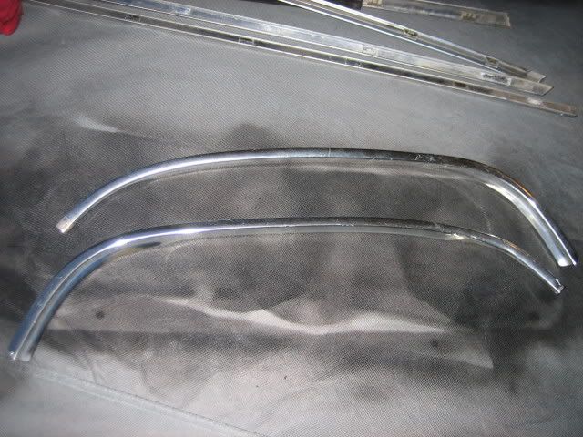

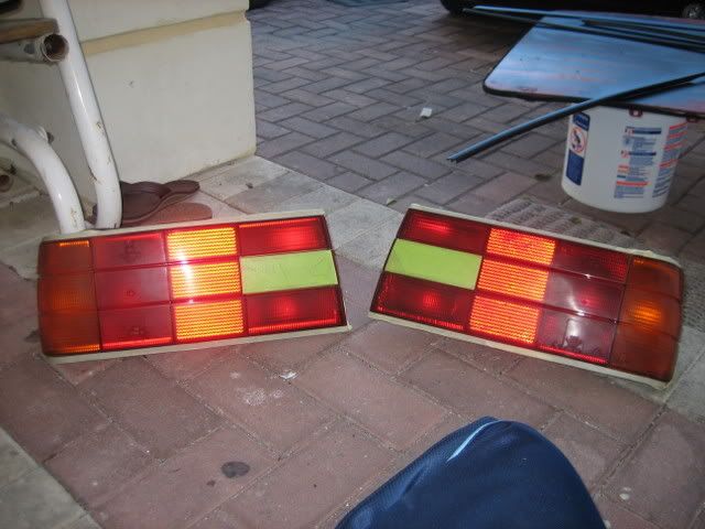

                          #42

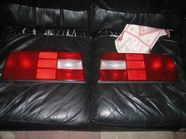

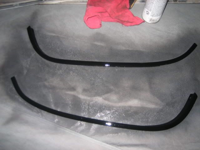

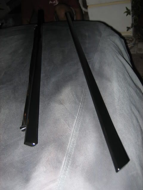

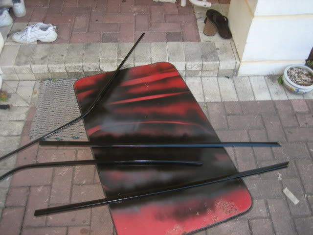

                          The car is in paint right now, hence the reason for no updates. But i am trying to do what i can.

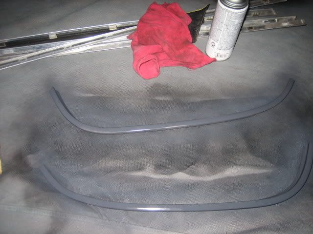

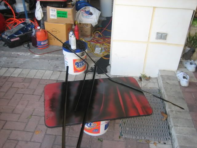

                          I have partially finished the Shadowline trim, i just need to clear coat it.
                          I had to redo the ones from last time:
                          Primer the new pieces:
                          Paint them:

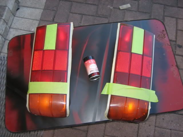

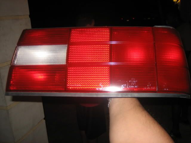

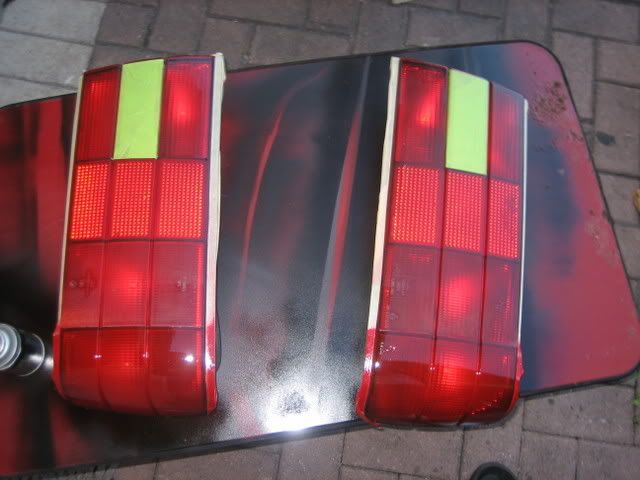

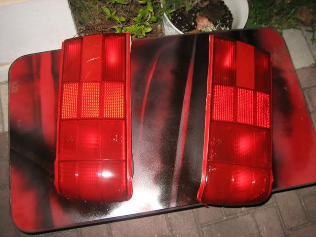

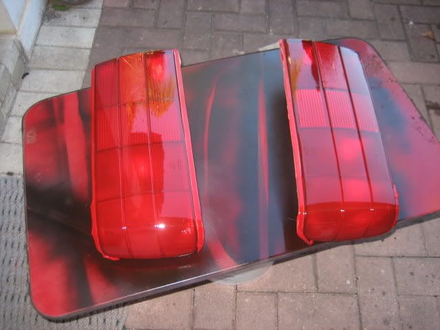

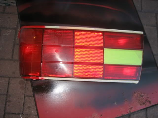

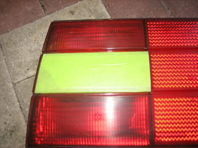

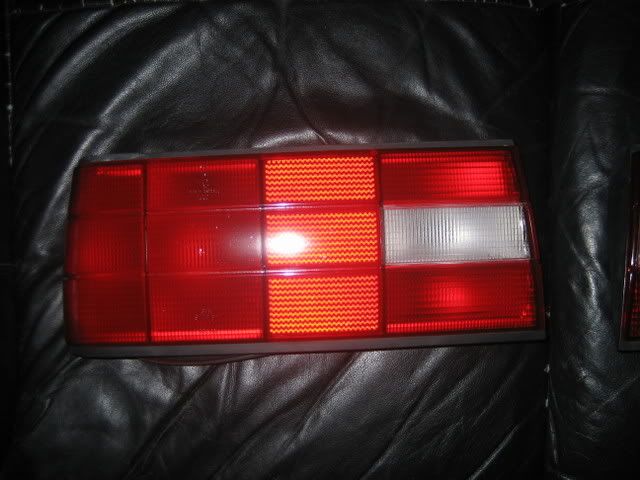

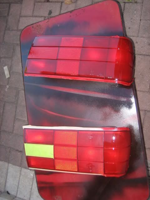

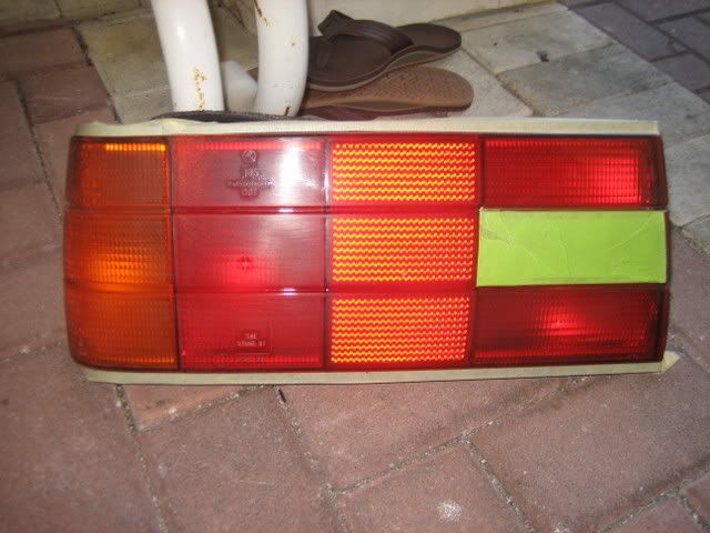

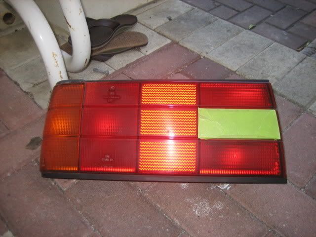

                          Now here is something that could be done on an e30, e36, e46, or any car.

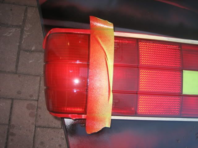

                          Sand down the lights: I used 500 grit sand paper and wet sanded them.

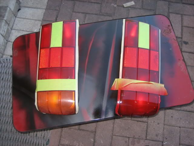

                          Tape up what you want to stay clear: I did the reverse light.

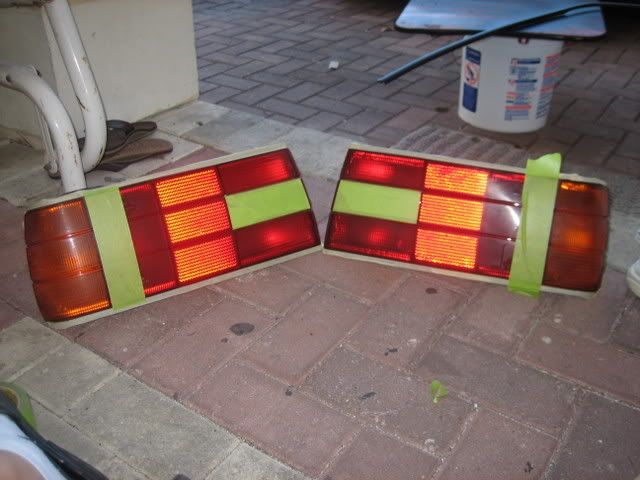

                          Also i did the sides:
                          Other side: Make sure your tape is adhered good, and the lines are straight.
                          Both of them together:

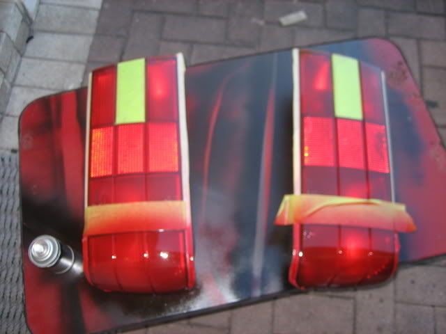

                          Now tape up the area around the amber, you will be putting a coat of red on this first to equal the color.
                          This is what i used:
                          A comparison while painted:

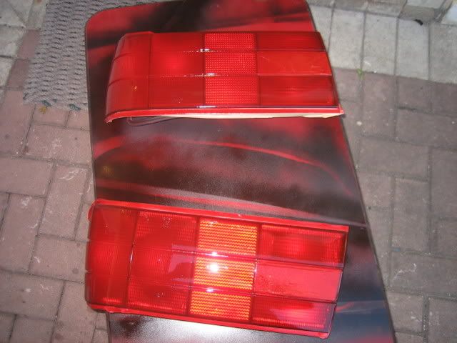

                          Both painted:

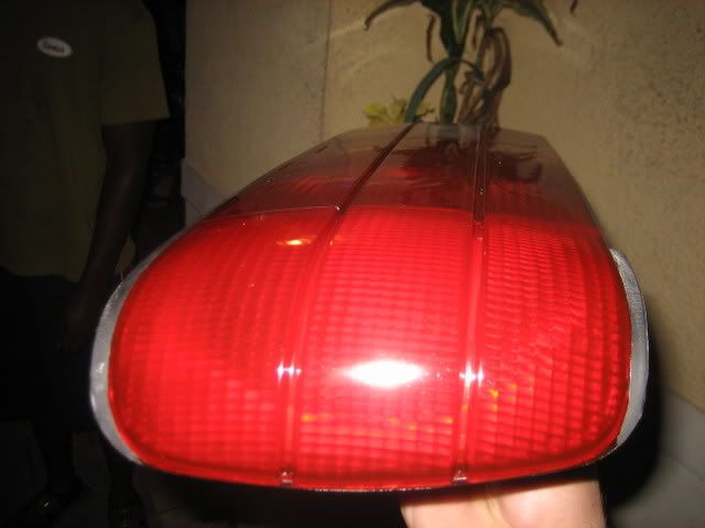

                          Tape removed: Notice how the colors almost match,
                          Comparison, Side by Side: One complete
                          Both Complete:
                          Tape Removed:
                          One ugly mother Fu(ke*
                          Final Complete Shot.
                          At this point you could choose to leave or clear them. I highly suggest clearing them. I am using automotive grade clear. I just need time to do it.
