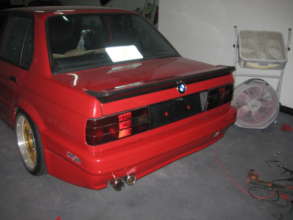

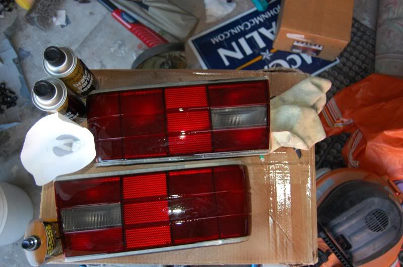

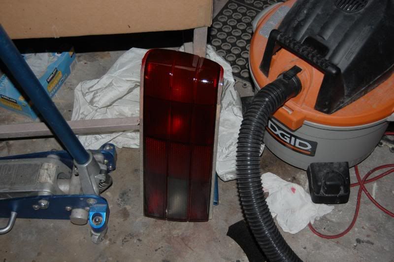

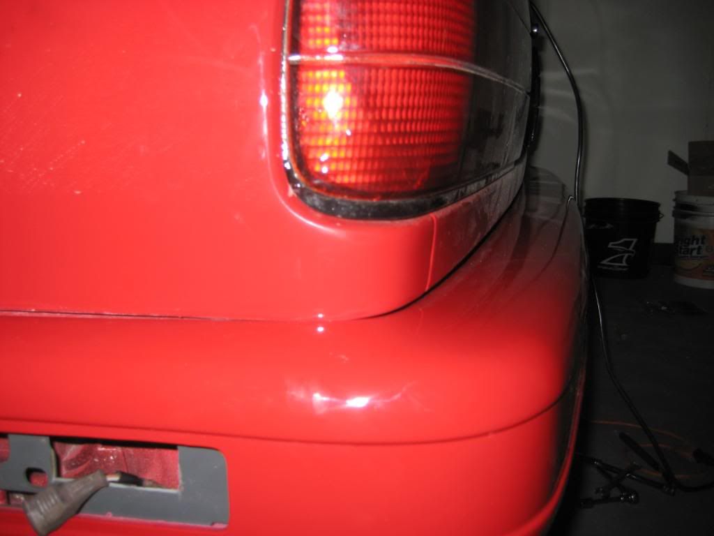

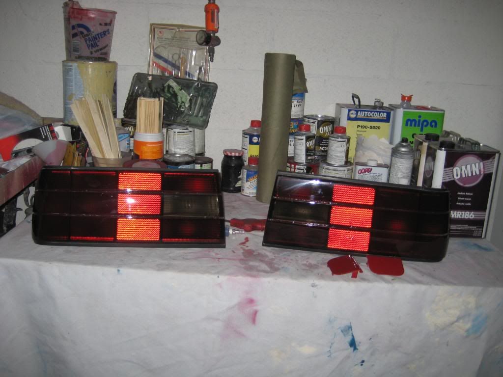

        Looking better every day! Nice work, I think the tails look excellent. I do see what you mean though about the driver's side being a tad darker, could you just shoot the passenger side light with a light coat?
          i think it bothers me but its cause it doesnt require me to do the work to fix it. if i was in your shoes id just be too lazy ahhaahah
          AW 89' 325i Vert - SOLD
            Lol, thanks guys. I ended up, well I am fixing them now. I couldnt stand them not matching.

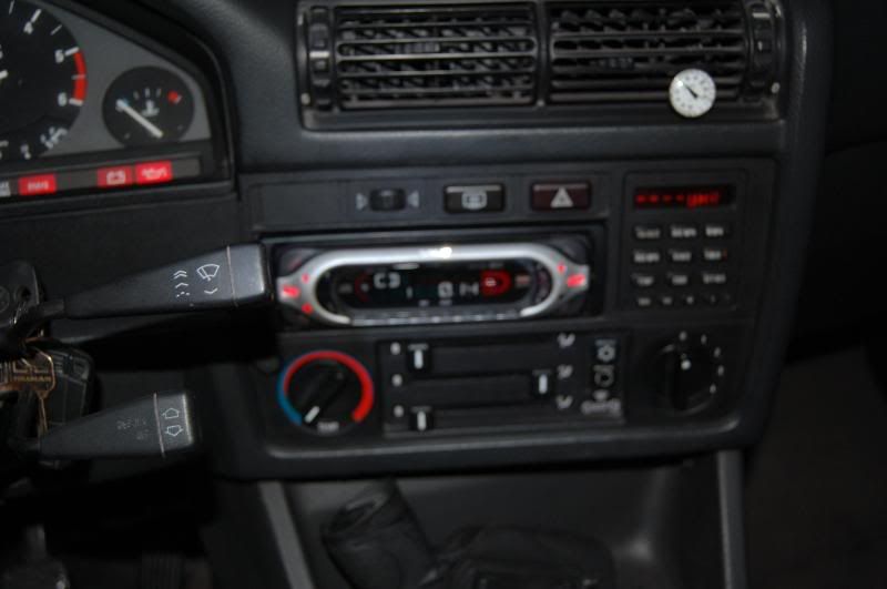

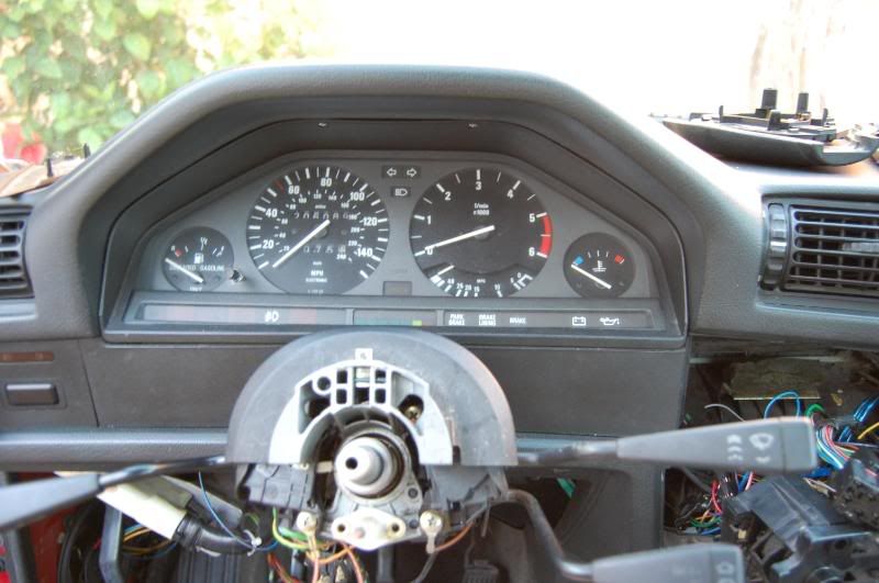

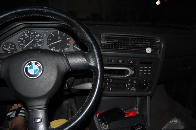

              Since October I have been having issues with my obc. One thing led to another and it never worked. It bother me to have somthing so small and simple not work, so I had to fix it.
              I ended up buying a 13 button OBC.

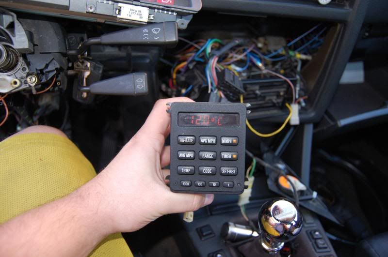

              Here is my old 6 button

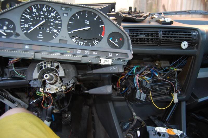

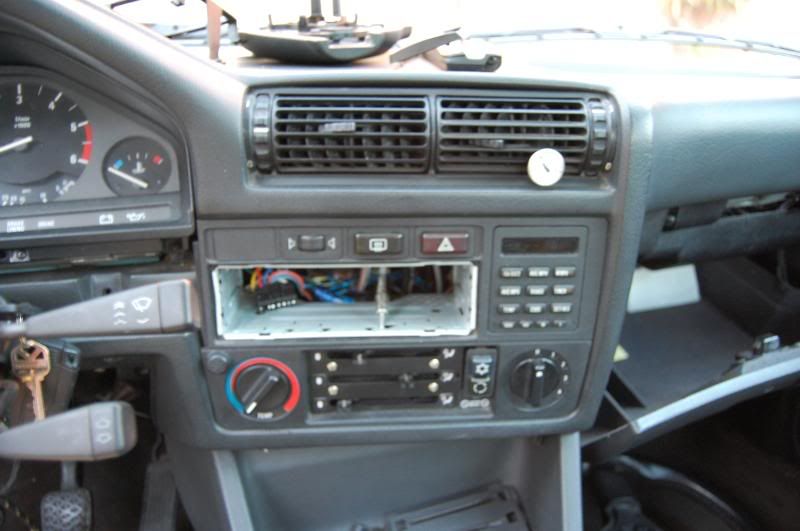

              Working to remove the old OBC
              I ended up installing my 13 button but it still didnt work. So I took a break to finish it the next morning.
              While thinking about it all night I finally figured it out. It all stopped working when I changed out my cluster. So I ran outside in the 50 degree weather with my old cluster with just Temp and Gas guages on it and plugged it in. To my suprise it worked. Kinda. The lights didnt turn on, but that was a common issue with these OBC's.
              So I got my "new" cluster and took out all the guages and SI board and swapped them onto my old cluster. Everything worked fine. Minus the lights.
              I quickly swapped out the rear bulb, that worked :) I had to wait till the morning to go to radio shack to change the light bar. The light bar at the stealer is +/- $30.00 I fixed it for $3.20 and some solder. Now is time to put it all back together.

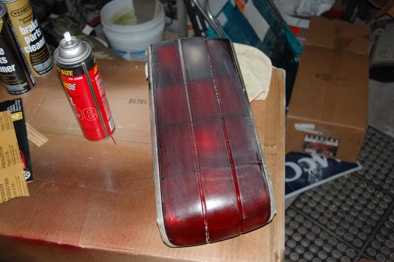

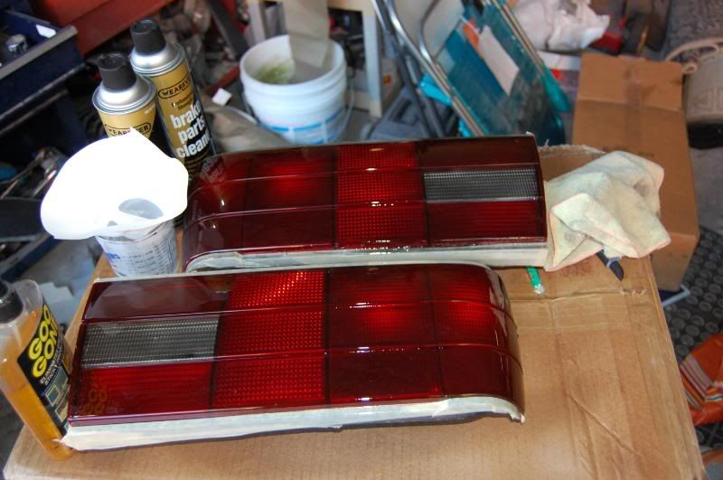

              On and off I have been fixing the color on the tails
              They now match pretty well
              I wetsanded and touched up a few parts. I should be able to finish them soon

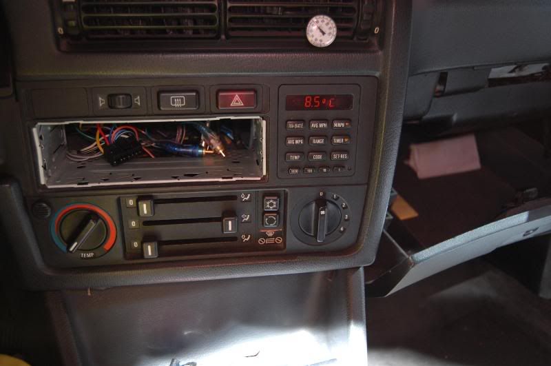

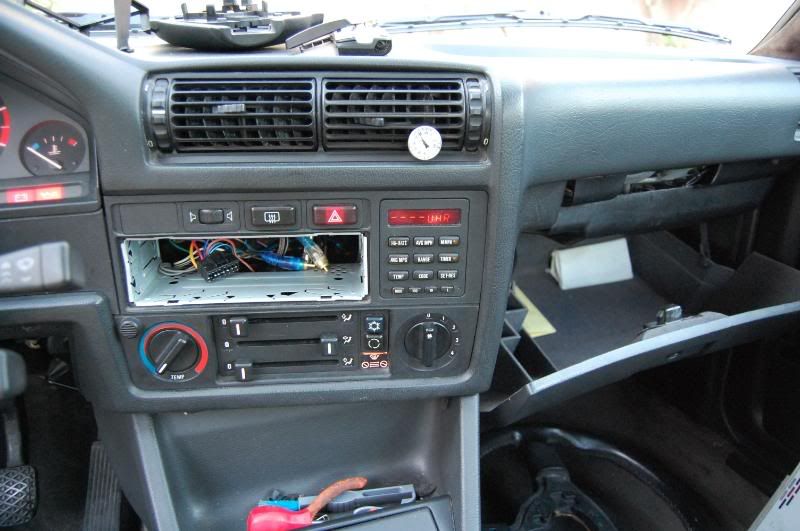

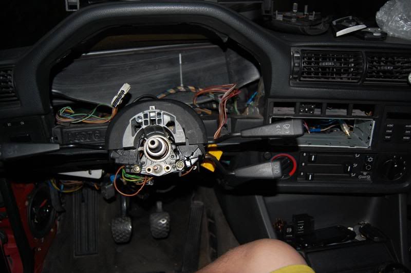

              Back to the OBC.
              Here is how I got to it in the AM
              Plugging it all in
              You see it works :)
              Now re install
              Cluster
              This all in
              Making sure it works
              Night pics

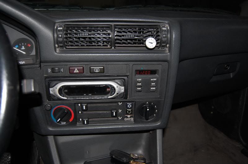

              Radio in. You know you like it ;)
              All done

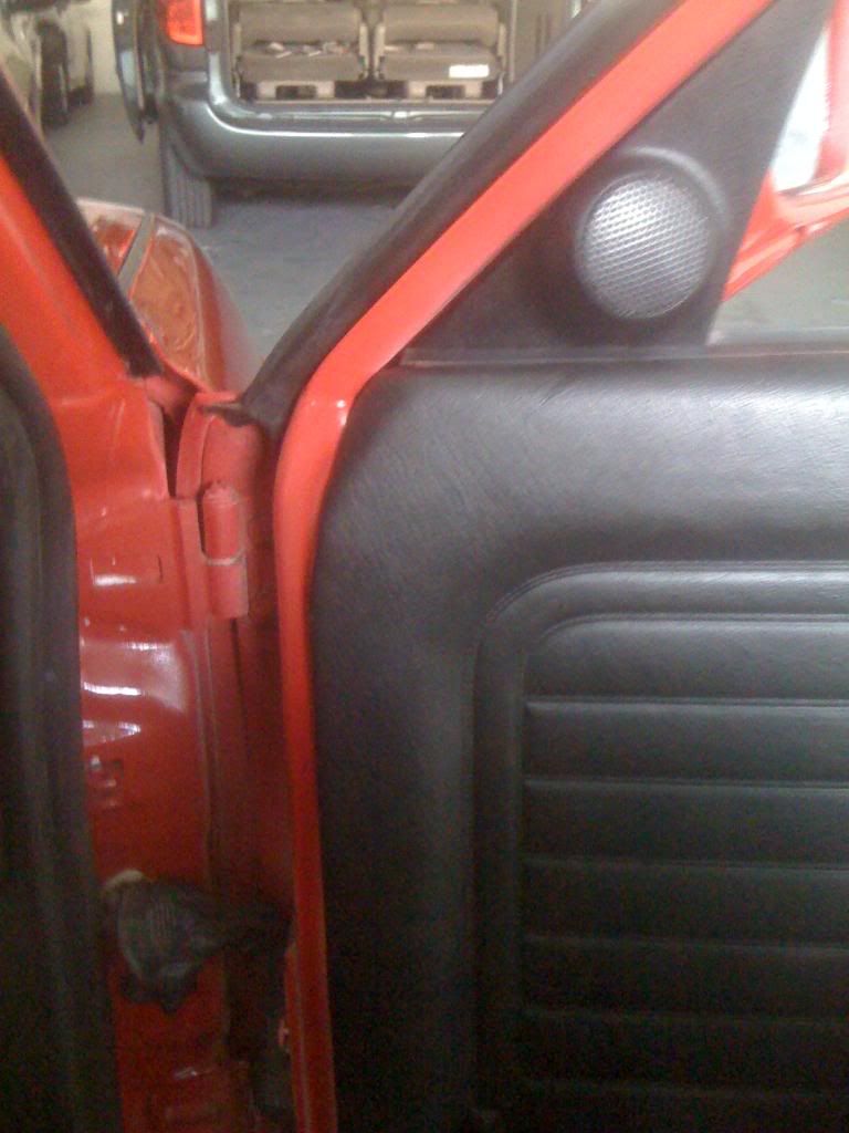

                Tweeters

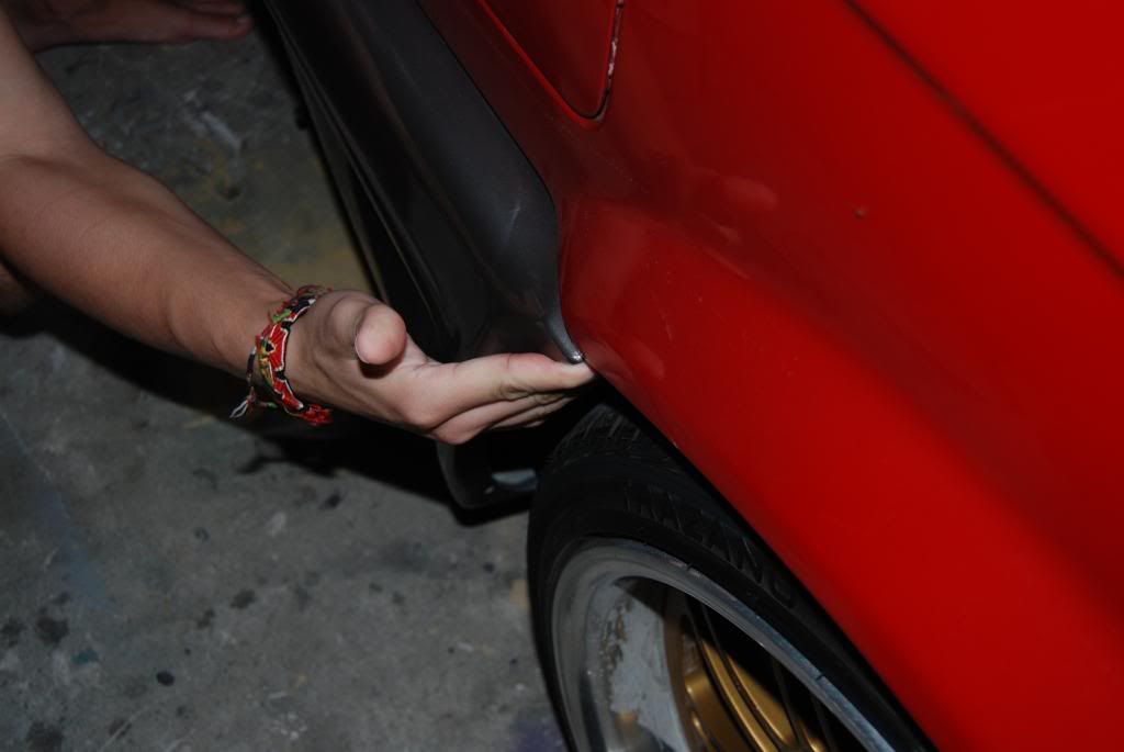

                Lowering the front

                Fixing the tail lights

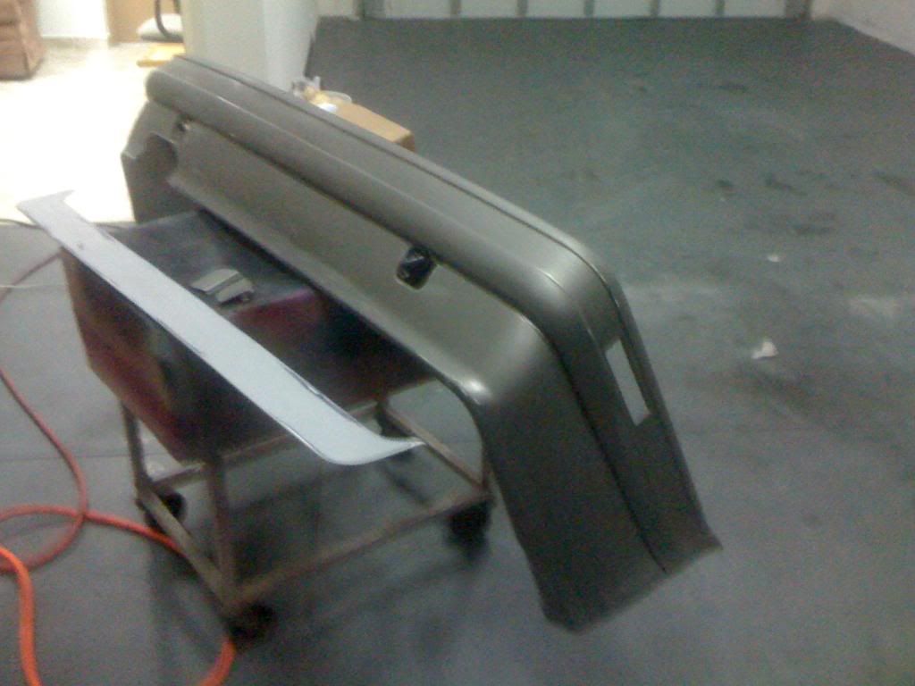

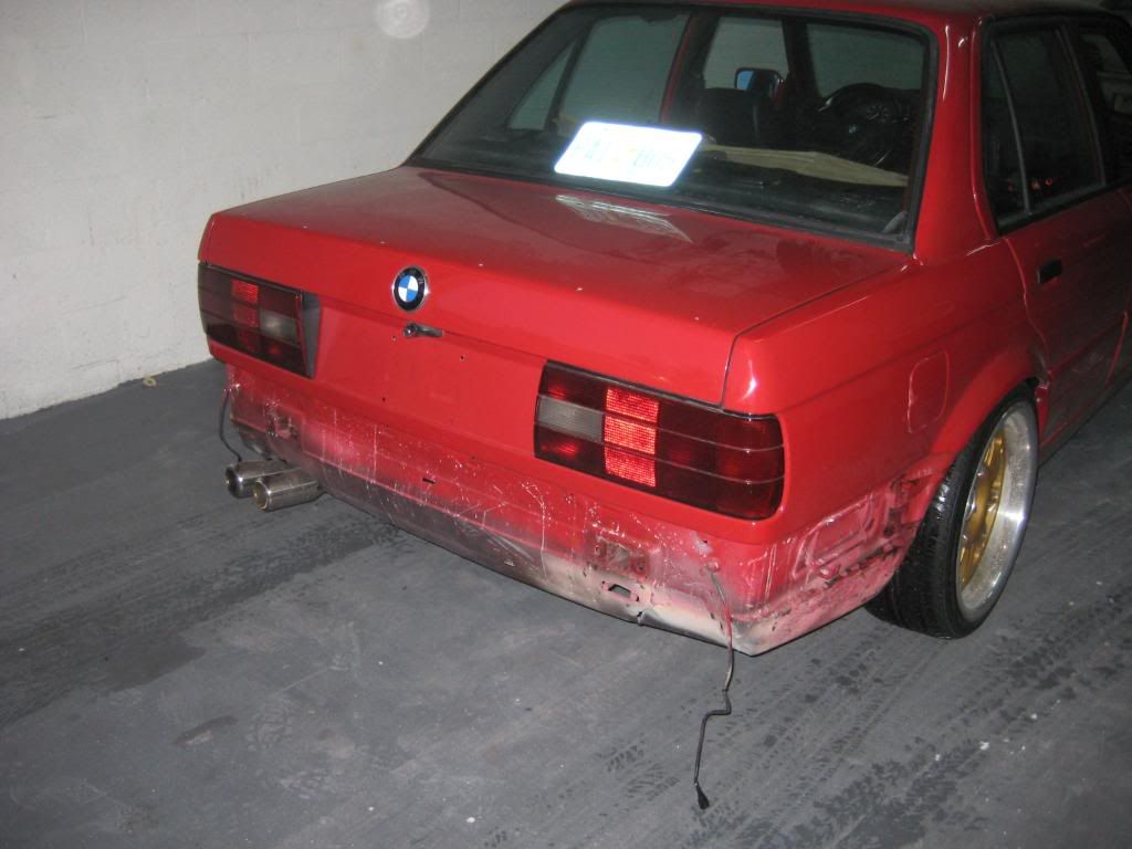

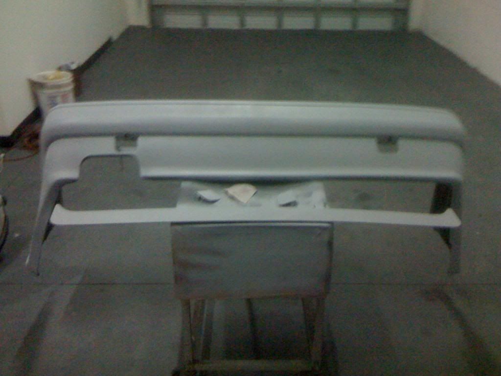

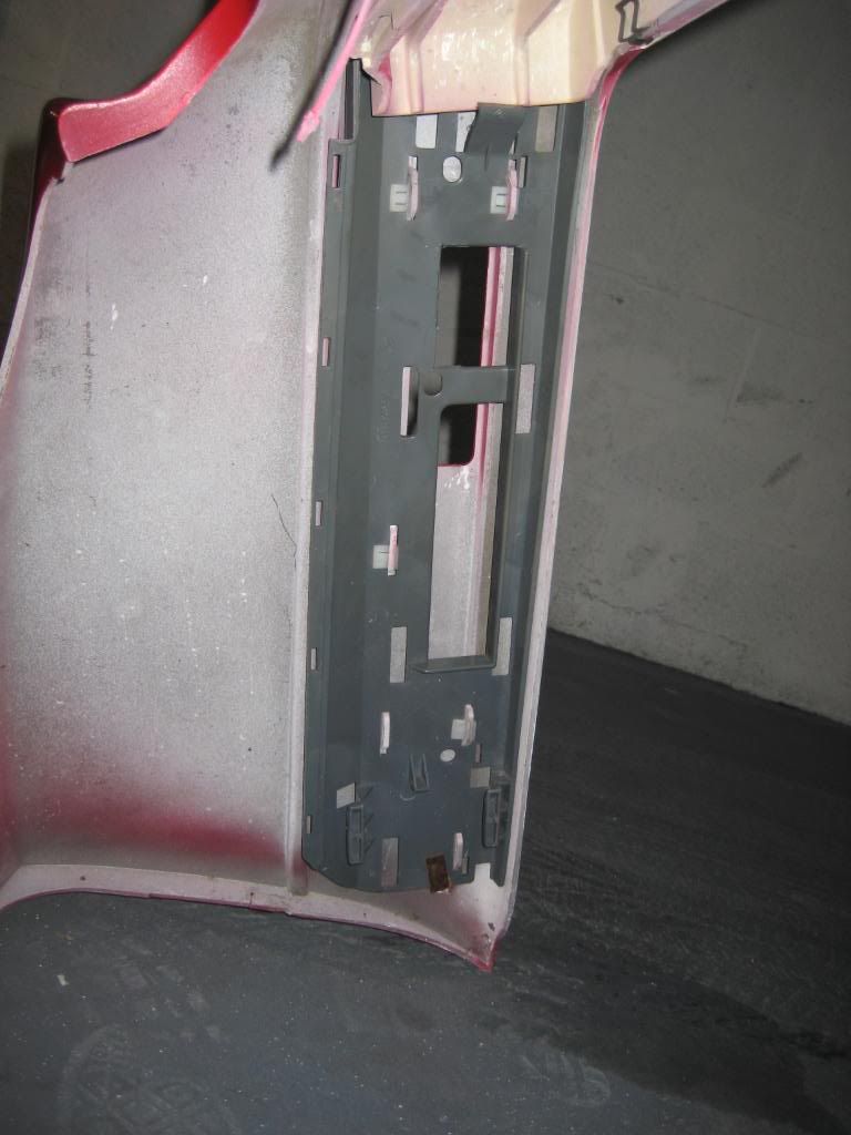

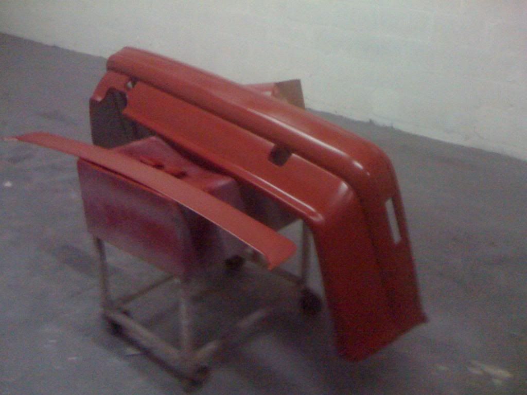

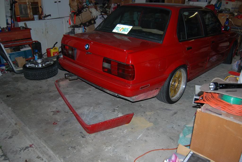

                Rear bumper coming off
                Test fitting

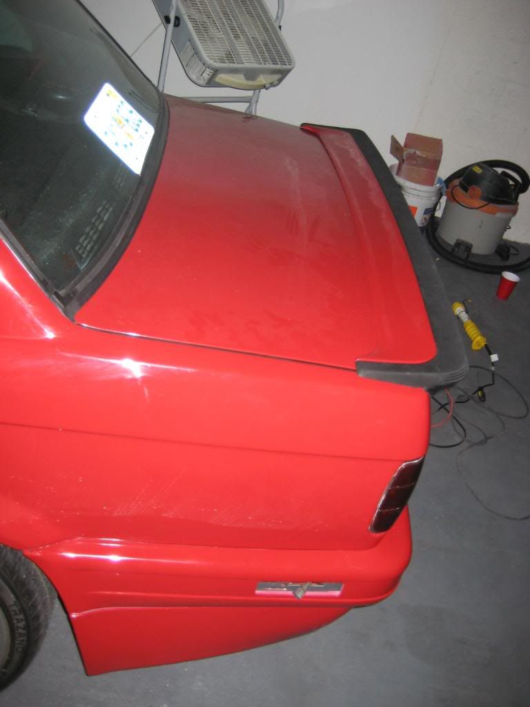

                Spoiler

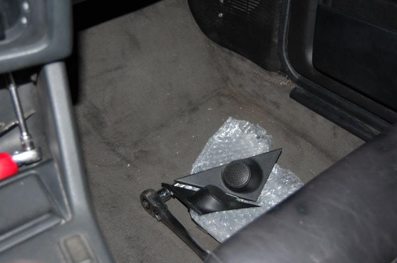

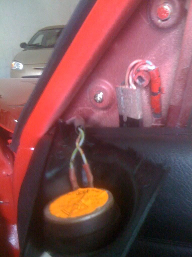

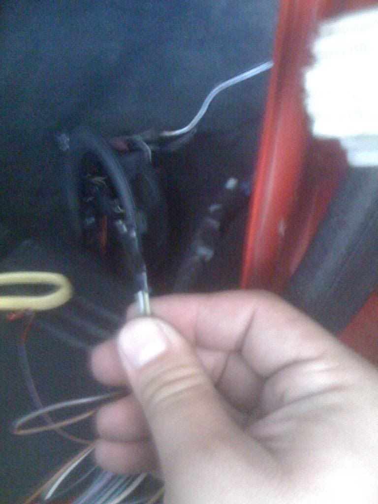

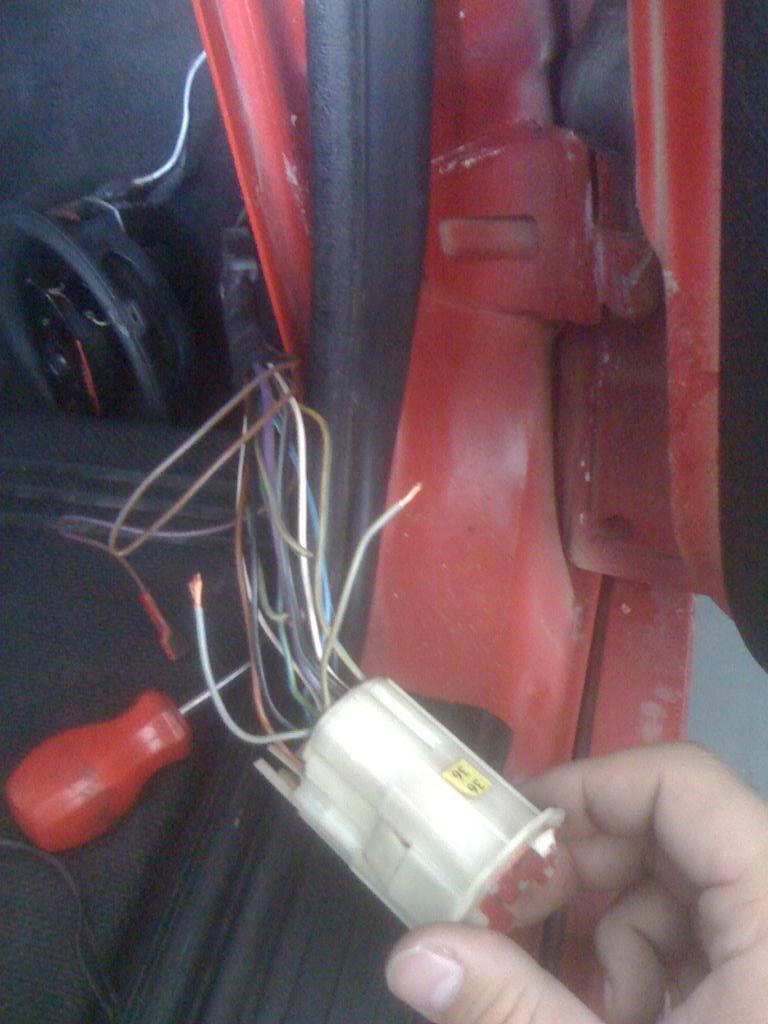

                Wiring the tweeters. I just tapped into the factory wire in the kickpanels and used the stock wires for the tweeters.

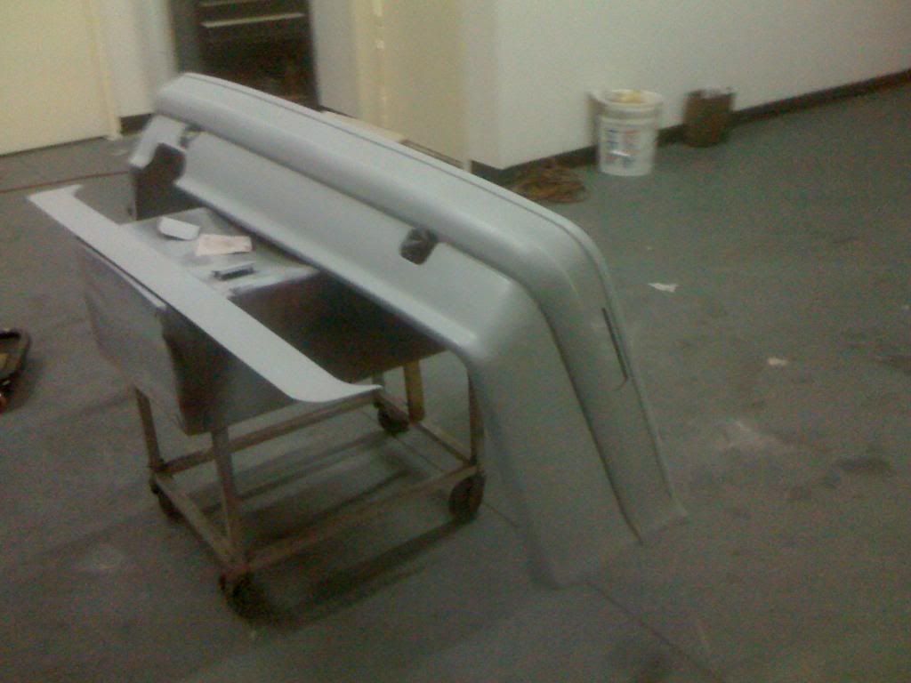

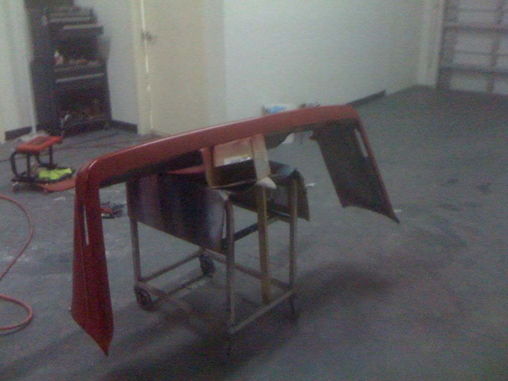

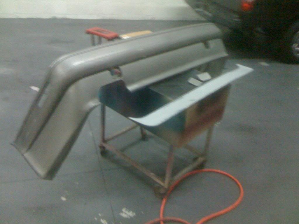

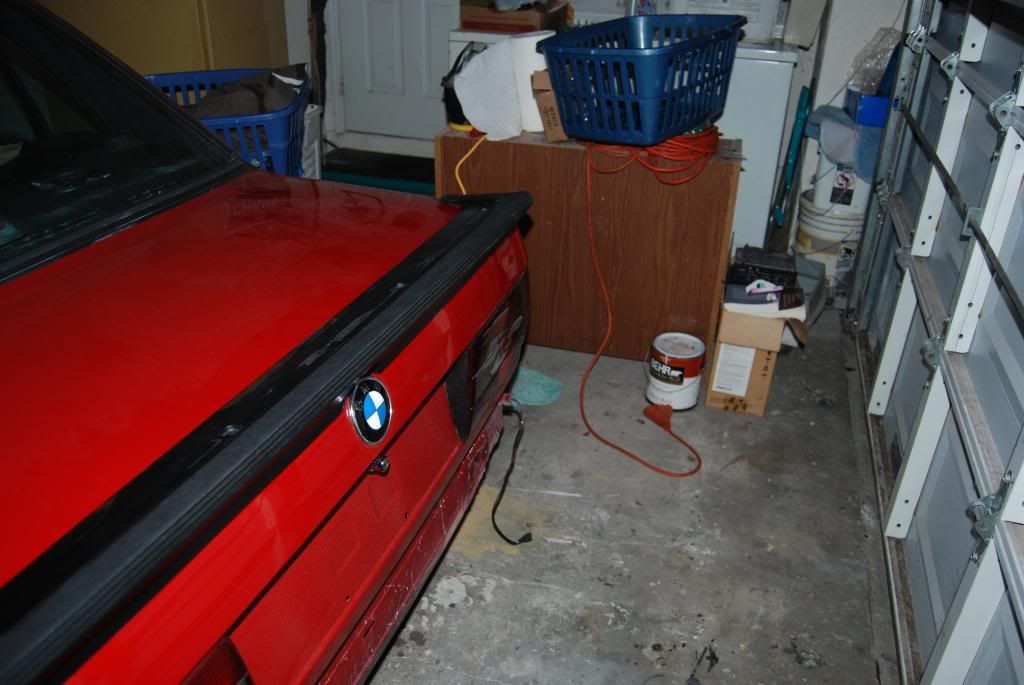

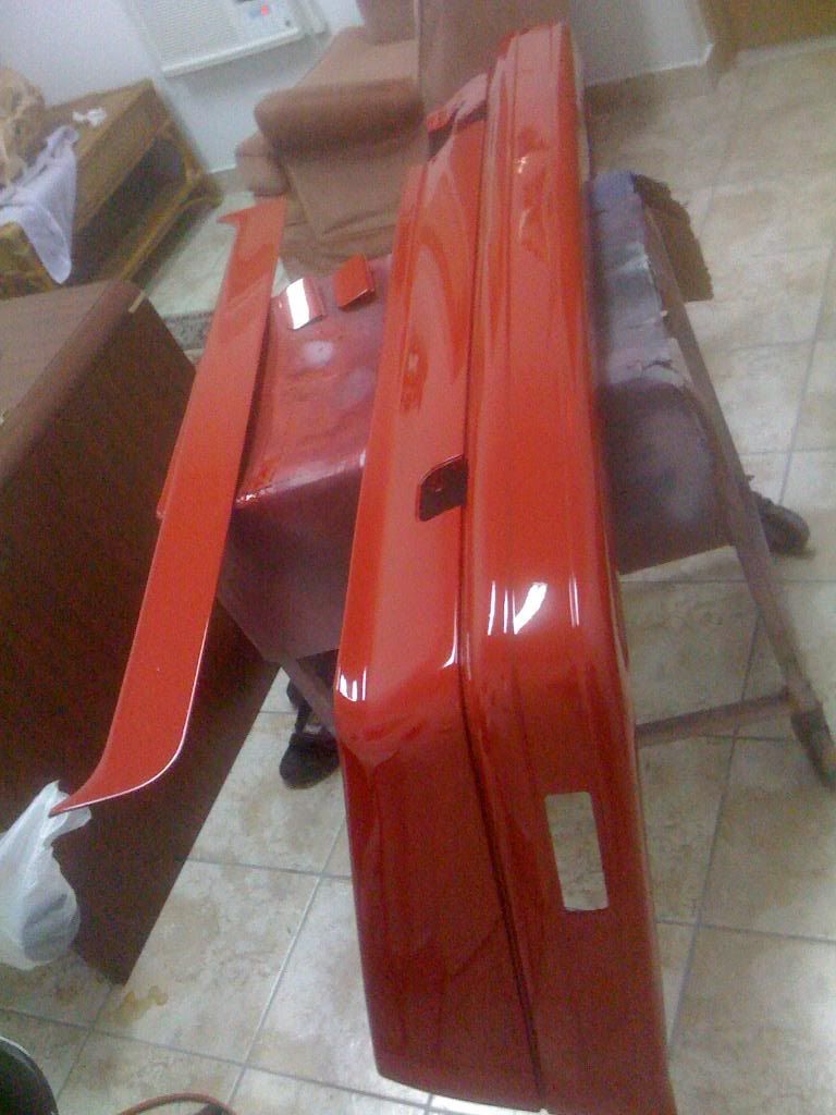

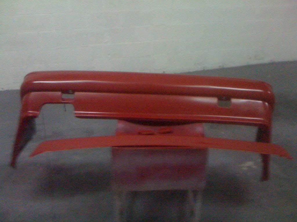

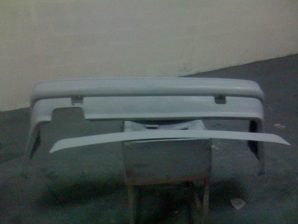

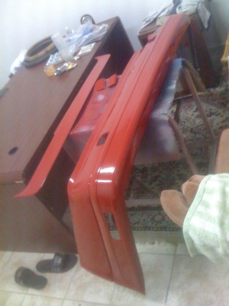

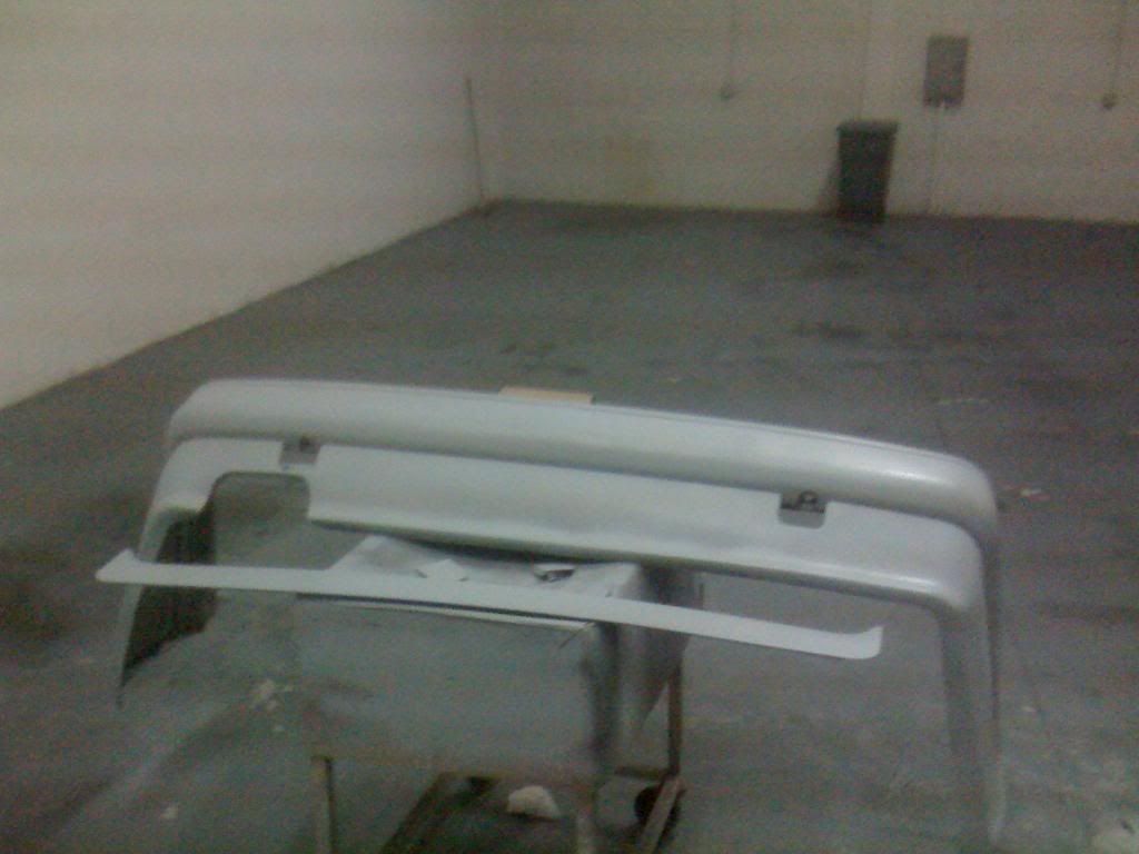

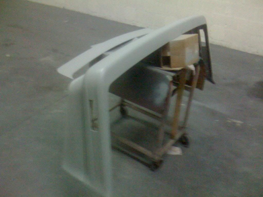

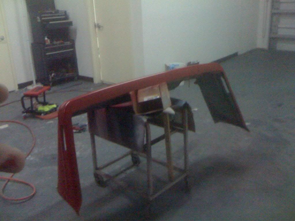

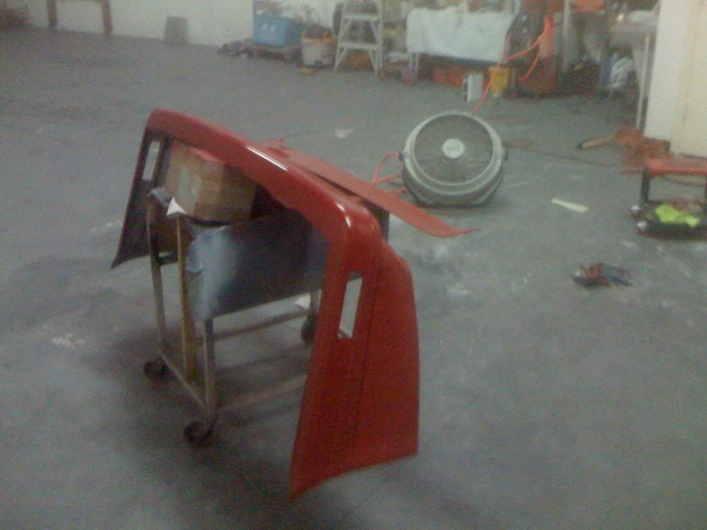

                Now painting the rear bumper and spoiler fitting. I was going to take a few days to to it, but being scared it would get contaminated and fisheye I took a while and did it all in one day. It came out real nice for not having a booth. I need to wetsand and buff to remove some stuff that landed on them from the air
                Thats it for today

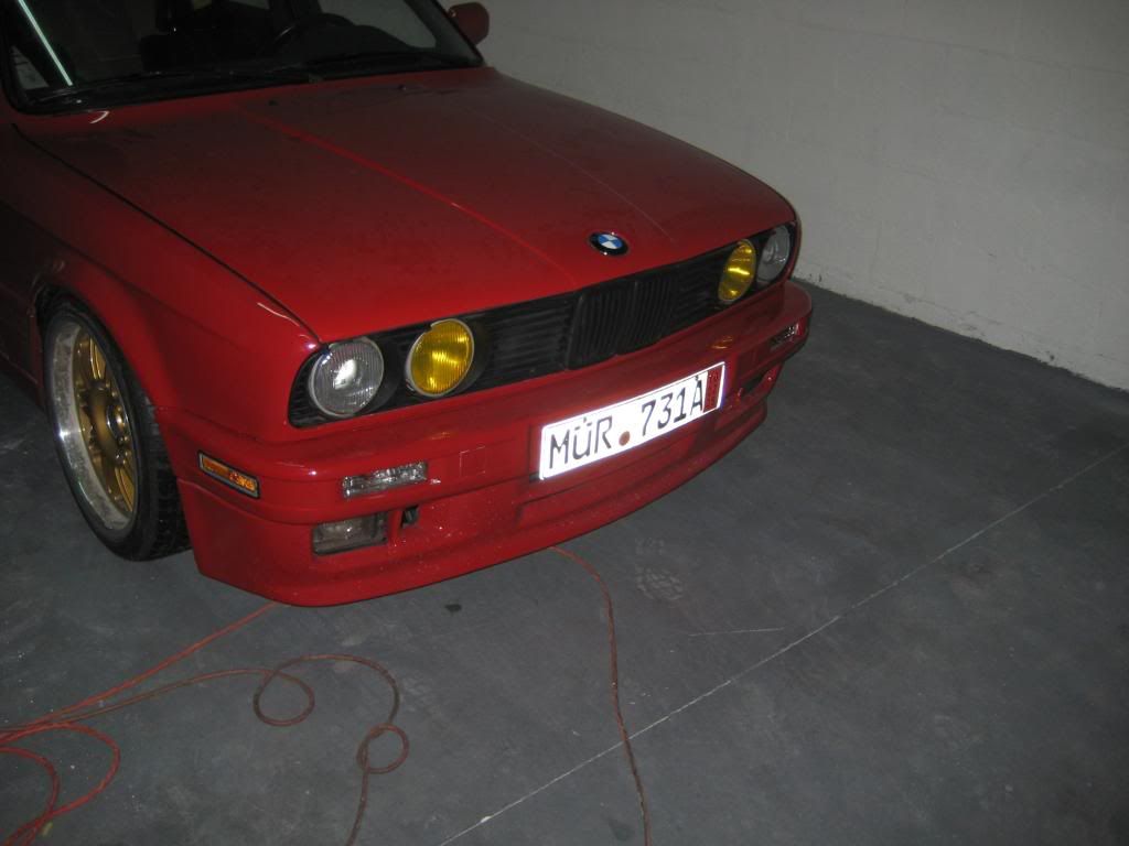

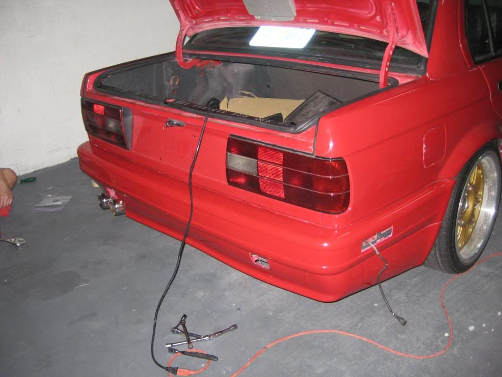

                            I got some work done today.
                            Here is how the car looked when I started

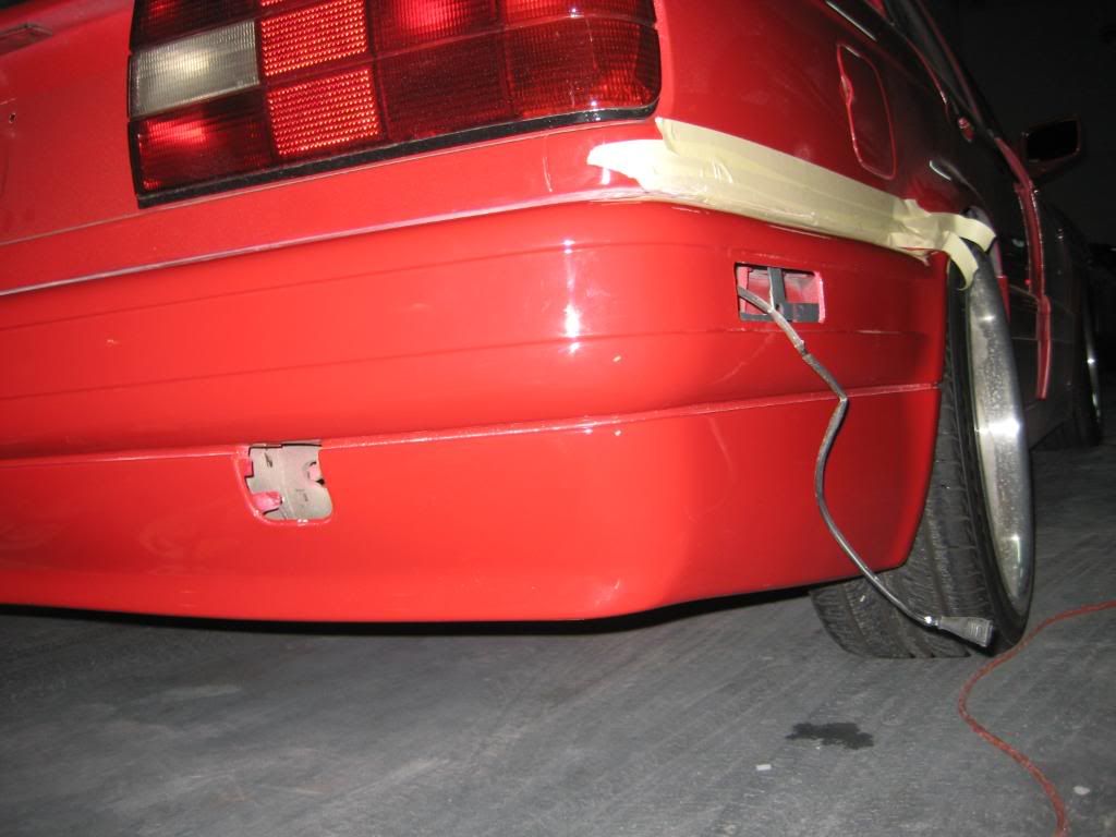

                            Putting bumper brackets on
                            Bumper mounted, still needs some fine tuning

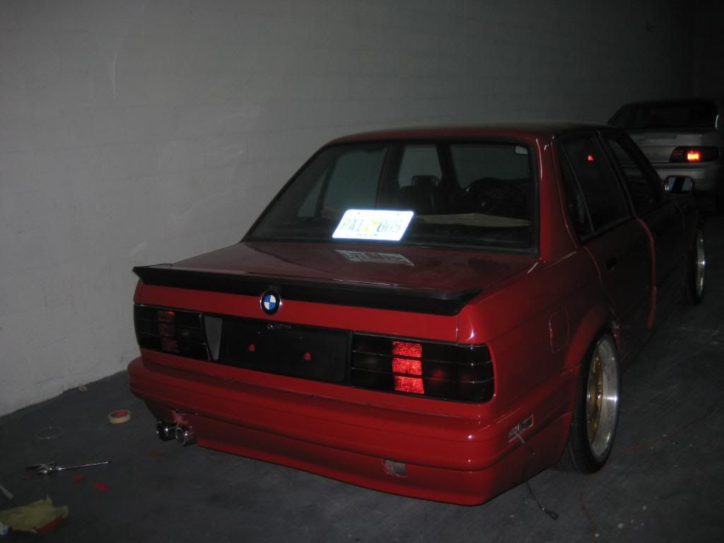

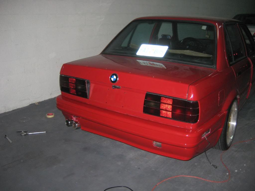

                            My tail lights
                            Tails installed
                            Spoiler installed
                            Euro tag tray installed
                            Thats it today, tomorow I should be doing the front corners and smoked headlights
