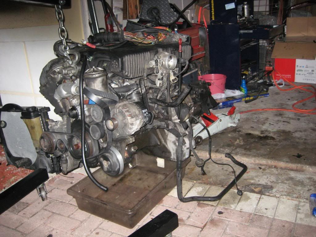

        Operation dismantle e36 is under way.
        I broke this as it was very weak. Does anyone know what this is? It seems to be a sensor of some kind? Maybe a temp sensor.
        All that is left is to take off the drive shaft, control arms, and steering rack, plus a few more misc things. Overall I think it was a pretty productive day.

              Im just waiting on parts to come in.
              Still to come in are tie rod ends, temp switch, SS components, spark plugs, and a few other things.
              Removing the rack
              Out
              I also finished modifing the kuckle but my batteries died. Ill have pics in the next update.

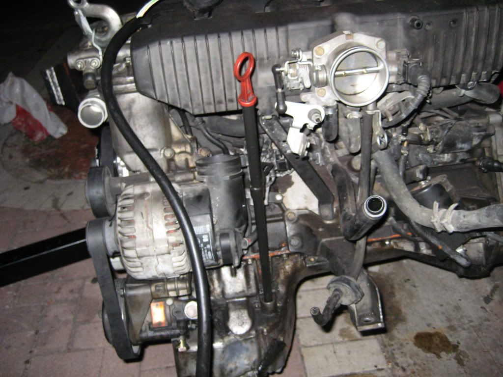

                      One of my biggest fears when starting this was losing track of tubes and wires.
                      Does anyone know where this one goes? (This one goes to the charcol cannister, right?)
                      Ends here
                      Starts here
                      And this one on the e36 (This one goes to the charcol cannister, Right?)
                      I almost got the pan off before it started to pour. This was the last pic I could take
                      Thanks.

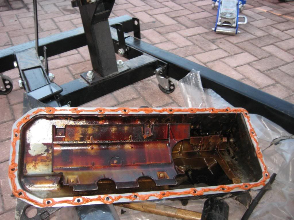

                        Now on to the e34 oil pan
                        With the pan off this was the best time to deal with the oil pump nut
                        Nut off
                        New nut Thread locked on, and the threading messed up
                        e34 oil pick up tube
                        Sanded the pan and block to clean it off
                        Copper gasket applied
                        Pan on
                        Belt on
                        Dip stick installed.
                        Thats it for today.

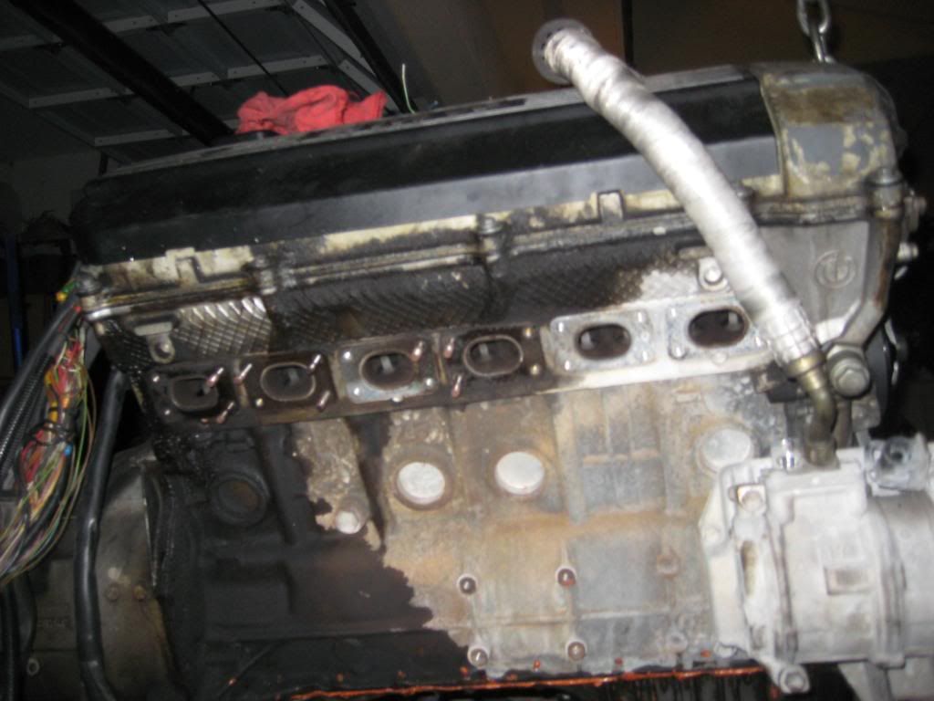

                          Today I got a little bit of work done. I got the CABs off but have no pics of that. I also got the headers installed.
                          Stock
                          Removed
                          Test fit
                          Mounted
                          I noticed that I would hit the heat sheild on the mount
                          That had to go
                          It was still close, so there were spots that I had to smooth out
                          Done
                          Thats all today

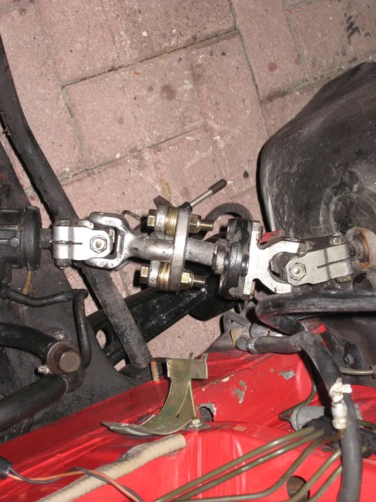

                              Now on to the e36 steering rack
                              Tie rods on.
                              Installed
                              Removing the driveshaft
                              Taking off the cover
                              CSB
                              CSB unbolted
                              Taken out

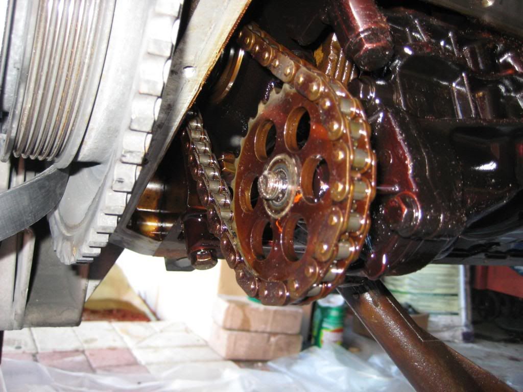

                              I missed a gasket on the oil pickup tube before so I had to remove the pan again
                              Off
                              Cleaning the old gasket
                              Gasket on the pickup
                              Pickup mounted
                              Cleaning the block
                              New gasket on
                              All done
                              As soon as the Valve cover is welded up, the motor is ready to drop in.
