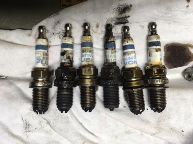

    S50 Turkey Day Toughness
    Ever since I bought this car almost two years ago, the S50 had loud tapping I contributed to a lifter. Lately, it had a weird hesitation following 5" of rain, so I opened my Castro air box, and cleaned the intake and throttle body with cleaner the day after Turkey day. Of course after soaking the intake and putting it back together, it wouldn't idle for shiite. So I pulled out the coil packs, found three spark plugs finger tight, one was a half-turn loose. Pulled the plugs out and found out they were not only shitty cross-fire types, but number four had no ground electrodes left. I can't believe this engine ran at all.
    I put some Autolite single element plugs in it. Runs tit now.
