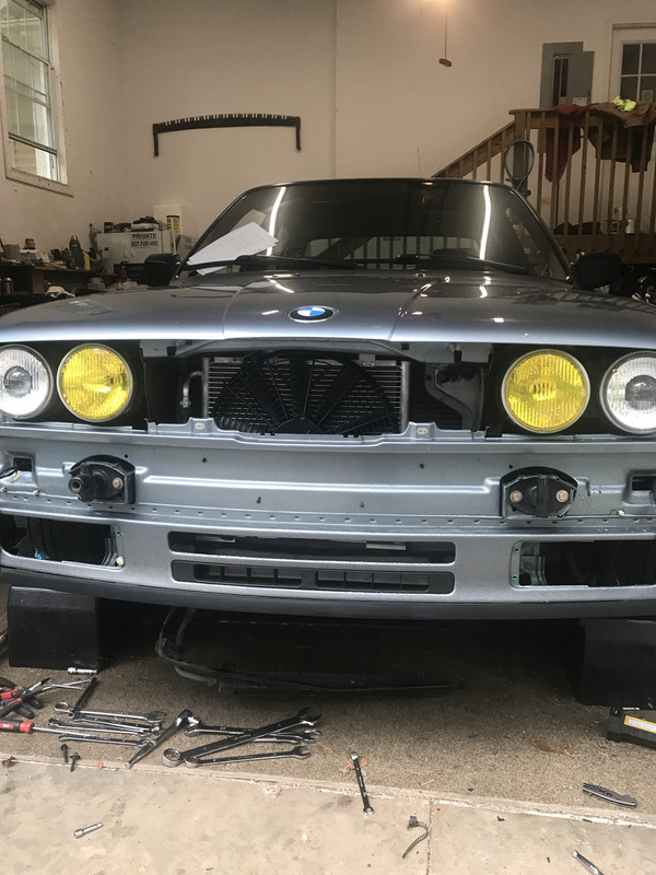

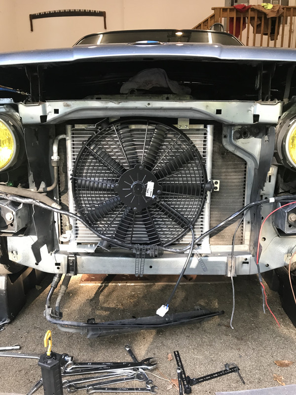

    Got my spal fan and new condenser in, everything back together now. Took me 3 days.....

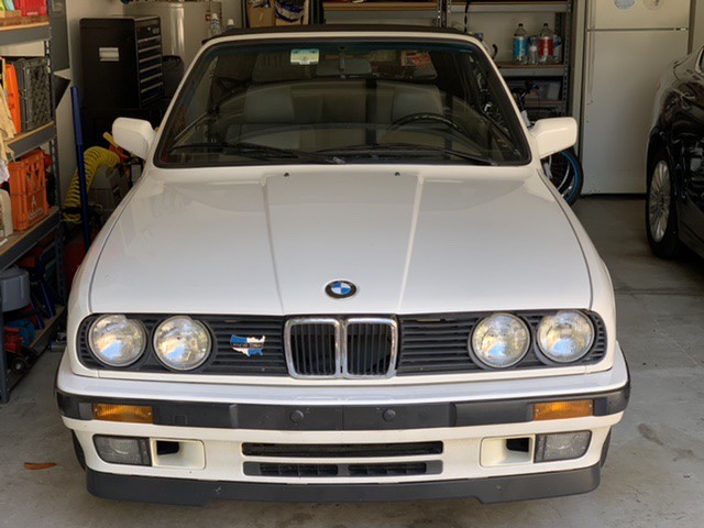

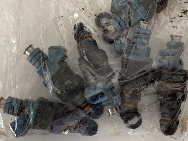

              Installed rebuilt injectors from CA Tuned on my 92 cabrio today! I got a lot of help from two friends which made the job a lot faster and easier. Learnings:
              1. No need to remove valve cover or intake manifold but the intake manifold brace must come off
              2. Car sat for a week, hardly any fuel spilled. Still, it was good to have a fire extinguisher ready.
              3. Electrical connectors popped off easily, no need to remove the electrical conduit, just push it out of the way
              4. Steel retainer clips came off with a hook tool. Keep a magnetic probe handy to catch them.
              5. Clean out the holes with carb cleaner and compressed air. Mine were filthy with grit and oil.
              6. New injectors don’t have to go in tightly, they feel wobbly even when fully inserted
              7. Use a magnetic probe to hold, align, and push on the steel retaining clips
              8. Don't forget to reinstall the intake manifold brace or you’ll have a vacuum leak. Ask me how I know...
              9. My car ran like crap and had a miss after we were done, but a short drive with heavy acceleration cleared it all up. Don’t be afraid to drive it if it runs roughly at first.
              10. I would rate this job as tricky but not difficult. Tools required included 8mm and 10mm sockets, hook tool, large screwdriver for prying off the electrical and fuel bars. Carb cleaner and compressed air were also needed.
              Many thanks to my friends Johnny and Sean for their help!

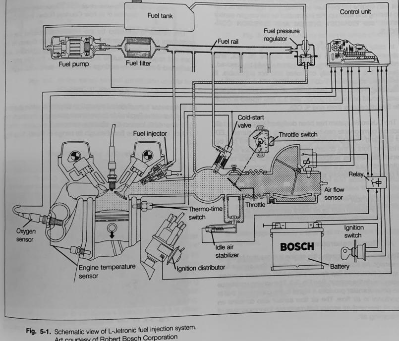

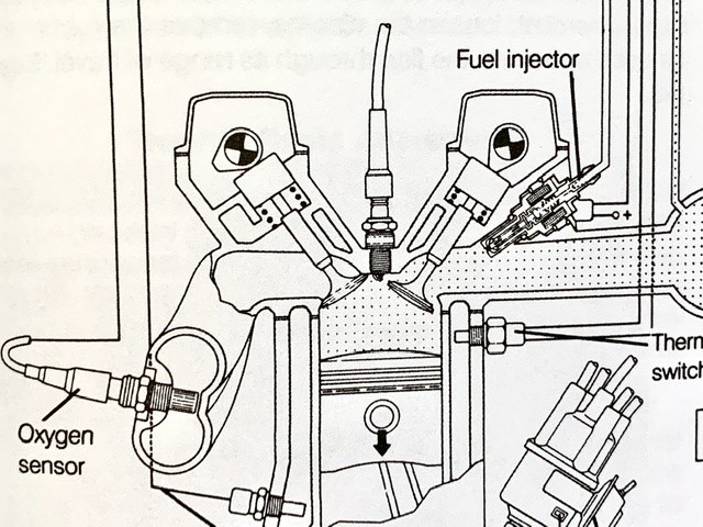

                What in the world is that first pic supposed to actually illustrate?
                • jgilber0
                  jgilber0 commented
                  Editing a comment
                  It’s from the cross-section illustration in the Bentley manual that shows how the fuel injection system works. Somewhat of a schematic. It’s on page 20 in the fuel section.

                Yer i dunno either. With that distributor location what engine is? my m20b23 is like that but you guys dont have m20b23. unless its an early m20b27 maybe they had the dizzies down there too? but then he said its a 1992...which would be late model.....

                  Here’s the whole Bentley diagram:. Sorry to confuse everyone, I was just trying to illustrate a fuel injector.
