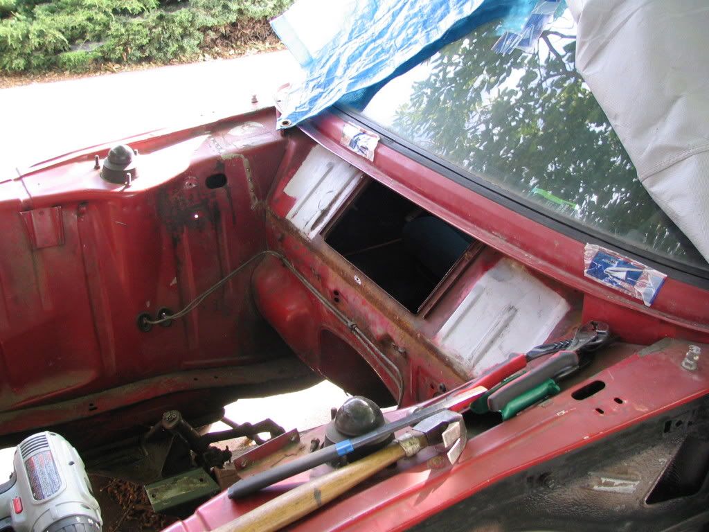

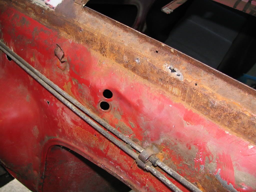

            Here's another micro update. So I was pulling out my clean air box for my heater box since it was wavy, and a piece of shit anyway. Completely useless to me as well since Im not putting my heater box back in. Huge leakage point for water and whatever else. I may just put some fans ducting to the defroster ducts under the windshield that I can turn on and off if I care enough to do so.
            Heres a couple pictures. I knew what I'd find, rust at the seam where I removed the box along the fire wall, it's mostly sufrace rust. Any holes worked from the inside out for the most part from the heater box leakage down the inside of the firewall and trapped under tar that BMW ingeniously put below the box and above the tranny tunnel. A perfect spot to sandwich water seepage.
            I already planned to cut from the transmission tunnel up to the heater box opening, but this really cemented it. I think it will be one piece from the top of the tunnel to the top of the opening under the windshield if I can get by with it. A friend of mine has a bead roller that I can roll some ridges into it to make it not so prone to oil canning, and make it a little more stock looking since on each side of the heater box there is a ridge.
            Tomorrow or in the next couple of days my plan is to just clean the shit out of the paint in the engine dept, there's road crud EVERYWHERE and I'd like to see what it looks like clean. Besides that, its nicer working around clean stuff anyway. Everything will be painted when all of the bodywork is done too.
            Crusty. New metal goes in :D

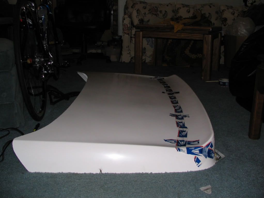

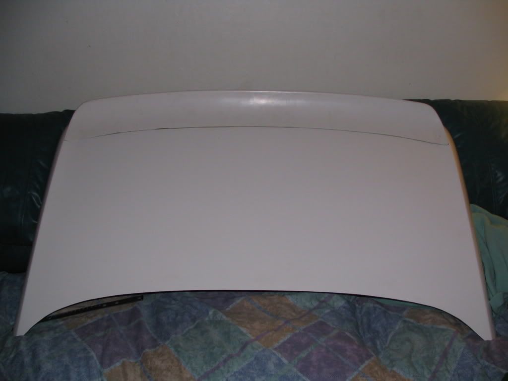

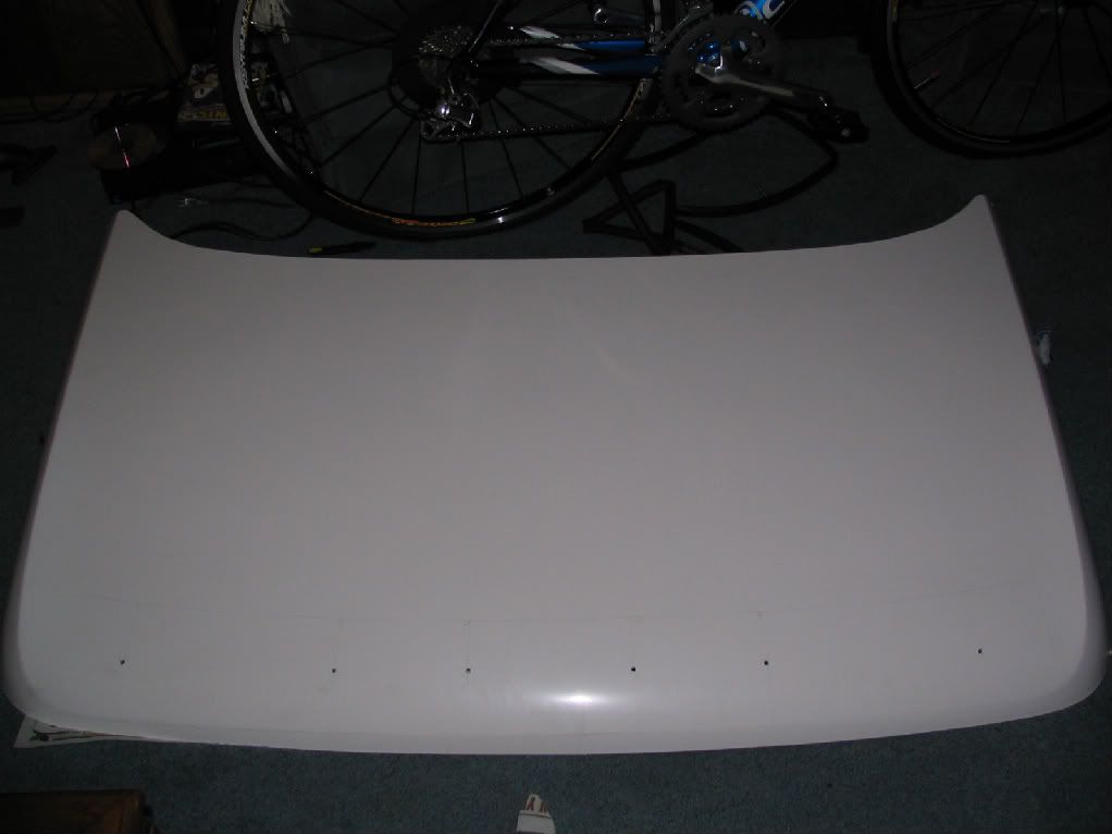

                                I nearly forgot I do have some pics from one of the several sub-projects I'm working on with this. It has to do with my fiberglass trunk lid and turbo spoiler.
                                And the real bitch work of it. It's about 95% done, a little more smoothing and filling in little pock mark holes in it-
                                Probably more than I needed to get the point across, but pictures are fun. Thought ya might like that lil bit of work. I haven't been doing nothing...
