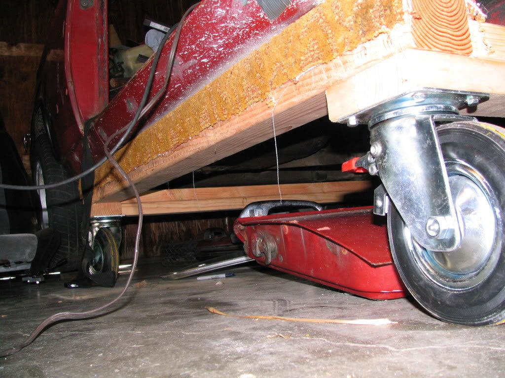

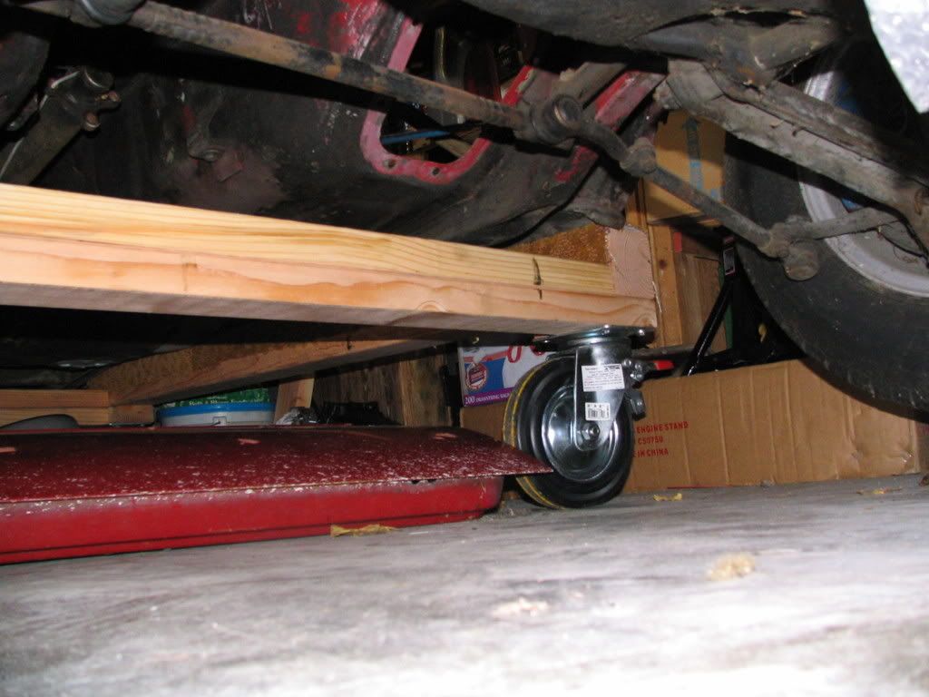

            Pictures of my unintentionally perfect dolly -

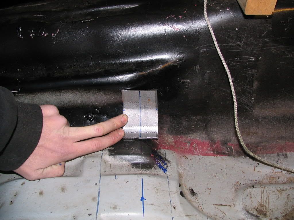

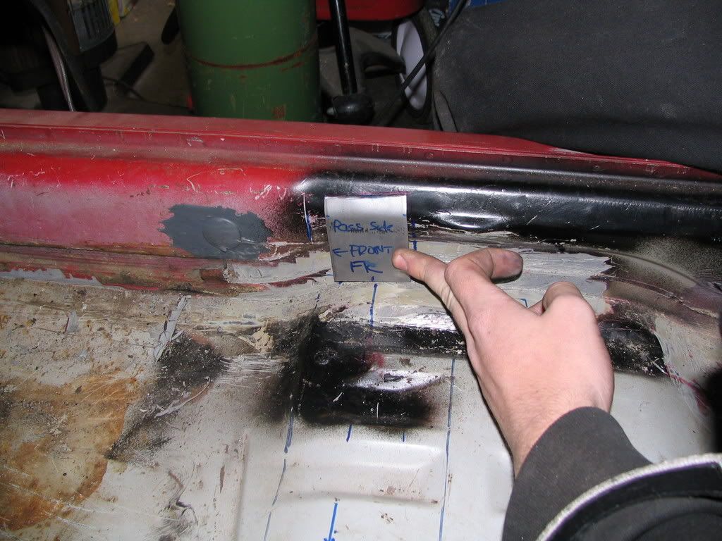

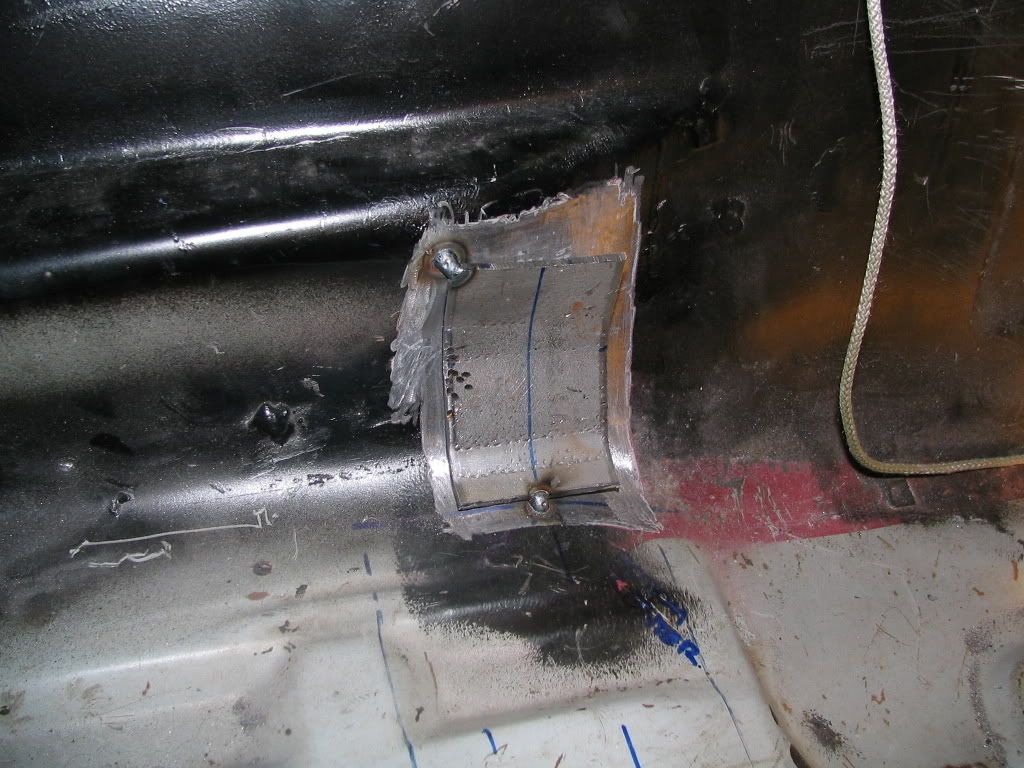

            Roughed out landing plates. I have a similar set for the driver side. The inboard ones shy away from the transmission tunnel a little so I'll either box them with some extra metal, or heat them up and bend them flush with the tunnel. The latter only requires a little more work to cut/grind the bars that will go between them in order to meet the bent metals' contour. Not sure which way I'll go with that yet.

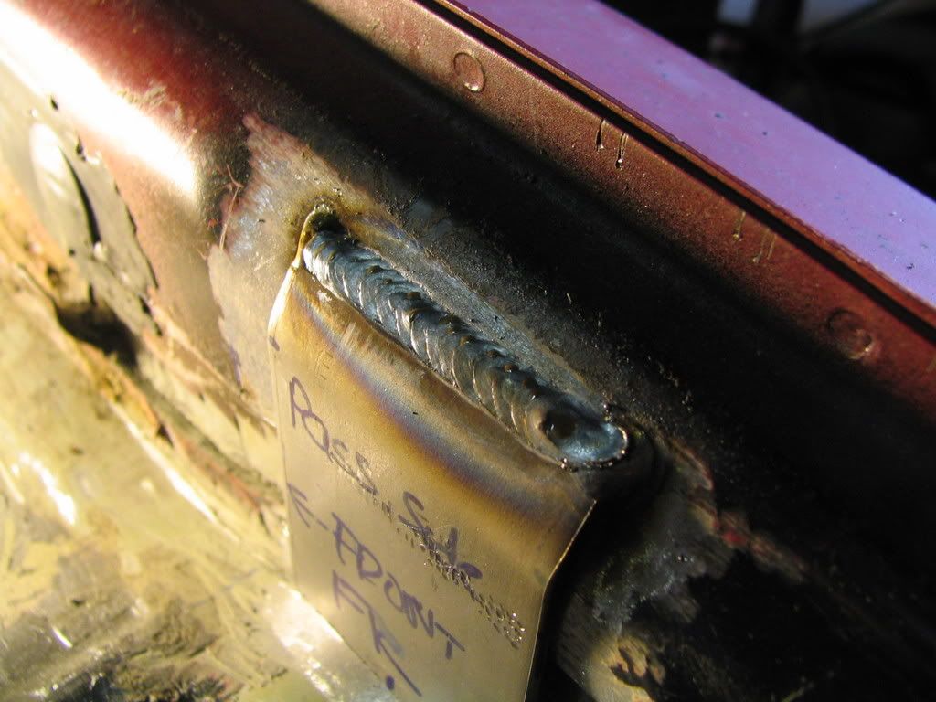

            First weld, and my camera battery started complaining -

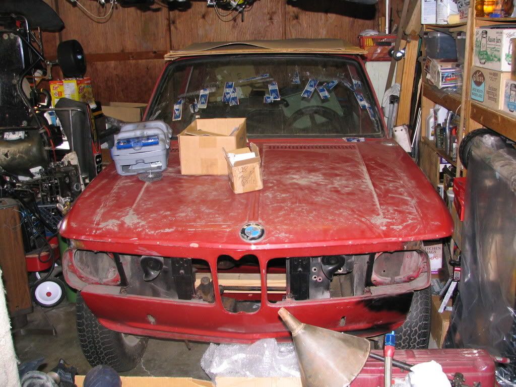

            How the car sits in the garage currently. It's a tight fit but there's just enough room to work on it. When I replace the nose, I have plenty of room to push it out of the garage door (5' or so) before the dolly wheels fall onto the driveway. The front two wheels have brakes on them anyway though.

              hella nice welds... like a row of coins flopped over.

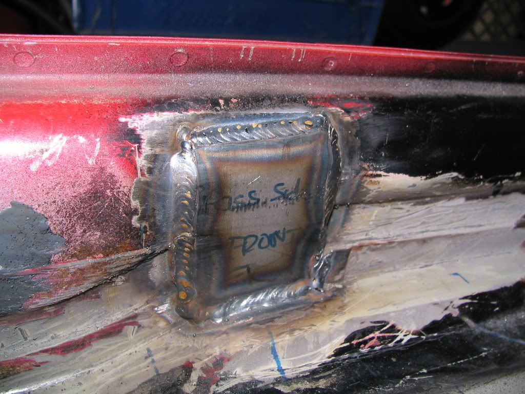

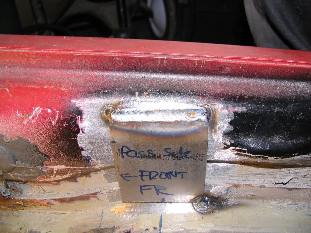

                'Nother quick update. The first plate is fully welded on, inboard side, halfway welded on. I'll do the same to the driver side and maybe the rear plates before I decide whether or not I'll box or bend the inside plates. Bending seems a lot easier, but the cross bars would probably be a little trickier...
                Anyway-
                Welds would have been titties all the way around except I pushed my luck a little bit and the seam sealer packed down between two metals decided to catch fire and contaminated the shielding gas a little on the back side. It's still solid as hell, though.
                Tacked on inboard side. It's welded along the backside now, and the rear half of the bottom edge. I'm leaving it that way for now to decide what to do later...

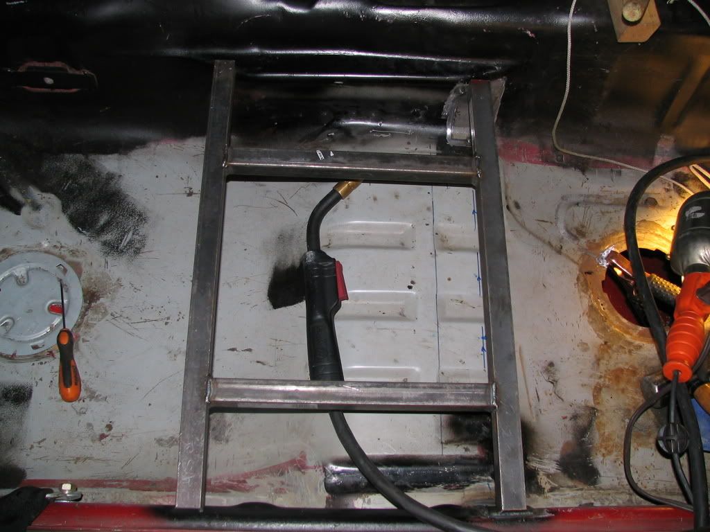

                Here's an idea of what's going between them. There will be rear plates as well, but I wanted the front ones in first as they sort of dictate the minimum height possible (due to the bump in the floor right below). It's made from 1x1 L stock going side to side held together with two lengths of 1x1 square tubing.
