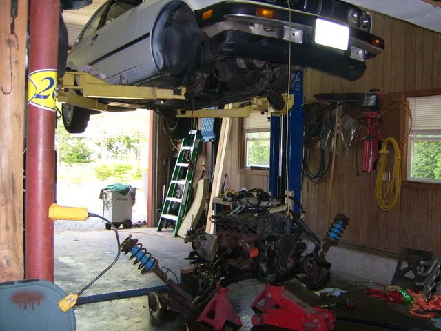

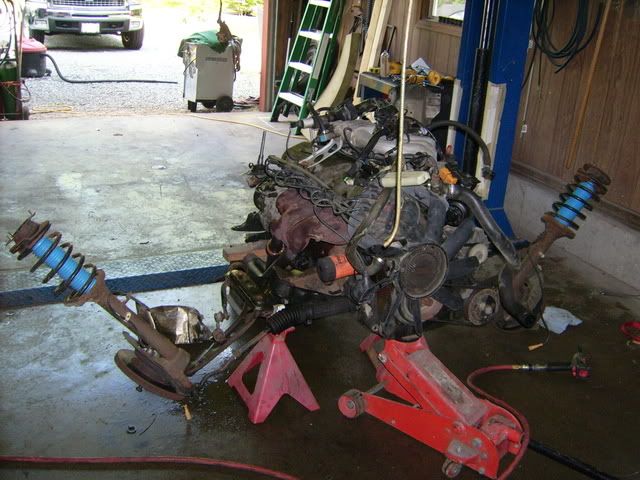

                Finally got that fucking crank nut off today. My friend mike came over with his torches and after a long debate, we decided that the nut is normal threaded after all. It is really hard to tell looking at it for some reason, it almost looked like ribs instead of threads. We had to heat it up for a good 5 minutes and wail on it with the impact to get it off. I have no idea why BMW thought it needed to be that tight.
                I can't do anymore work on the engine though because my friend has all my tools in CT, so I'll probably start prepping the engine bay for paint this week.

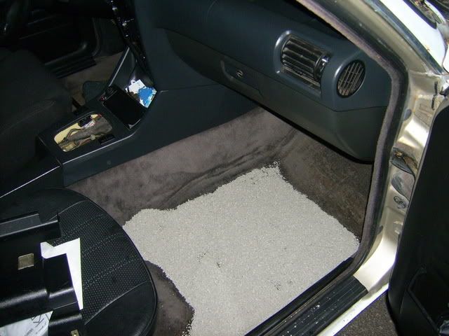

                      Did the custom passenger side beach mod today.
                      Byron

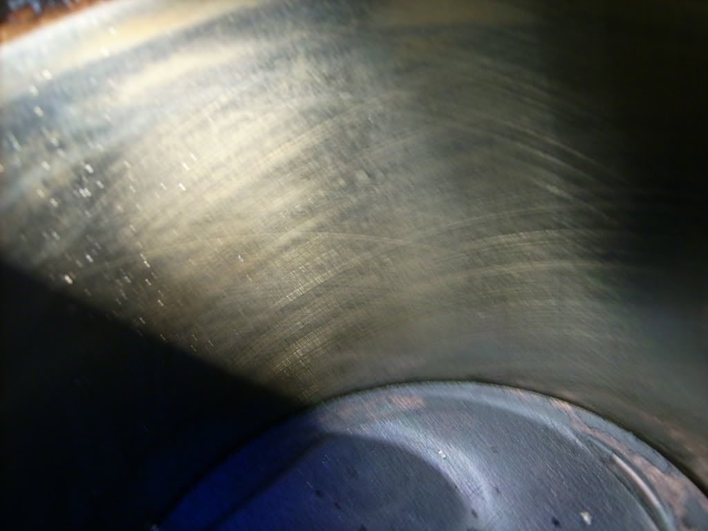

                            230k and still has cross hatching. I love m30's.

                                Pulled the oil pan the other day- no spare parts down there so I'm happy. The crankshaft has no play in it at all too. I've just been cleaning and prepping stuff for paint, I might have the engine together next weekend if the weather holds.
                                I'll post updates if anything exciting happens.
