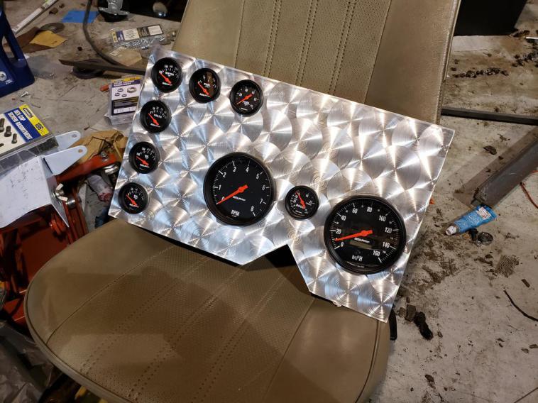

    gauges are coming along nicely! I think ill put my indicator lights on the top area above the boost gauge.
