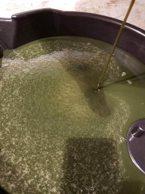

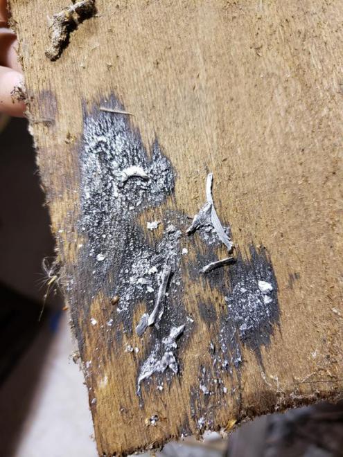

    Shavings in the first oil change aren't unusual, and the green tinge is either an assembly lube/shipping preservative or a break in product as you suggest.
    Originally posted by moatilliatta
    I know brad penn break-in oil is green. Id say all is good, maybe would have changed oil right after break in... Try out rotella T6.
    I also use alumibrite on aluminum that needs welding. New casting probably has less oil in them... but most seem to be more porous..
    so what do you think I should do about the motor oil? I haven't had the chance to be able to put load on the motor yet of course and what I have done with the motor is start it up let it idle for a few mins and then rev it (as seen in my goofy video). ive done that a few times and then ive also let it idle about 20-30 mins with an occasional rev just to make sure the cooling system was working good ect…
    Im thinking I should run a fresh conventional dino oil maybe with a break in additive for atleast like an hour of driving so I can get some load on it and good varying rpms and then maybe switch to a full synthetic after that probably the t6

    really I wouldn't mind modifying the oil pickup and pan so much if it weren't for me dreading the sheer about of work and solvent its gonna take to get those parts clean. aluminum especially has to be devoid of contaminants particularly oil and grease or you run into serious issues welding it. plus the oil pickup looks like its in a fantastic spot in that deep section of the sump so as to be resistant to oil starvation I just don't feel like it right now over 1-2" of extra clearance as nice as that would be.
    one thing that really caught my eye and almost surprised me is the significant amount of fine metallic particles saturated in the oil. I even found some large aluminum shavings but I think perhaps allot of those are flashing from the oil pan ect…
    the oil looks weird as hell its kinda green.... I was going to reuse it as it may be a special break in oil and the motor has less than 3 hours on it but now I intend to replace the oil and oil filter. I was thinking rottela t4 conventional 10w-30 for the next little bit and then switch to rottela t6 5w-45 full synthetic when the motors broken in pretty good

    I just hope the motors not damaged as the oil and shavings are kinda concerning to me but ive looked up into the motor and cant see any holes in the pistons lol and the cylinder walls look nice and bright

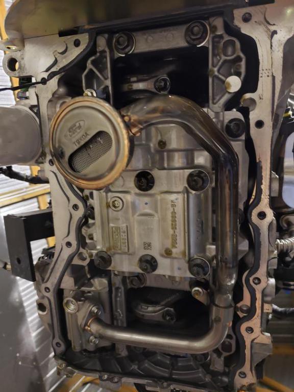

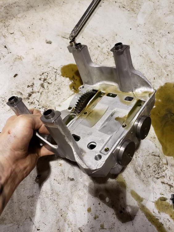

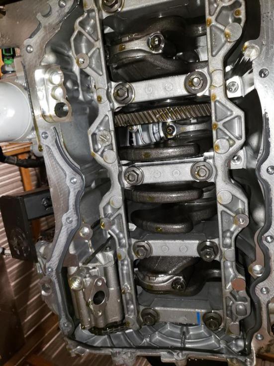

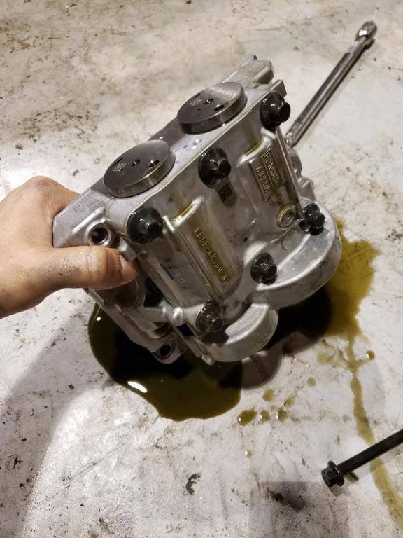

    Everything went fine aside from I accidentally smashed a couple wires coming out of a connector when pulling the motor but Im sure they are fine. also smashed a vacuum cap that ill replace because while I still think its still sealed it got cut a bit. both no big deal, I just neglected to update the thread.
    motor and especially the tranny are tucked into the car so tight.
    also didn't realize i shouldve drained the tranny because all its oil leaked out of the tailshaft when I pulled the powertrain so i dont know if i would say everything went entirely smoothly LOL. it actually took me a bit of messing about to figure out the best way to pull the motor.
    the oil pickup resides at the bottom of the deepest section of the oil pan and while it is made out of steel and can be modified I think im going to skip the project of shortening the oil pan just to avoid the work. juice aint worth the squeeze to me right now I guess you could say and I was only going to shorten the oil pan by an inch or two anyways. its something that would be on the list as a future improvement though.
    the problem right now though is that im afraid that I may be waiting on my balance shaft delete from mountune for a while as I ordered it early last week and nothings happened, tried calling mountune and couldn't get a hold of them but ill keep trying so that I can hopefully ensure that I will get my order soon as ive been waiting for while and I don't want the lack of that part to hold me up. because of waiting on my order ive started to work on harness mounts which is not exactly easy to pull off really strong mounting points but ive developed a plan.
    the transmission pulled fine and when I get the damn balance shaft delete I can get everything put back together and test it outside the car to make sure the clutch is functioning before I put the motor back in.
