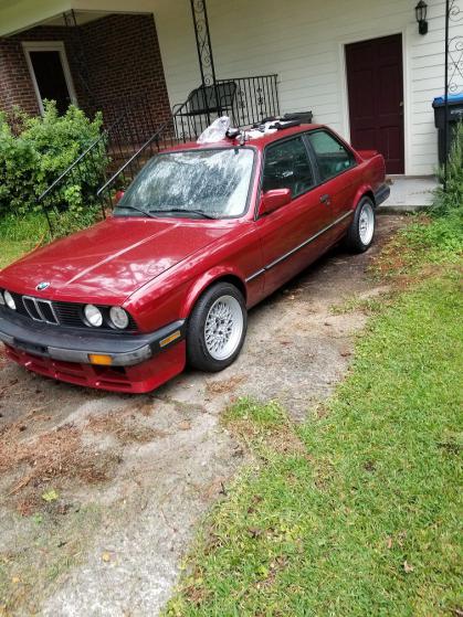

    390,000 Mile Weekend Track Warrior
    So, I've decided I want to go to the track, and what better car for it than a 390k mile 1987 325is. A little background. I bought the car in 2017 about 3 months after I graduated college to get started on my first solo project. The original plan was to have it for a reliable daily/something fun to drive. Fast forward to now; so far, I have just done basic maintenance on the car (New PS belt, Alt belt, oil change), no major upgrades. I've been wanting to drive on track since I was a child and decided what better time to get into the sport than now, so here we go. Any tips anyone has along the way would be appreciated. I am not new to working on cars, but I am new to making them work on a racetrack.
    Here it is the day I brought it home
    The Goal: Turn this 390,000-mile car into one that is fit for HPDE events and still easy for the street. This will mainly involve refreshing a lot of the bits on the car since the mileage on them is unknown. I will Start off by getting the car to a point to where I think it will handle the abuse on track, then I will upgrade seats, cage etc.

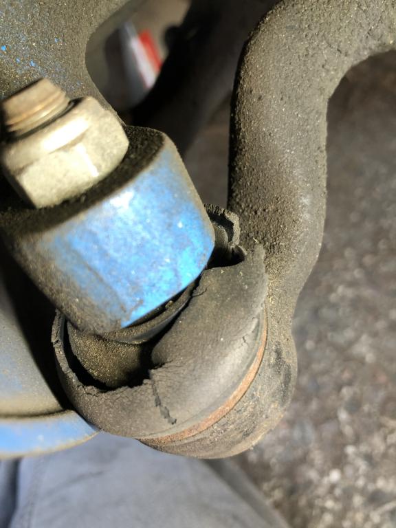

            Let's do some catching up since I may have told a little lie. I have done more than just maintenance. My first plan of attack was to refresh some suspension parts up front. I had been experiencing some rattling up front at low speed when going over bumps. Upon further investigation, here is what I found.

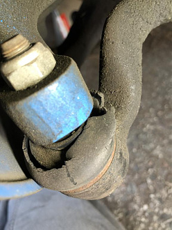

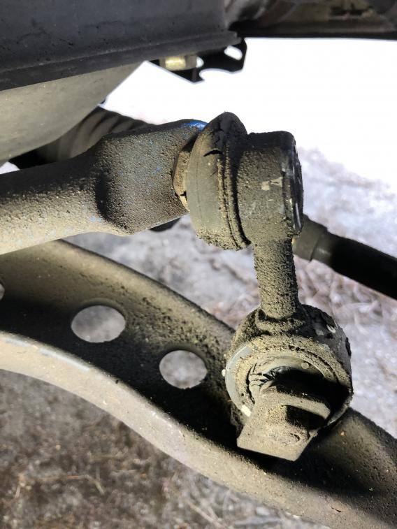

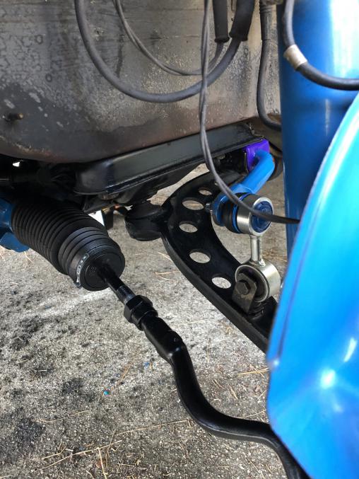

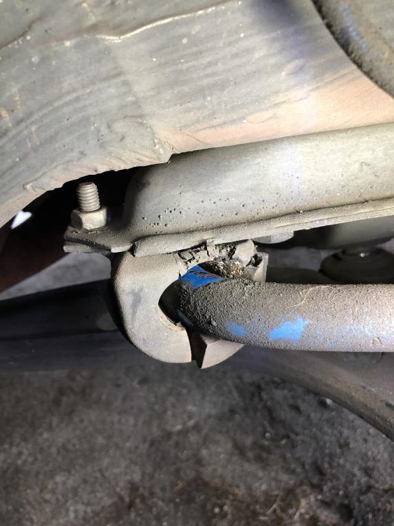

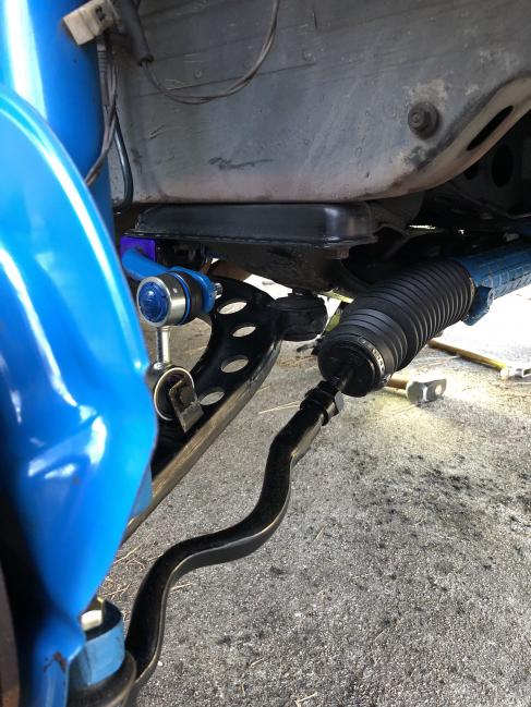

            The sway bar bushings, end links and the tie rods were shot. Did I mention this car has high miles? I ordered some Lemforder tie rods, meyle sway bar end links and powerflex sway bar bushings. If I recall correctly, the tie rods and end links came from FCP Euro and the powerflex bushings came from bimmerworld. I thought this was going to be an easy job (as it should have been), but the cold weather had other plans. Removing the tie rods gave me the most trouble. The inner tie rod has a locking washer that you are supposed to bend back out of the way so it can rotate. I bent it back, but the tie rod would not budge. I'm summarizing the event but it took around 4 hours of me trying it the nice way before I decided to go the "Hit it with fire" approach. A generous amount of heat from a torch and a quick bump from a pipe wrench later, the tie rods finally came off along with all the skin on my knuckles. Removing the sway bar end links and bushings was easy. after everything came off, I put the new shiny stuff on. Tie rods went on easy, there are plenty of how to-s on that along with the end links. I knew the sway bar bushings would be difficult from some research I did. Upon installing them, I did not have too much trouble. I was not able to take pictures of my technique since I only had two hands and no friends to stand around and watch. My method was this; put busing on sway bar, insert busing into the holder, place the notched part of the holder into it's place on the subframe, align the holes of the holder up to the holes on the subframe with a screwdriver, use vice-grips to pull the holder up to the subframe and hold it there, quickly remove screwdriver and start to thread the bolt, pick up the vice-grips that just fell on your face and start over . This method was actually pretty easy even though I probably butchered the description.
            I took some time to clean it up and it turned out nice, I think. It seems the previous owner liked blue and I don't mind it too much either. Once everything got torqued to spec, I did a quick string alignment on the car to make it derivable. All of this work led to a far significant increase in ride quality, sharpness and importantly no more rattling up there. The next few posts I have will be catching everyone up to speed on what else has been done so far.

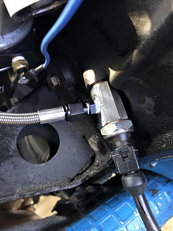

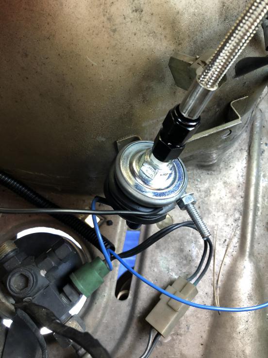

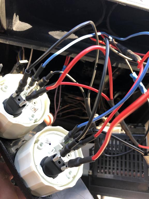

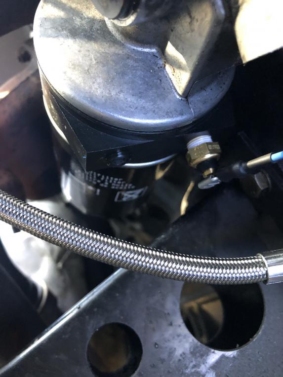

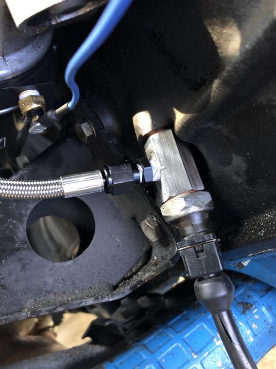

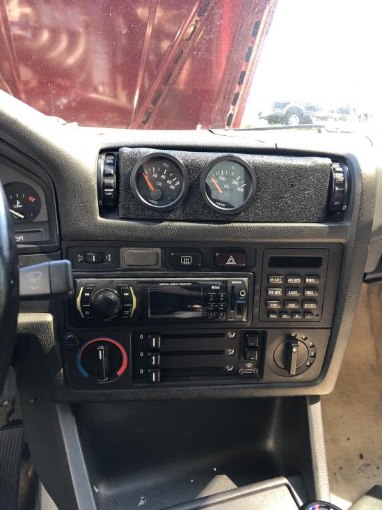

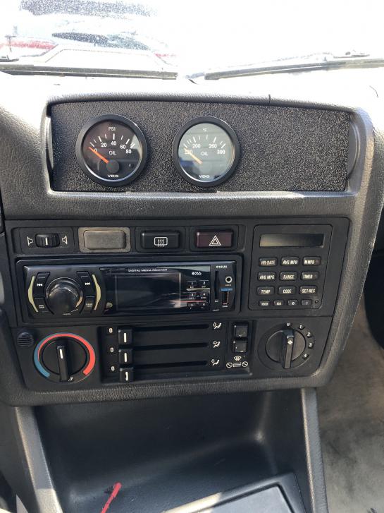

                    Oil Temp and Pressure Gauge Install:
                    This weekend's project was installing my VDO oil temp and pressure gauges. I kept the stock low pressure switch and got the single pole pressure sender. I read a lot about vibrations from the motor causing the pressure sender to fail so I decided to go the remote mounting route. To do this, I bought a T-fitting from Race German, a 2ft Braided SS hose and AN to NPT adapters from summit. To get temperature readings, I went with the oil filter sandwich plate from KAmotors and installed it directly into one of the ports. Installing these were fairly simple and straight forward. While I was in there, I put in a new oil cooler I scored at the local pull-a-part since mine was leaky. Now for the wiring. Getting power and ground to the gauges was simple. I tied into the 12v power going to the stereo and for ground I did the same thing. Next, signal wires were ran from the gauges to the appropriate senders. I routed them where the AC lines come through the car in the firewall since I had easy access from removing my non working AC. Once the signal wires were connected, I found a problem. I turned the key to on and my pressure gauge would max out with the motor not running. I checked all my wires, made sure correct voltage was going to the gauge etc. Still nothing. So I went to the internet. When remote mounting the pressure sender, you lose the grounding capabilities of being mounted to the motor, so you have to create a new ground for the sender. This was easily done by connecting one end of a wire to the actual body of the sender and the other end of the wire to a good ground source. I did this by sandwiching one end of the wire between the body of the sender and a rubber insulated clamp. The other end of this wire was then connected to the ground on the strut tower. This solved my problem. Now for the gauge mounts. I decided to integrate them into the existing A/C vents. So I hollowed out the vent housing and got some ABS plastic and went to work. Me never working with ABS led to me not being super pleased with my final result, but it works for now.
                    T-Fitting for stock low pressure switch and SS line for remote pressure sender. Above this you can see the signal wire for the oil temp running to the sandwich plate.
                    Oil temp sensor on port in sandwich plate
                    Oil temp sensor in port on sandwich plate
                    Remote Oil pressure sender. You can somewhat see where the ground (black wire) goes to the body of the sender. Location is behind passenger headlight.
                    Wiring madness
                    ABS mount didn't turn out well. I'll make another one.
                    A few steps closer to being track ready. Being able to see this data gives me some peace of mind with the car having so many miles. And the kid in me has always wanted some cool gauges. I'm a big fan of how the VDO gauges match the factory setup, but no thanks to me.

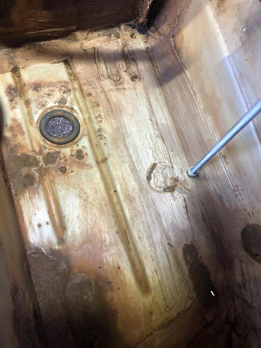

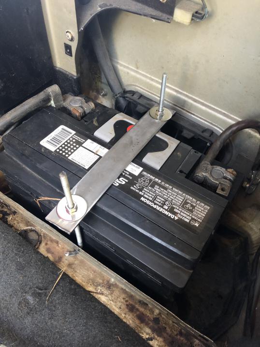

                      Battery Tie Down:
                      I had a hard time finding a good write up with visuals on how to make a good battery tie-down, which is required for tech. I was at a NASA-SE event recently and walk around and looked at what some drivers had to get some ideas. Here Is what I did. Materials were just threaded rod, nuts, washers and a piece of steel I had laying around. I ran the threaded rod through the bottom of the battery tray by drilling a hole and placing a nut and washer on the outside of the car, then another nut on the threaded rod in the car to hold it in place. I also found some rust, this can be dealt with at a later time.

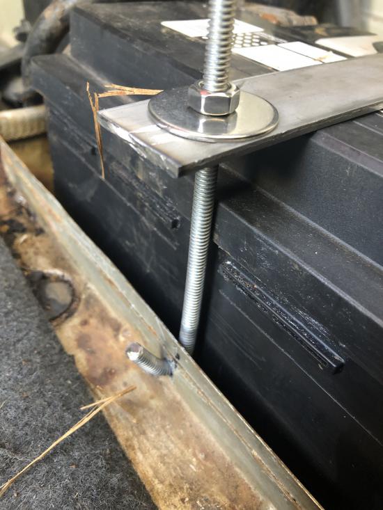

                      Next I drilled a hole on the outer lip where the trunk area opens up to the battery tray. Then I used a torch to bend the threaded rod into a J so it self anchored to the drilled hole.
                      Last step was to measure and drill holes in the steel and bolt into place.
                      Gave it the ol' "That ain't going nowhere" and called it a success.

                        I would consider a bright oil pressure light at 20psi, You'll see that before your gauge tanks.
                        Good to see progress!

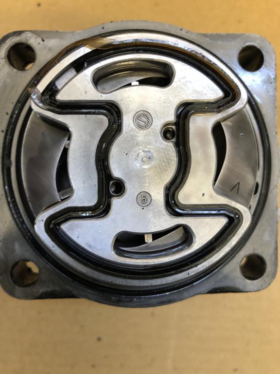

                          The next item was my leaky/non working power steering pump. This has been an ongoing issue that I just haven't addressed until now. I got a BMW rebuild kit from either bimmerworld or FCP, I can't remember. The process was pretty simple. Drain the system, remove pump, rebuild etc. The fluid still had good color to it and the inside of the pump was nice and clean with little marring on the inside. My problem was immediately found when I separated the two housing pieces from each other.
                          I think it's safe to say that this gasket is original and no longer performing its job. I put all the new gaskets in and bolted it all back up. No more leaks or noises and I can actually turn the wheel with ease.

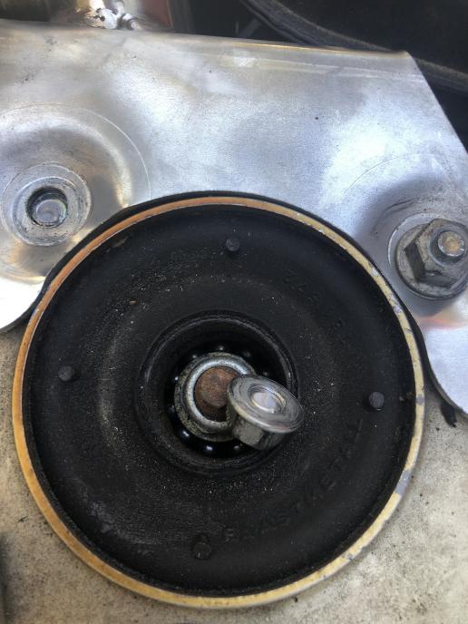

                          All was going well until putting the strut bar back on, I broke a bolt on the strut mount.
                          This is an unfortunate setback but it probably needed to be replaced anyways. So new ones are on the way and the first thing up on the to-do list!
                          • ForcedFirebird
                            • Feb 2007
                            • 8300
                            Those studs are just knurled and pressed in. Take a punch and a hammer and knock the rest of the stud out and replace it with nut/bolt for the time being.

                              I'm in no hurry to get it fixed. And the bearings don't look that great on the inside, so that pushed me to go ahead and order new ones. The track day I was signed up for on April 4th and 5th was just cancelled which gives me time to get it right.
