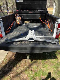

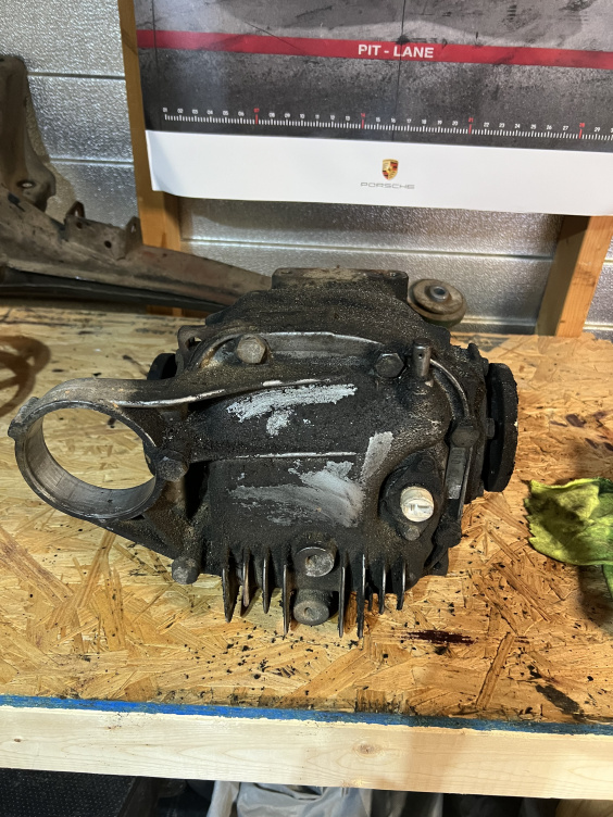

                      #55

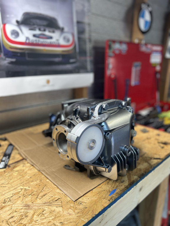

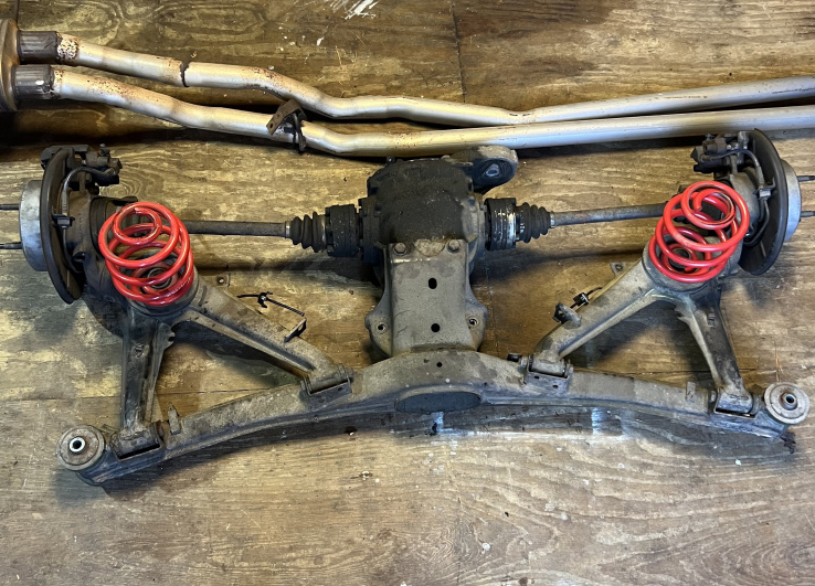

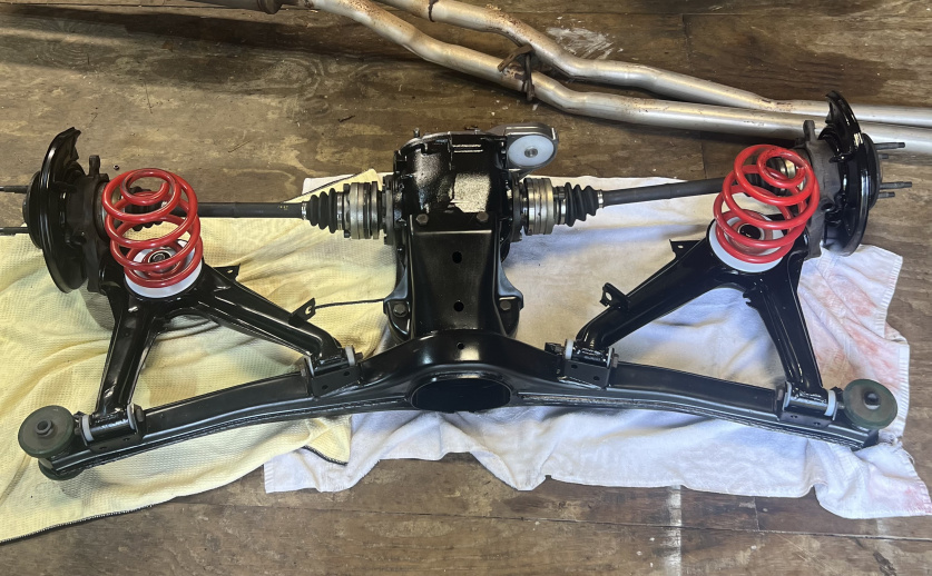

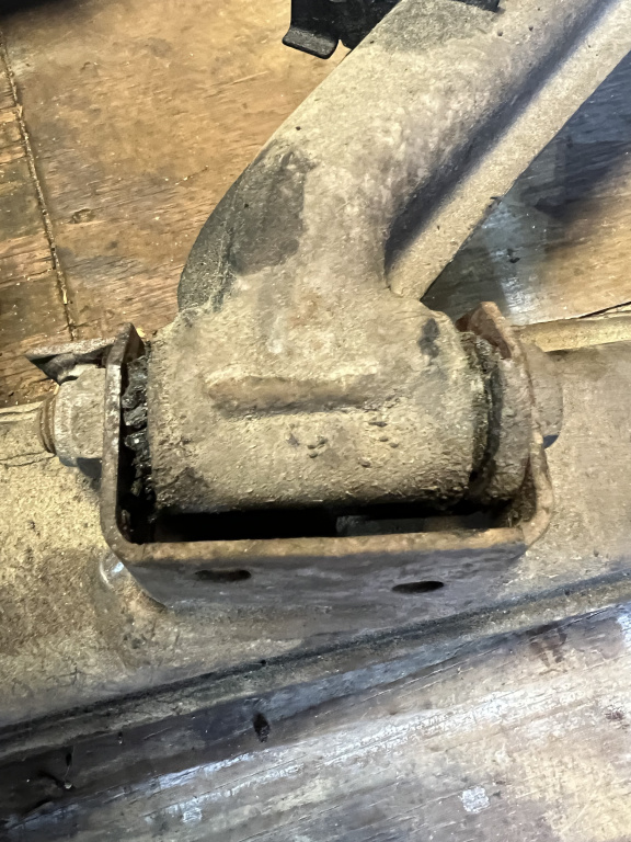

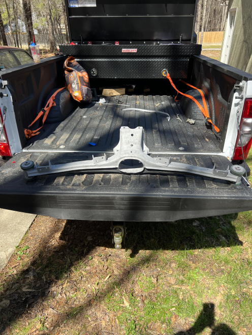

                      My RTAB's reached the end of their hard life so I decided, what better time to replace them and do a whole bunch of unnecessary work at the same time. Somehow I came to the conclusion that removing the subframe and diff all at the same time would be my easiest option, so that's what I did. Subframe came out ok, I had to unbolt the diff from the subframe while leaving the axels attached to clear the driveshaft along with some finesse.

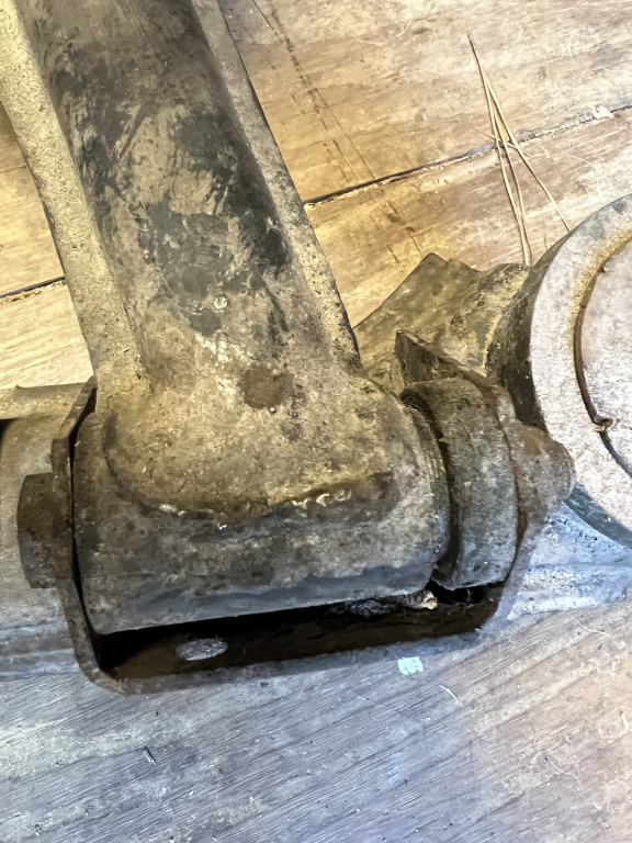

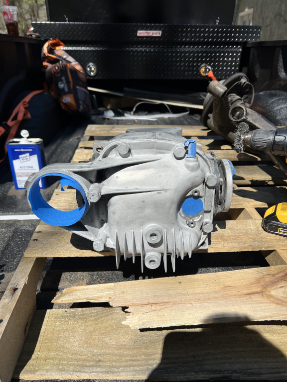

                      Took the trailing arms off of the subframe, removed the old bushings and then prepped everything for paint.

                        Some before and after:
ID:	10096920Click image for larger version
ID:	10096922Click image for larger version
                        I'm really pleased with how all of this turned out. I do have a lesson learned. I read somewhere that with aftermarket bushings you can torque the trailing arms before you put them in the car. This did not work for me. I torqued them on the ground, installed everything on the car and noticed the car now sat about 2" higher in the rear. WTH. I even added some condor spring pads in replacement of the factory rubber ones to lower the car. So, what I learned was that torquing the bolts on the ground set the preload on the suspension. The next step was to loosen the trailing arm bolts, get the weight of the car on the suspension and re-torque the bolts. Problem solved but torquing the trailing arm bolts while they are in the car is a real PITA. Took the car to Road Atlanta last Friday and all is good!
