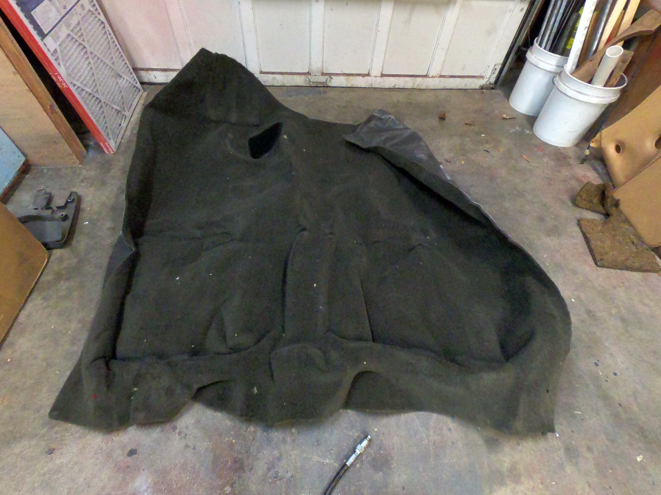

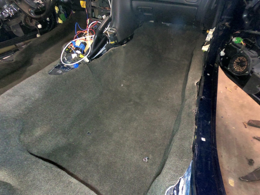

New carpet. With heat, I was able to "peel" the top carpet off the form molded cushioning and re-use it under the aftermarket carpet. Worked pretty well.

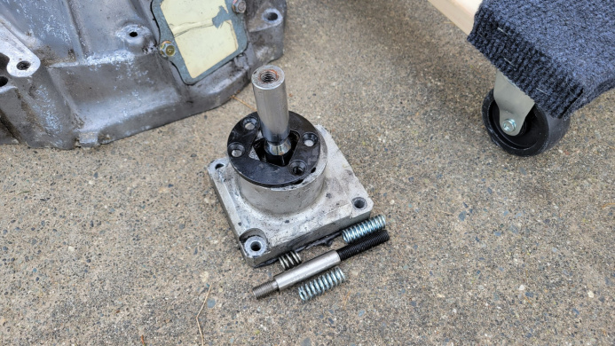

I created a home for the BMS screen, shifter, and master power switch. It lives where the old shifter sat. I sacrificed the automatic shifter pieces to make it work.
In case I (or the next owner) ever want to make this car a 5-speed, I bought all the parts - trans, shifter, driveshaft, clutch, and 3-pedal setup.

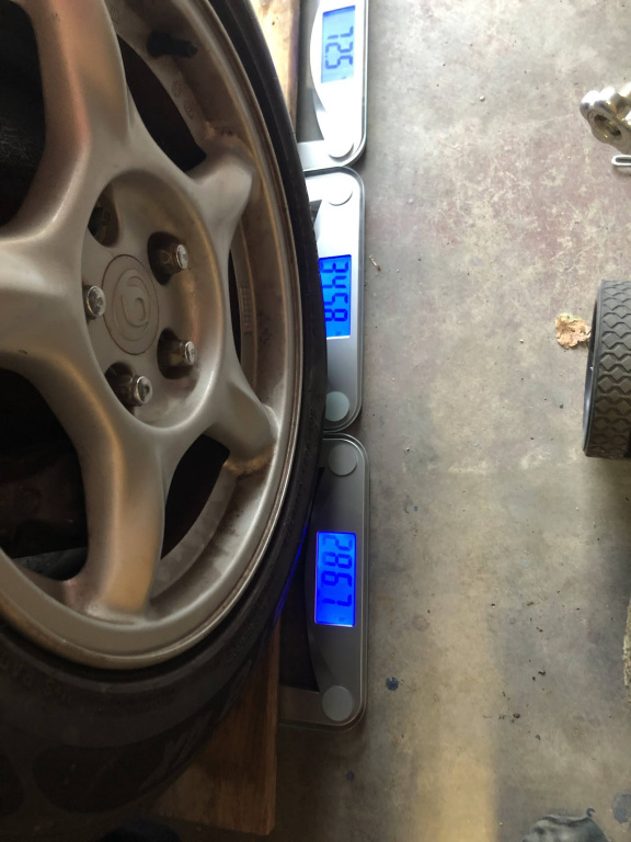

Once the car was all together and running. The big question... is it heavy? Nope, in fact it lost weight.
