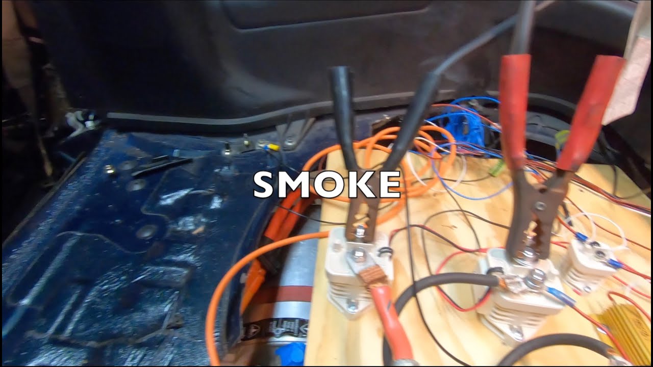

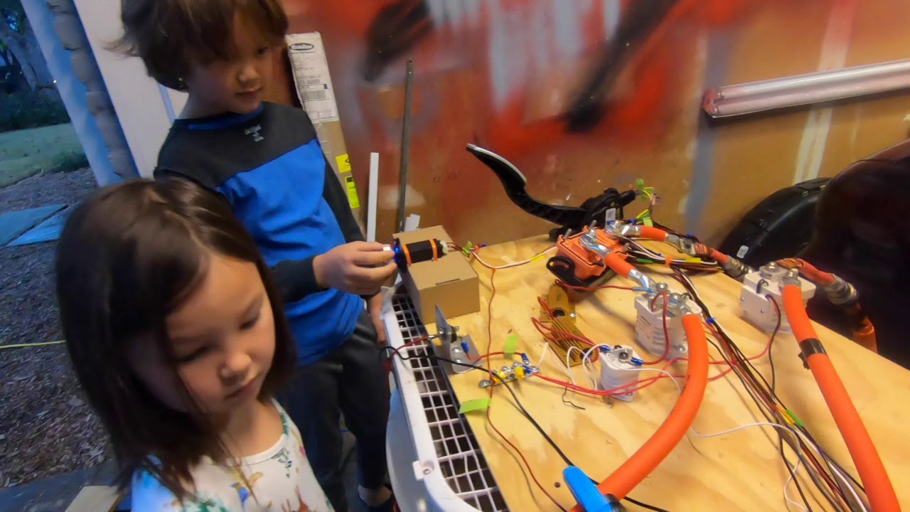

              K....we are now getting the tesla drive unit to move but we are running into issues. Just posted this in the support forum so hopefully someone has a though about what's going on.
              Here is the video of it running....and smoke coming from HV wires....

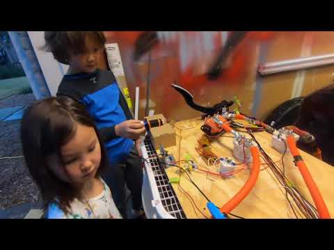

                #67
                Success! Johannes from Openinverter.org did a support session with me this morning and quickly diagnosed the issue. The root cause was that my board wasn't getting any signal from the encoder at all. This was a quick fix because I was suspicious that I didn't have the pins fully engaged. It's possible that because there wasn't a signal coming from the encoder, the motor kept pulling more current to spin which overheated my under-spec'd wires.
                We ran the test with 60v (5 x car batteries) and 2/00 wiring on the HV side. Everything is now working great.
                In hindsight, if I had to do it all over again I would pay for a few hours with Johannes to be there for the first test runs. Really great resource to have. Thanks Johannes!
                Here is the obligatory video...

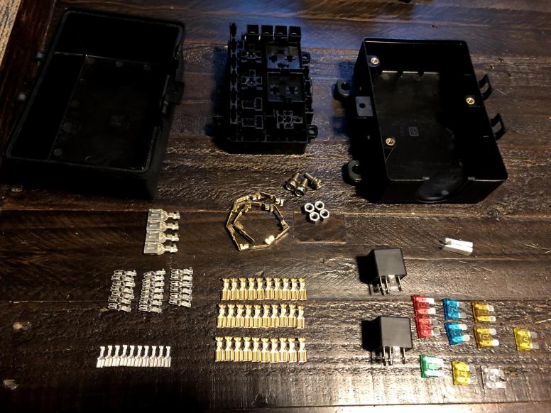

                  I spoke to ElectricGT and my batteries are 5-6 weeks out which gives me time to sort out all the other parts - charger, brake pump, coolant pump, fuses/relays, etc.
                  I bought this fuse/relay box on Amazon for $40 and I'm pretty happy with it. People in the reviews complained that it is nothing more than a box of parts and no instructions and they are right, but it's all pretty straightforward: https://www.amazon.com/gp/product/B0...?ie=UTF8&psc=1
                  Click image for larger version  Name:	Fuse and relay box.jpg Views:	0 Size:	86.7 KB ID:	9971073

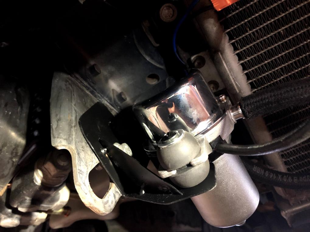

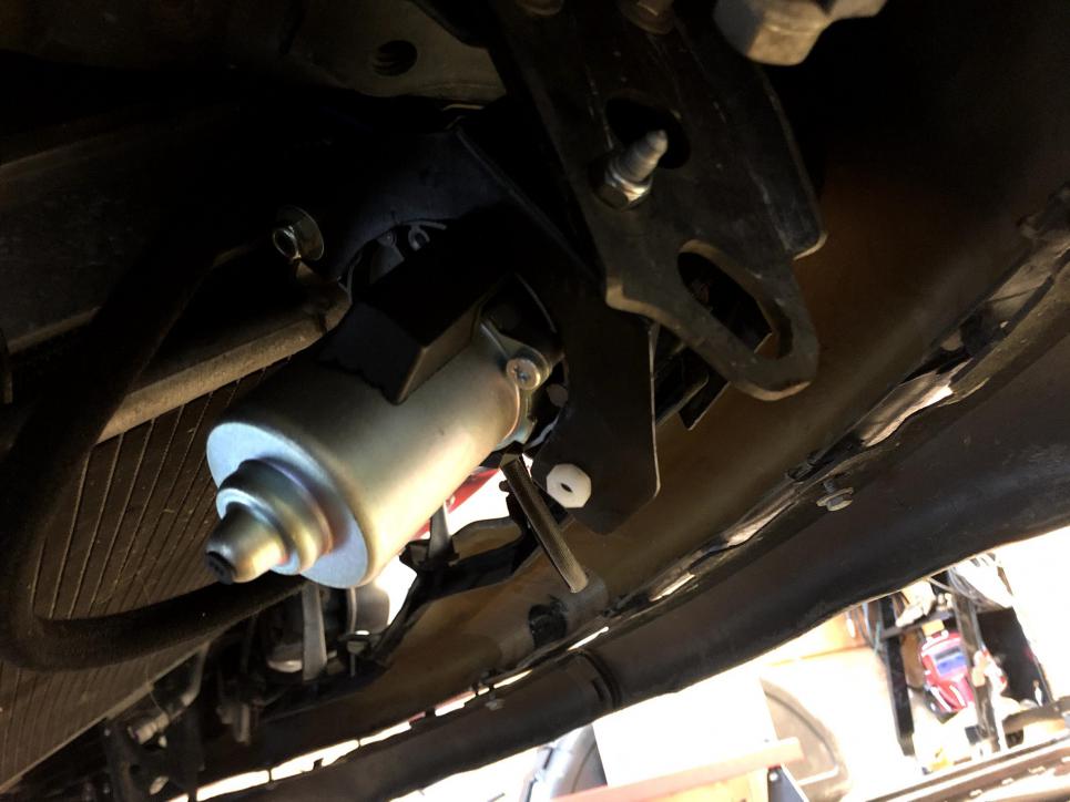

                    A couple updates. These feel like trivial things in the whole project but figuring out where and how to mount everything is taking time. I have the fuse/relay box wired in and working for testing but not mounted yet.
                    1. Brake Vacuum Pump - I mounted the vacuum pump in front of the radiator in hopes that having the radiator full of water between myself and the pump will dampen the noise. I put together a bracket by cutting thin steel and welding it. The hardware is temporary for now.
