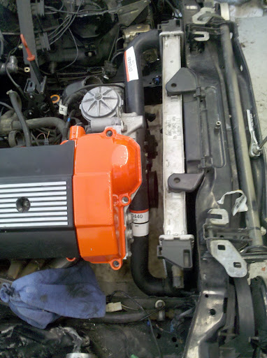

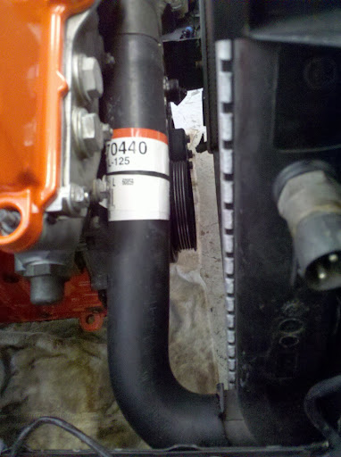

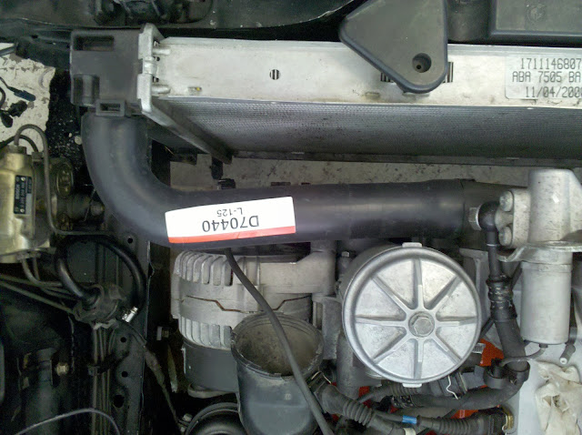

Got my hoses figured out. e34 hoses didnt work like people said, so I just went to the parts house and started lookin. Found these. They fit like a glove after some trimmin.
Left the part number on the hose for all you suckers. Dayco hose. $9.99 both upper and lower hoses are the exact same hose cut up just a lil different for bottom and top.

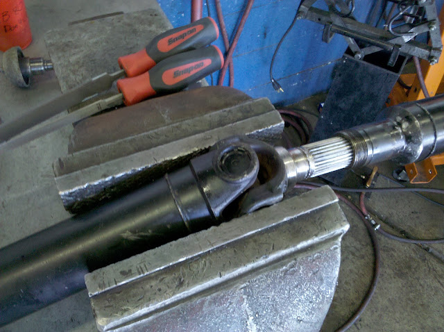

I am currently waiting on my driveshaft being balanced, and a lot of parts to come in from TRM then I can get this thing buttoned up!
