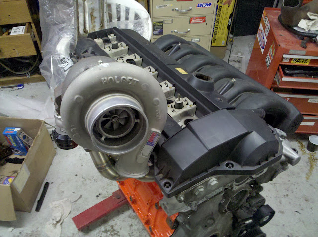

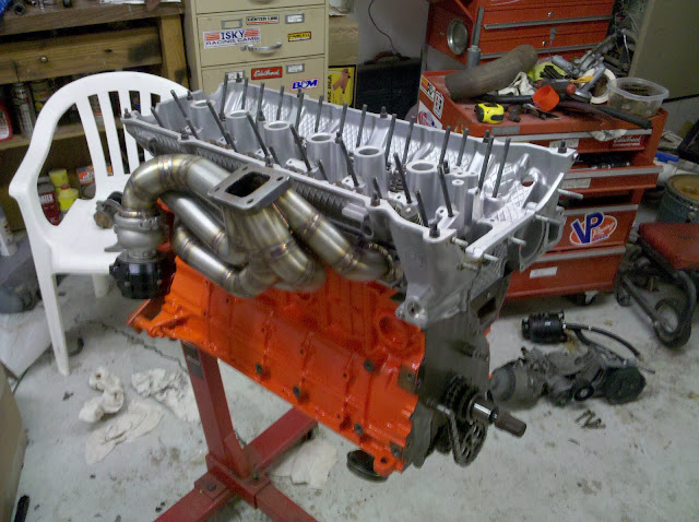

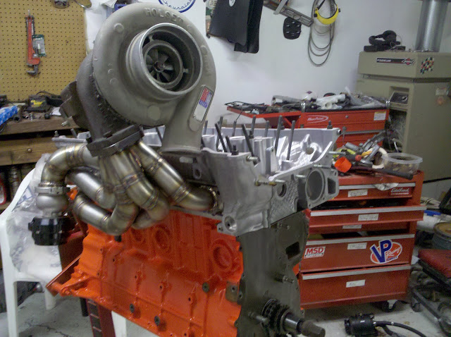

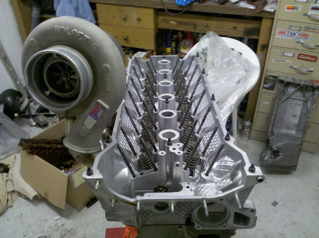

Wow, nice response time haha. S52 cams and an obd1 intake for now. :)Turbo e30 M52. Built Motor, GT3582r
Watch my vids http://www.youtube.com/user/GrudgeRider156?feature=mhum

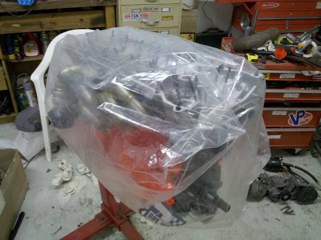

Haha it only looks big...Turbo e30 M52. Built Motor, GT3582r

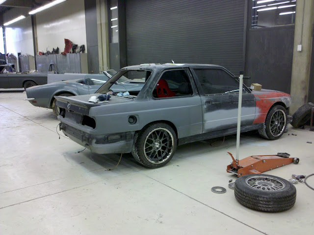

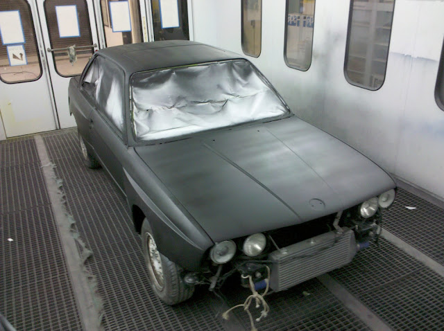

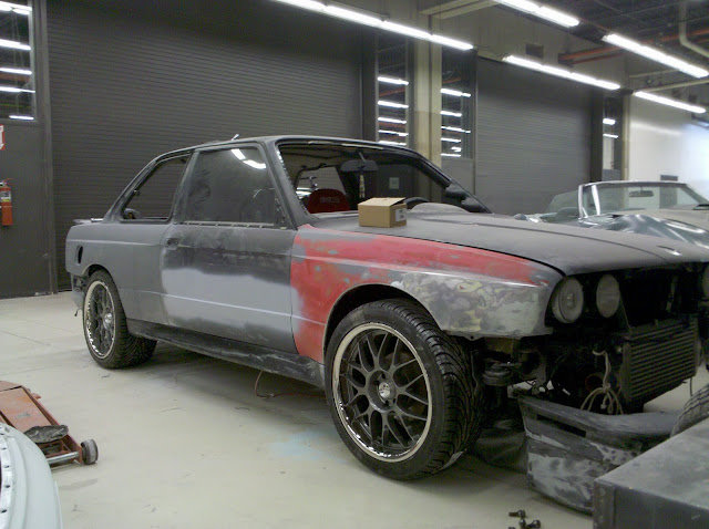

The car is getting very close to primer. I am trying not to be a perfectionist, but If its going black it needs to be straight.
I mounted the passenger sideskirt today and found out that I will probably run a smaller tire up front with less spacer.
Next step is getting the supplies I need to mount the bumpers and prime it and start blocking.
The goal is to have it painted before my wedding, then I can drop the motor in and get it running in april.
Then maybe... Just maybe.... B FEST!!!!

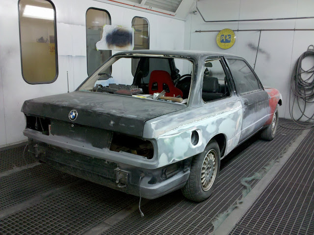

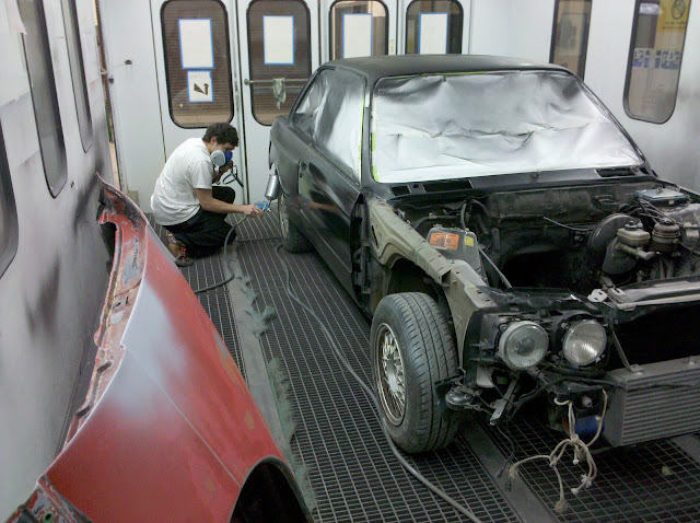

PRIME TIME

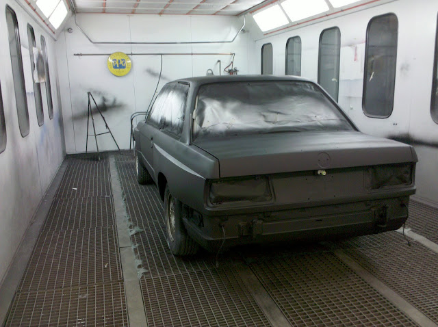

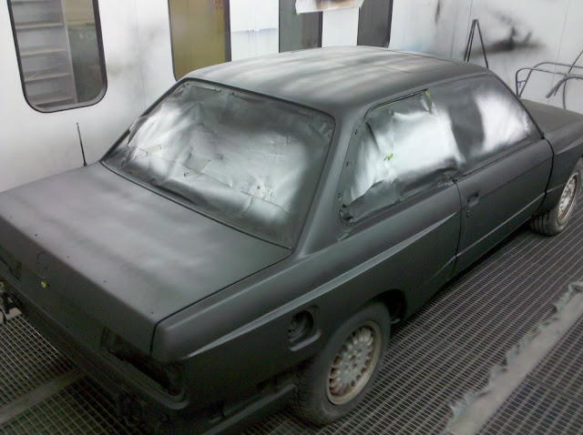

So yea. Today was a good day! I got the car primed(minus skirts and bumpers). Its spring break this week so were out of school the rest of the week and I wont be able to work on it. :( But now we block it out and find the spots I need to finalize.

Not bad at all. Did you spray the primer? Whoever did should take a bit of note by the lines that they are a bit heavy and overlap didn't quite happen. Be a tad further away and over lap a bit more. I'd say, just from the streaks about 4" back and smooth out "wet edges" on panels by over lapping a TINY bit more. Just enough not to get runs.
Unless of course this was still drying up a bit. Good work as always!Need a part? PM me.
Yea, the car was still drying. Plus its a build primer and I didn't need much on the oe panel's. Yes I sprayed it, and I let two buddies have a shot as well. :-)Turbo e30 M52. Built Motor, GT3582r
Originally posted by turbo325i View PostYea, the car was still drying. Plus its a build primer and I didn't need much on the oe panel's. Yes I sprayed it, and I let two buddies have a shot as well. :-)
OHH, God. Sorry! I'm dense. You've still got to block it... yeah, looks perfect then. Not sure how I didn't process that little bit. You of course know the rule for blocking? (I'm sure you do...) Block it. Fill. Block it again. Fill. When you're at the point where you think you're done, block it twice more.
ALWAYS pays off. I short cutted the blocking on my project/parts car and the area's I paid more attention to and blocked turned out without a doubt better looking.Need a part? PM me.
