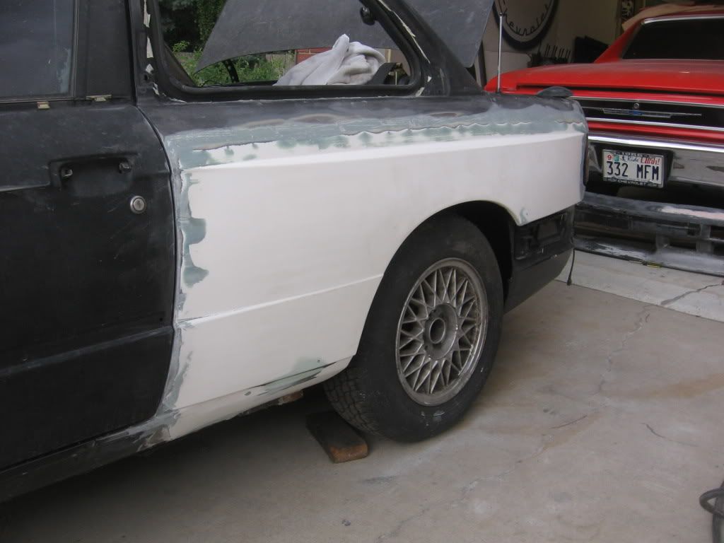

            Ok. I havent updated this thread lately but I am making decent progress condsidering my many other obligations. The m52 is machined and waiting for parts to be re assembled.

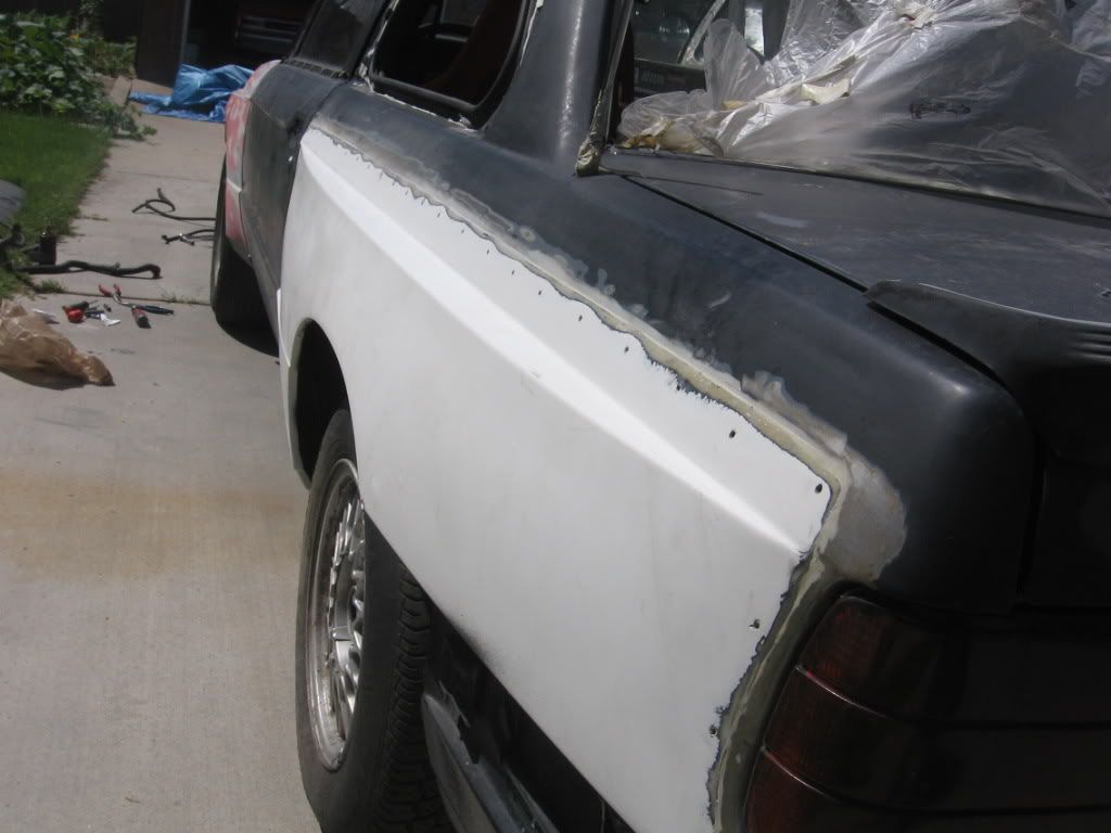

            The drivers side body work is nearing completion and getting ready to start on the passenger side.
            The drivers quarter is bonded on and using short hair fiberglass to smooth the lines.

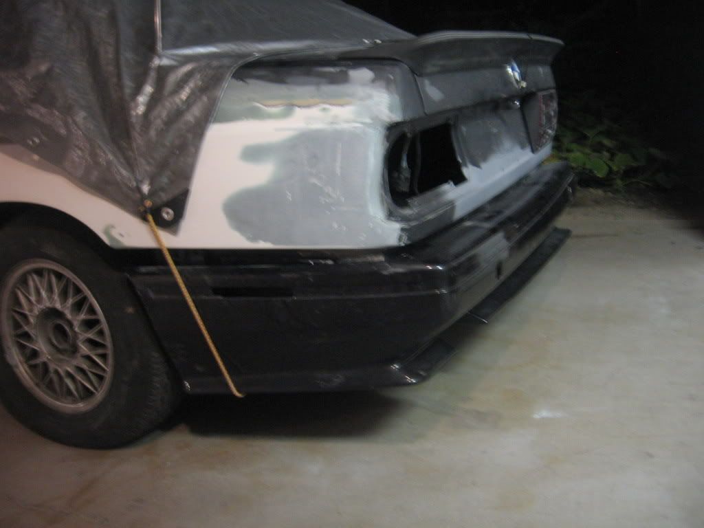

            Finally recieved my oem m3 rear bumper from e30damen... Thanks to all who helped me get the bumper! It was a group effort by the r3v community.
            Just bonded on with no body work done yet
            Here you can see the green short hair fiberglass bondo being used
            To give you an idea of what it will end up looking like...

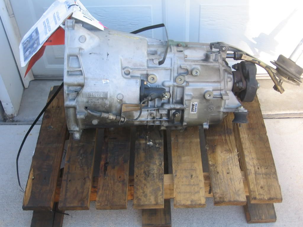

            Decided to go with a zf trans due to ease of install and low mile and build design of the zf
            43k m3 tranny

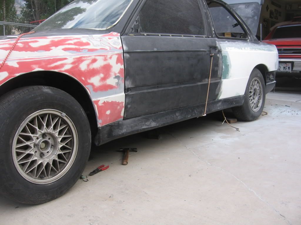

            Getting the skirts in mock position to see what is needed to mount them. They are an excellent made piece but proving to be more dificult to mount than I had thought.

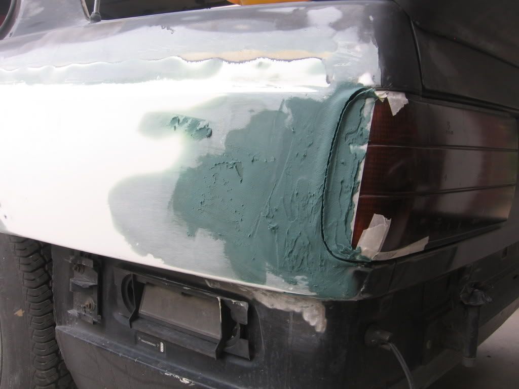

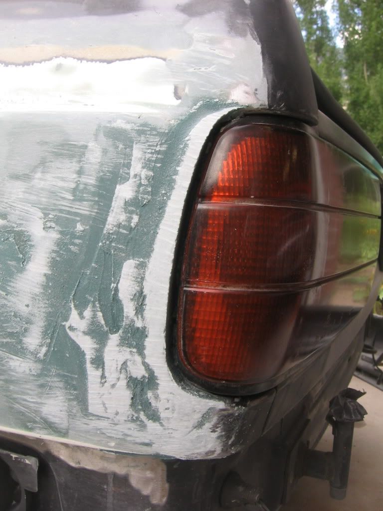

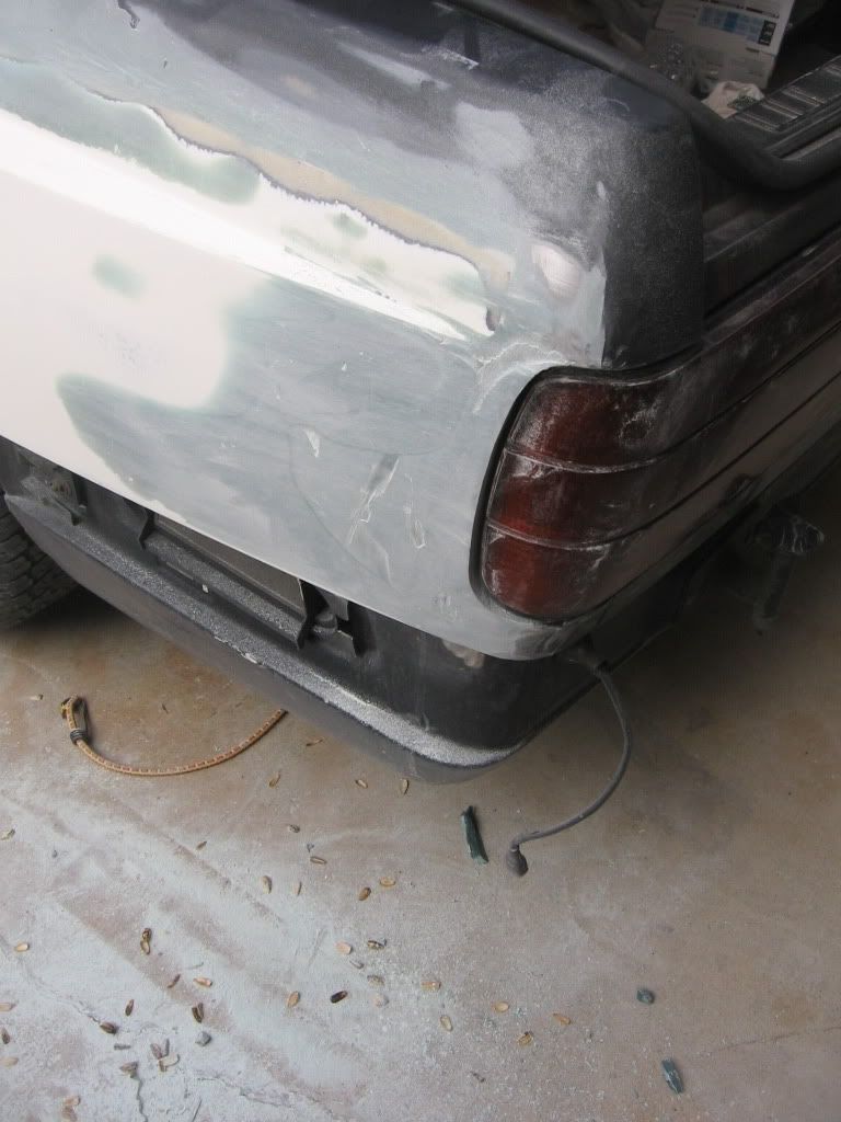

            Had a dent right near the rear light so I had to do some work to make it right again. This is a trick I learned to get your body lines dead perfect with the exact gap.
            rogh it out
            and finish it off.

                          Ok, here is an update for you my friends. Bodywork is a BITCH!!! Seriously though, it is immensely time consuming ESPECIALLY if you want to do a half decent job like I am trying to do... I would spend longer and try to do a show car job... but I just want this thing on the road...
                          Having said that, I am having a blast doing the bodywork. It is very pleasureful to see this project take shape. Even though by my pictures it does not look like a lot of progress is being made. It is.
                          I have filled in the door guard moulding recess to mirror the m3 doors body lines, I have shaped the rear quarter to fit the tail light and have gotten the panels pretty close to ready for primer. The side skirt is now permanently mounted (although I need to sort out the ripple issue as the glass is so thin... )
                          Things are coming along nicely. I am hoping to have it painted by the semesters end. I will keep updating this as things unfold, although small things on my end are great progress, they might not appear that way on yours. this is expected. :D

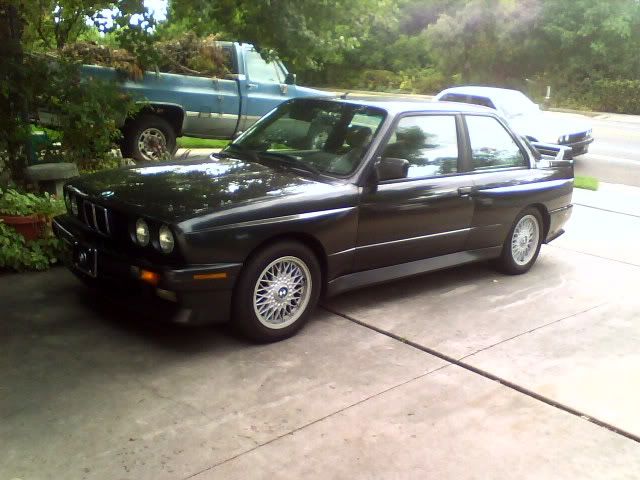

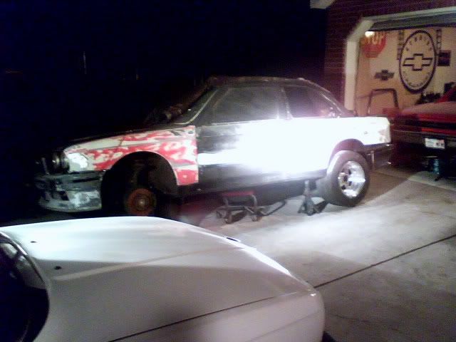

                          Worst pic ever... I know. But I do all of my work on tuesday, and thursday at night because I get off work at 6.

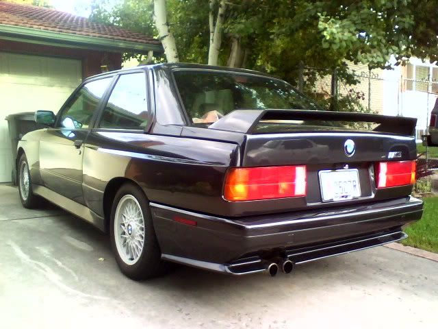

                          On the flip side, I have a friend with an e30 m3 that allows me to go look at it anytime I want to check my body lines and help keep me on course. :D

                              big fan of sunflower seeds are ya. Awesome build progress so far. Actually at first I didn't read your last post, saw the m3 and thought you were done. Its nice that you have a finished image though, keeps things in perspective.

                                Yea I love sunflower seeds! Chew 'em all the time when working on cars and driving and... well everywhere! Yea it is very nice to have the real m3 to look at whenever I am concerned with something
